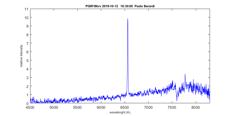

Nova Cyg 2019 = PGIR 19brv = AT2019qwf
Spectrum obtained by Paolo Berardi
at mag V ~ 16.7 !
(following an error: I took the I mag as V mag in AAVSO discussion - Sorry!)
http://www.astrosurf.com/aras/Aras_Data ... yg2019.htm
The spectrum is pretty good for such a faint target. Congratulations, Paolo!

Thank you François, yesterday I observed again the nova under better weather conditions and a slight more brightness (nova at V 15.98 from concurrent photometry) compared to october 12.

Very nice work, Paolo !
