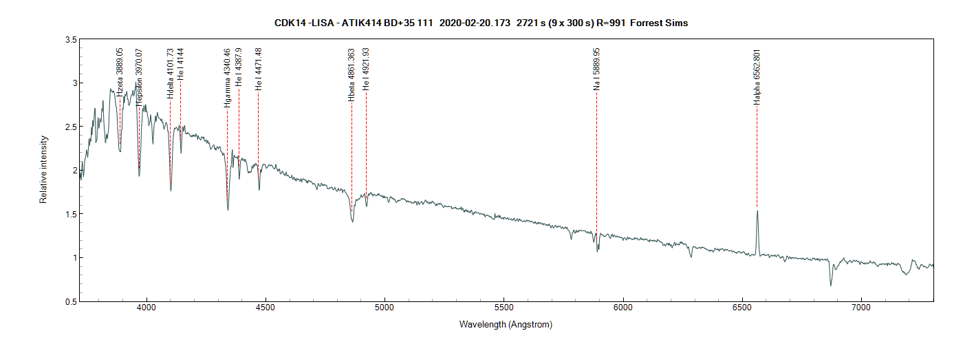

I bit on this one. Here is a spectrum taken last night with my LISA. (9) 300 sec exposures. The Balmer lines are clear with Alpha in emission as you described. The Na lines are clearly visible as well as numerous lines that I think are HeI. I will upload the spectrum to the BAA database as soon as I can figure out how it should be categorized.

Re: Emission-line Star BD+35 111 brightens
Nice interesting spectrum. I have now found this reference (not in the references listed in SIMBAD)
https://ui.adsabs.harvard.edu/abs/2014A ... S/abstract
where it is classed as an irregular variable with spectral type B2Ve (ie could be a classical Be star) with significant extinction E(B-V) ~ 0.5 which I say would fit the description of your spectrum.
I guess you could add it to the BAA database as either a Be star candidate or under the catch all "variable of unknown type" Your call

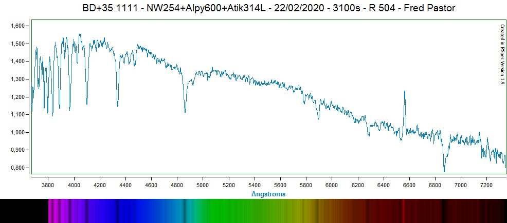

Here is my humble contribution.
Couldn't obtain a better resolution, when I compare with the nice spectra of Forrest. And the catch was a bit more complicated than thought (in the middle of M38, with similar Magnitude star around BD+35 1111)
That said, we may find hopefully the Balmer lines + Na lines. And the clear Ha emission.
Many thanks for your article Robin.
Fred

- BD+35 1111 taken last 22nd Feb 2020
- BD+35 1111.jpg (72.6 KiB) Viewed 19895 times
