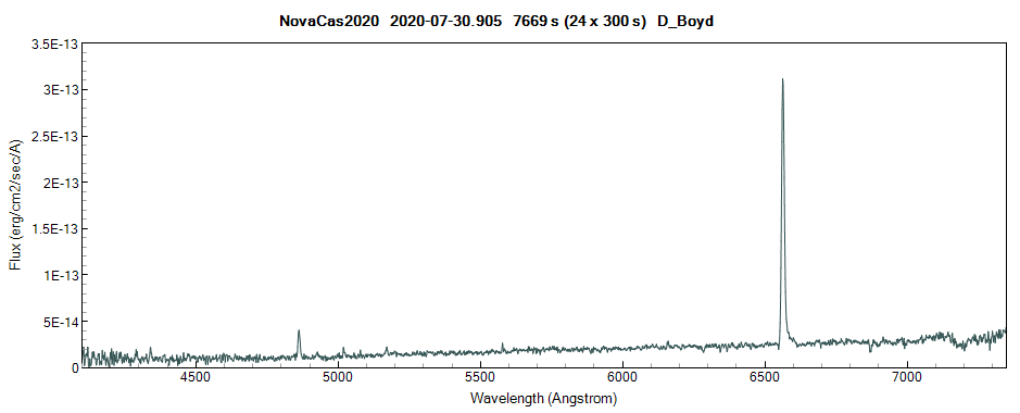

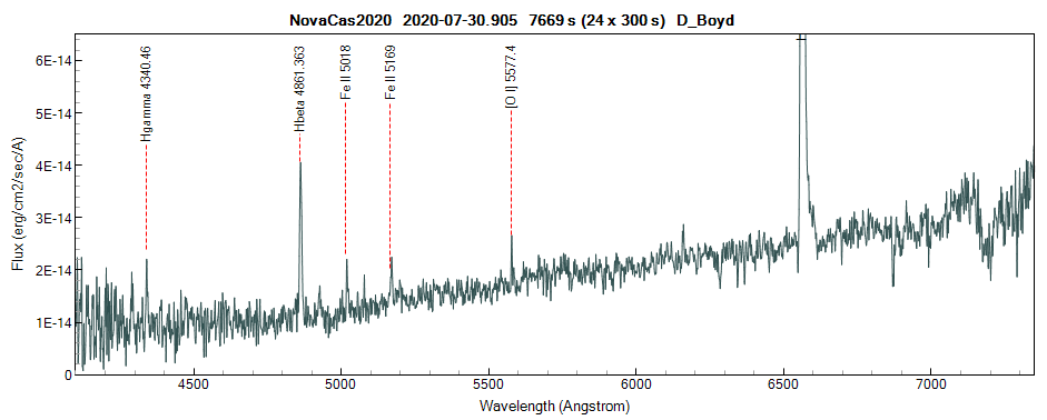

A spectrum of Nova Cas 2020 recorded with a LISA spectrograph on a C11 SCT and calibrated in absolute flux using a concurrently measured magnitude of V = 13.395. Using PlotSpectra, the integrated absolute flux of the H-alpha and H-beta lines are 3.53E-12 and 2.52E-13 erg/cm2/sec respectively. These results are consistent with the values 3.54E-12 and 2.54E-13 reported in ATel 13905. The apparent FWHM of the H-alpha line is 508 km/s and there is evidence of weak P Cyg absorption on the blue side of H-alpha extending to -800 km/s relative to the peak of emission. There are also emission lines of Fe II 5018, Fe II 5169, [O I] 5577 and an unidentified emission line at ~6160 A.
Posts: 1432
Hi David, excellent and fine lines identification.
I have updated my echelle spectal profil by adding more exposures (now 7x1200 s + some cloud - see my first message). The "P-Cyg" is well visible (but clearly blue shifted).
Also the, 5577A line is intense (more in my high resolution spectrum because the very small Equivalent Width of the line and the convolution effect of low resolution). I detect (faintly) also Fe II lines at 5018 and 5169 :
