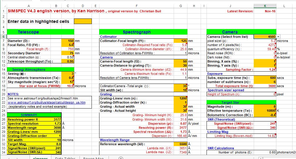

Sebastien,
The original design was without an entrance slit. I'm sure it will work well.
The resolution will be limited by the size of the star image at the telescope focus. SimSpec for a 3 arcsec seeing on your scope gives a FWHM size of 11 micron and an estimated R= 3100

Merci Ken pour la feuille de calculs et les compléments.
