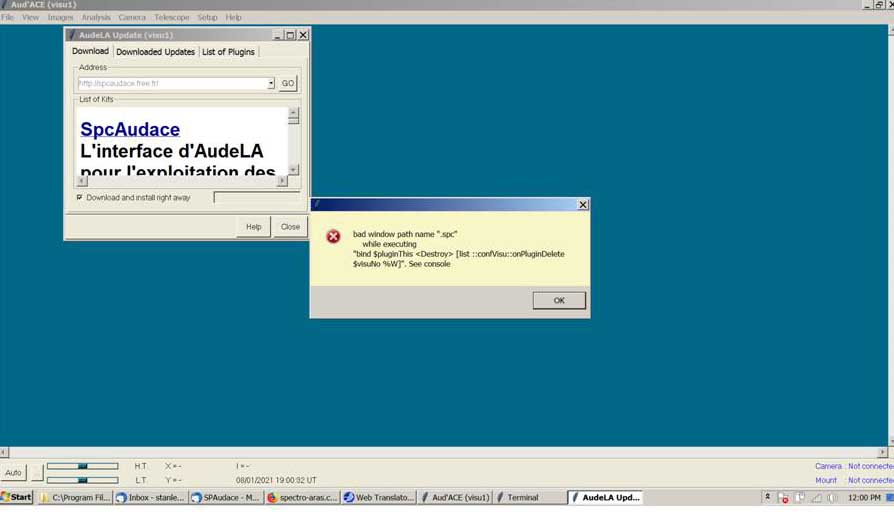

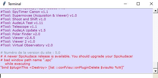

Running as Administrator did not work for me. Here is the error message I got and the Console message I got:
The problem seems to be a 'bad window path name.' My operating system is Windows 7 Professional 64-bit. Could this be the cause of not being able to update?

No one responded and so I assume it was because I was viewed as being a little dense or computer illiterate. There is some truth to that. Sometimes things do not go as slick as they sometimes do. Anyway, it turned out to be a faulty memory. For the past two days I have been cleaning up my two computers of files and folders and organizing things. I guess this is what got me into the right frame of mind. After getting done with working on my computers I needed to reinstall Audela on one of them. Before I could not update to version 5.0 of SpcAudace. As stated in my last message, I was getting a file read error. This time I ignored it and clicked on updating to ver 5.0, and then clicked on downloading the kit. It all seemed very natural and it occurred to me that I had done this years (and years?) ago. It worked with no problem this time.
I then went to the first computer where I couldn't install the update. I went through the same procedure again but this time it bombed out and it erased the SPCAudace choice in the Analyze menu. I uninstalled Audela, reinstalled it again, and this time it worked.
