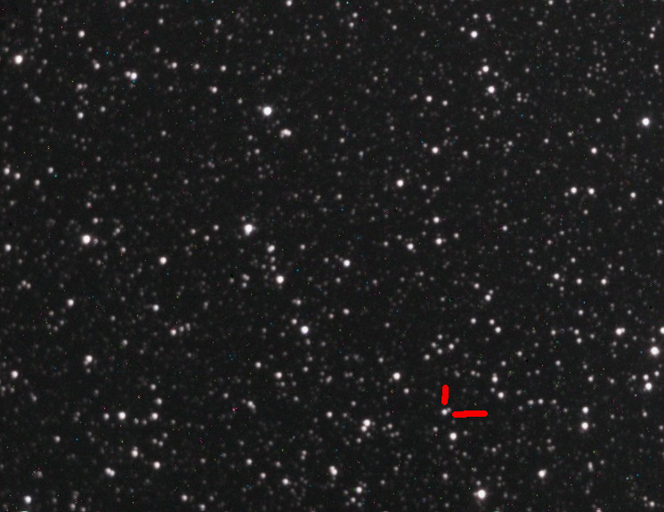

Possible galactic microlensing event for southern observers.
Bernard heathcote, terry bohlsen and other southerners, I would email you directly but don't have your address.
https://wis-tns.weizmann.ac.il/object/2020tyr
So far I got a rather poor slitless spectrum with star analyser 4x1200 s on a 200mm f6 newtonian, contaminated by zero order images at longer end ( Dropbox link with raw files here)
https://www.dropbox.com/sh/cfkllbs112xf ... eBdia?dl=0
Clear again today after lots of rain so tom love and I will both be attempting observations with sa100 and alpy 600 respectively.

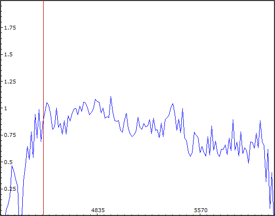

Here is my results from three nights (5th, 13th and 15th october). Total of 200minutes exposure with SA100 on 200mm f6 newtonian. S/N is pretty poor but better than nothing I guess. Should i upload to BESS?

It looks roughly like an F/G star from the continuum shape so not your typical CV or variable red giant. It could be a lensing event (The test for lensing is no change in the spectrum with brightness)
BeSS is only for Be stars. You could add it to the BAA database which accepts spectra of any astronomical object. Star Analyser spectra are accepted if they are of a unique event.

Posted: Sun Oct 18, 2020 6:22 am
by Terry Bohlsen
sorry I'm slow getting this too you.
My spectra was taken with my LISA.
It is pretty noisy as it was low in the west when I took it.
The continuum is pretty flat. There is certainly Hb and Hg absorption and weak Ha absorption maybe buried in the noise.
Certainly there are no major emission lines anywhere.
