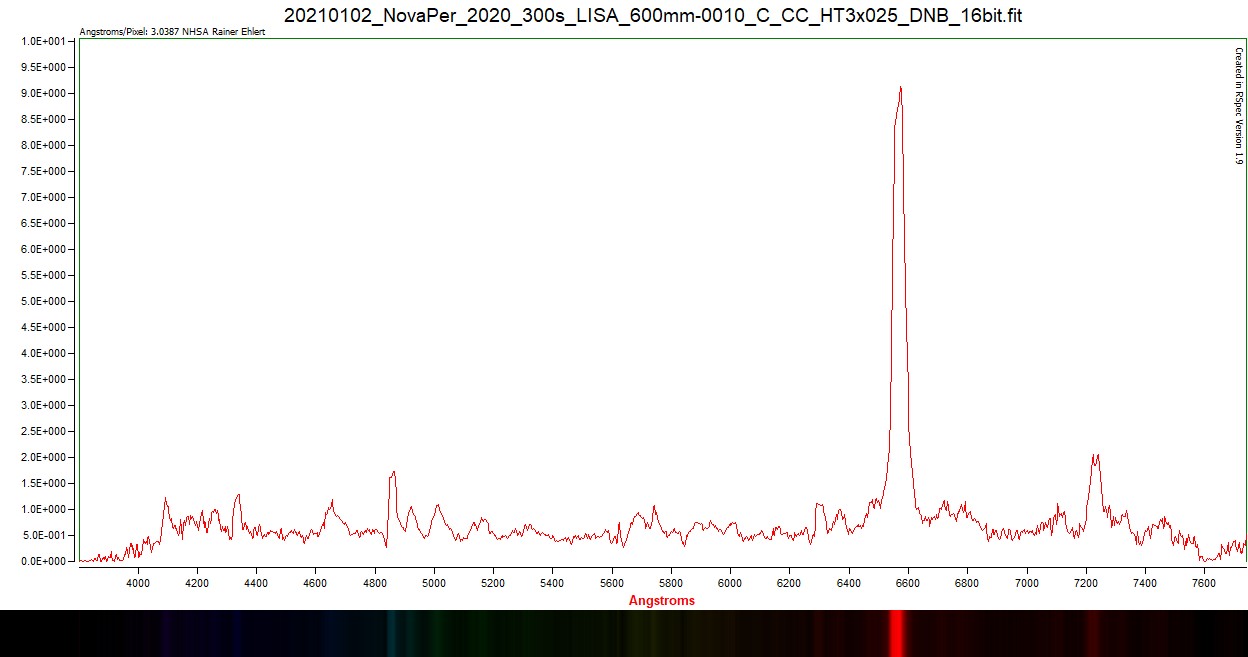

I have been making some spectra of Nova Per 2020 and the result of yesterday gave me a split line around 7230 Ångström. Is that correct or is there a failure in my RAW fit image ?
Thanks for any comment
I wish you al a better Year 2021 the the one we had ;)
regards Rainer
Re: First trial on Nova Per 2020
Posted: Mon Jan 04, 2021 6:27 pm
by Rainer Ehlert
Yesterday I made another image from NovaOer 2020 and compared to the one of December 2. The lines at about 7230 sre still split so I guess it is not my RAW images but a feature of the Fe lines there ?
Red is January 3rd and blue is January 2nd.
Both profiles were made fom 10 images each with 300 seconds.
Rainer
