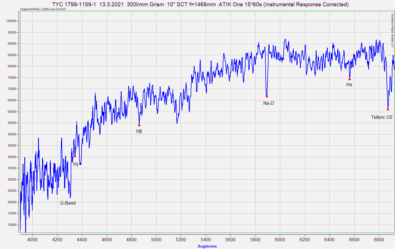

Dear Forum members,
just now I received a spectrum from German amateur Uwe Zurmuehl, taken last night under difficult conditions. It looks like a normal K spectrum, with Na D, G band, H-alpha, -beta, -gamma in absorption, and no emission apparent. Uwe Zurmuehl commented that the run of the continuum (calibrated via a neighbouring A0 star) is consistent with an unreddened K2III star.
This quick and pleasant reaction has two consequences:
1) It takes the urgency out of my request. It answers my main question on the star perfectly and conclusively. Any even better spectrum would of course do no harm
  , and a spectrum taken during the next eclipse minimum would be a gem. That minimum will be the last one to (possibly) be reachable before the seasonal break. It will occur on April 10, around 20:30 UT. It will not be observable from far northern latitudes, and generally from a fairly restricted range of longitudes only - if at all.
2) The astrophysical conundrum posed by the HRD location of the star and the characteristics of the eclipse lightcurves is confirmed, and kind of deepened even.
Kind regards, Uli Bastian

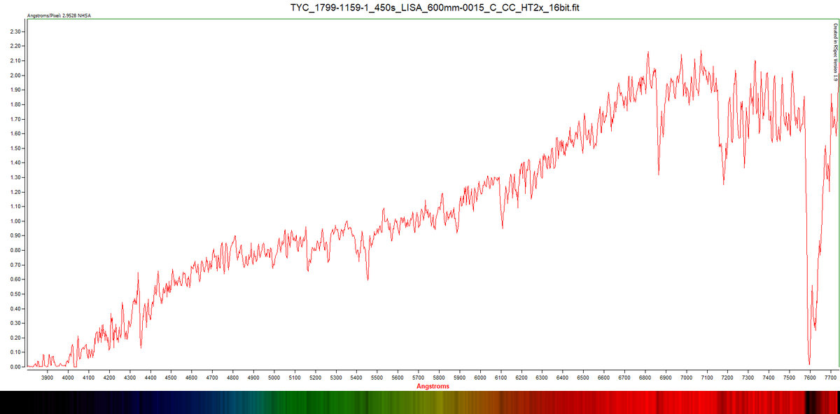

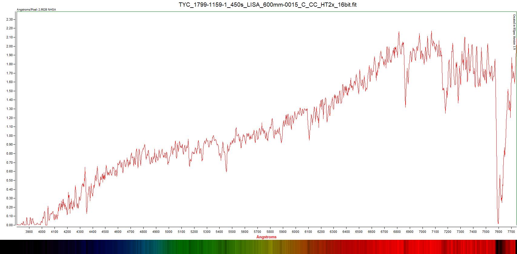

I managed to get TYC 1799-1159-1 yesterday night and made 15 images each 450s and processed the outcome into a spectrum. I tried to calibrate the spectra with the instrument response curve I have. Nor perfect but trying to learn more and more with time. Just started again with Spectroscopy so please excuse mein stümperhafter Versuch
Unfortunately my sky is not that good anymore. Below the result. If it helps and you need more info I can provide it to you. Just tell me what you need and I will galdly send it to you.
Grüße Rainer
Grüße Rainer

yes, this spectrum helps me, like the one by Uwe Zurmuehl posted further up, and like a third one that Keith Shank (Texas, USA) mailed to me directly. All three convincingly and conclusively say that the strong H-alpha emission line that I hypothesized does not exist. The spectrum looks very much like that of a normal K giant in the red-giant clump (i.e. with central He burning ongoing), as the Gaia DR3 parallax and photometry suggested. This means that the 0.4-magnitude eclipses are not reated by some small H-alpha emitting object covered by the giant (this was my hypothetical way out of the astrophysical dilemma posed by the system), but that indeed something big must be covering 40 percent of the giant. Every 35 days for just an hour or so. Don't ask me what that could be. This exactly is the problem.
My next thought then is: Whatever that object may be, given its size it is improbable to have small mass. If it is massive indeed, it should create considerable radial-velocity variations on the giant star. Could not easily be less than 100 km/s.
Thus my next question to the community (and to Uwe Zurmuehl and Rainer in particular): What's the precision (and calibration reliability) of radial-velocity (RV) measurements that you can get out of your spectra? Potentially, the RV of the giant might vary by more than 100 km/s over the next 8 days. Any chance to get that??
The eclipse was on March 6, the period is 35 days. That is, on March 16 the RV will be maximally positive, around March 25 it will be zero again, on April 3 it will be maximally negative, and on April 10 there will be the next eclipse - again with about zero RV. That's for sure. The question is the amplitude. If we get that, we will immediately know the mass of the occulter - since the mass of a clump giant must be in a limited range, and the period is known.
I still find it amazing that I got a spectrum almost within hours, and now it's already three within a few days ...
Kind regards, Uli
Kind regards, Uli

Hi Ulrich,Thus my next question to the community (and to Uwe Zurmuehl and Rainer in particular): What's the precision (and calibration reliability) of radial-velocity (RV) measurements that you can get out of your spectra? Potentially, the RV of the giant might vary by more than 100 km/s over the next 8 days. Any chance to get that??
Nice to hear it was of use for you.
Now in regard to your above question I ahve to damit that I have no idea how to do that. If you would care to explain this to me via e-mail or perhaps a messenger chat ?
I can shoot the star today again and the next days provided there are no clouds an make more spectra. I think I will also need to shoot a reference star near TYC 1799-1159-1 for calibration purposes. I just saw today the Moon is 11° away from TYC 1799 ...
Hopefully the sky gets a bit better and so I get less sky light pollution. This has gone terrible compared to two years ago.
Will let you know how my image acquisition goes.
Grüße Rainer
Re: urgent observation request for TYC1799 1159 1
Hi Rainer,Rainer Ehlert wrote:Hi Ulrich,Thus my next question to the community (and to Uwe Zurmuehl and Rainer in particular): What's the precision (and calibration reliability) of radial-velocity (RV) measurements that you can get out of your spectra? Potentially, the RV of the giant might vary by more than 100 km/s over the next 8 days. Any chance to get that??
Grüße Rainer
I recommend reading the presentation "Observing with a LISA spectrograph - David Boyd" on the BAA website here
https://www.britastro.org/downloads/15701
slide 43-52
With care and good technique it is possible to get a radial velocity precision of better than 10km/s with the LISA and this G star is a good target for the cross correlation method. A good instrument response is not needed for radial velocity measurements as you are only interested in the position of the lines but you do need good low noise spectra and it is important to take calibration lamp spectra often. You should also take a spectrum of a bright star with a known radial velocity as a standard to get an absolute calibration.
LHIRES III  #29 ATIK314       ALPY 600/200 ATIK428      Star Analyser 100/200      C11  EQ6
