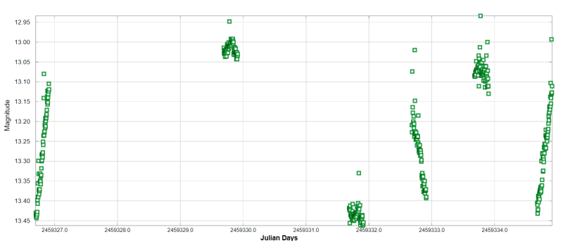

Originally suspected to be a gravitational microlensing event the light curve over the past week has been varying rapidly in an erratic way
ASASSN-21gk in sagittarius - spectra urgently required !
- asassn_21gk_light_curve.png (44.11 KiB) Viewed 16126 times
Re: ASASSN-21gk in sagittarius - spectra urgently required
A spectrum has now confirmed it as an "ordinary star" so the source of the variability is unclear.
