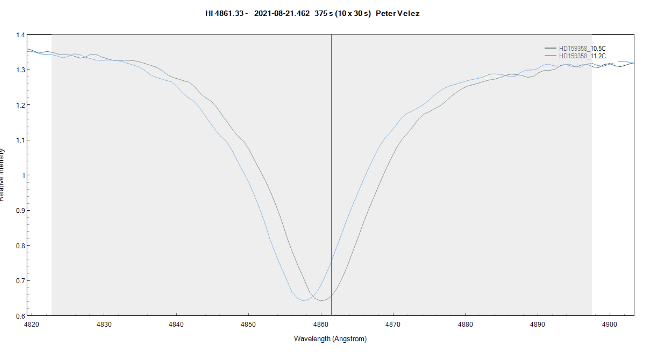

Recently, I have found that the calibration is still a bit off. The attached screenshot may help visualise what is going on. This is the H beta absorption line for a reference star plotted using Plot Spectra. The red line indicates where H beta should be. The 2 spectra have been processed in the same way with ISIS - the only difference is the ambient temperature at which the relevant ArNe frame was taken. The ambient temperature when the first target spectrum was taken was 10.5C and as expected, the fit is better for the 10.5C ArNe frame than the frame taken at 11.2C. But it still has an error of about 1A. The solutions produced by ISIS for both ArNe frames are near identical - the only difference is the A0 of the polynomial. I've cross-checked all of the Balmer lines and found that the difference between the 2 spectra are the same - about 2.45A.

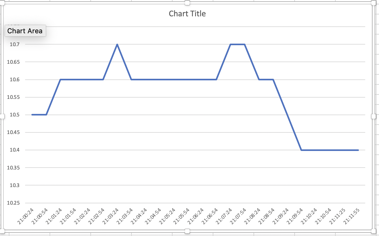

Now the puzzling aspect of this for me is that the ambient temperature throughout much of the imaging run was in fact higher than 10.5C. I attach a graph showing the change in temperature during the course for the imaging run. You can see that the temperature ticked up before dropping.
I accept that this was a short imaging run. However, I have seen similar behaviour with much longer exposures.
Am I missing something in the ISIS processing routine which addresses this? How do I ensure that the solutions are accurate and reliable? For targets like this, I can adjust the spectrum to match my expectations - if there are Balmer lines then I can add a wavelength adjustment manually. I can also do the same with atmospheric lines in the red and NIR. I believe that Christian suggests something similar for the Lhires in his tutorial. But if I am imaging a new target without these obvious reference lines - eg when I shift to the 1800 grating - how can I have confidence in the data produced?
I'd welcome any comments/suggestions - either hardware or software.

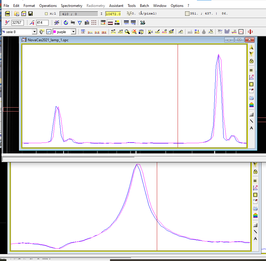

Re: Temperature and calibration
An example with the LHIRES showing the same shift in lamp and star from start to end of run (2 pixel shift in 45 min (15x 3min exposures)
binned in the same Y position using Visual Spec.
