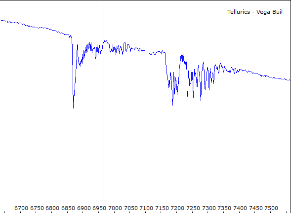

Note there are a strong telluric bands in the region where the red shifted H alpha line falls so either remove them by including them in the response correction or divide them out using a template prepared from the reference star.

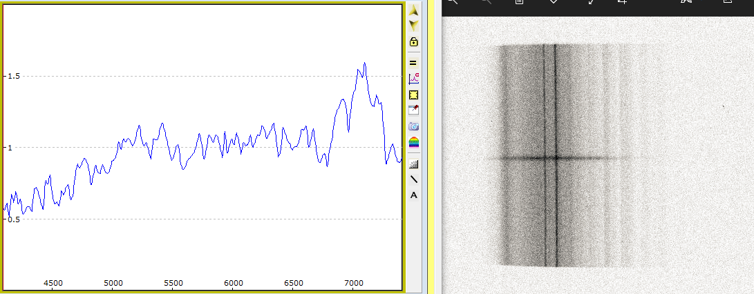

The redshifted H alpha peaks about 50% above the continuum in my R~130 ALPY200 spectrum but it is not obvious in a single raw image. (the air glow and telluric bands make it difficult to spot, think.) Here is the finals spectrum and a single 1200s image (dark and cosmetic subtracted)

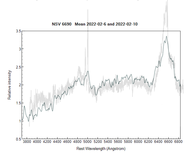

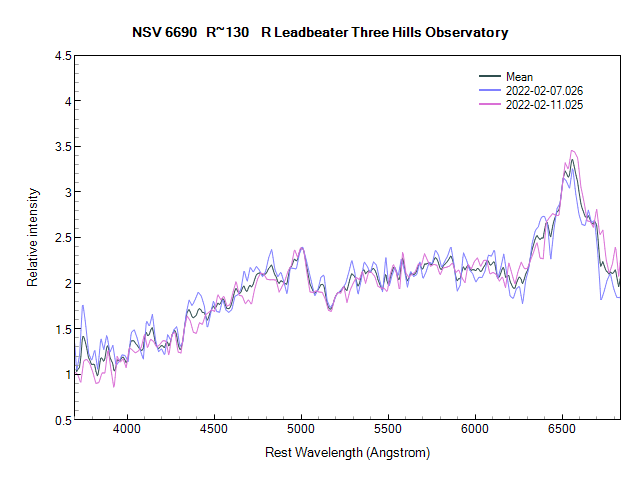

I managed to get another spectrum. The feature on the blue wing is not so obvious (The SNR in the mean spectrum is still only ~20 at that wavelength)
but there is still perhaps a difference compared to the the spectrum in the paper (in grey).

How always, a fine job, Robin !
That observation is very difficult. Congratulations !
