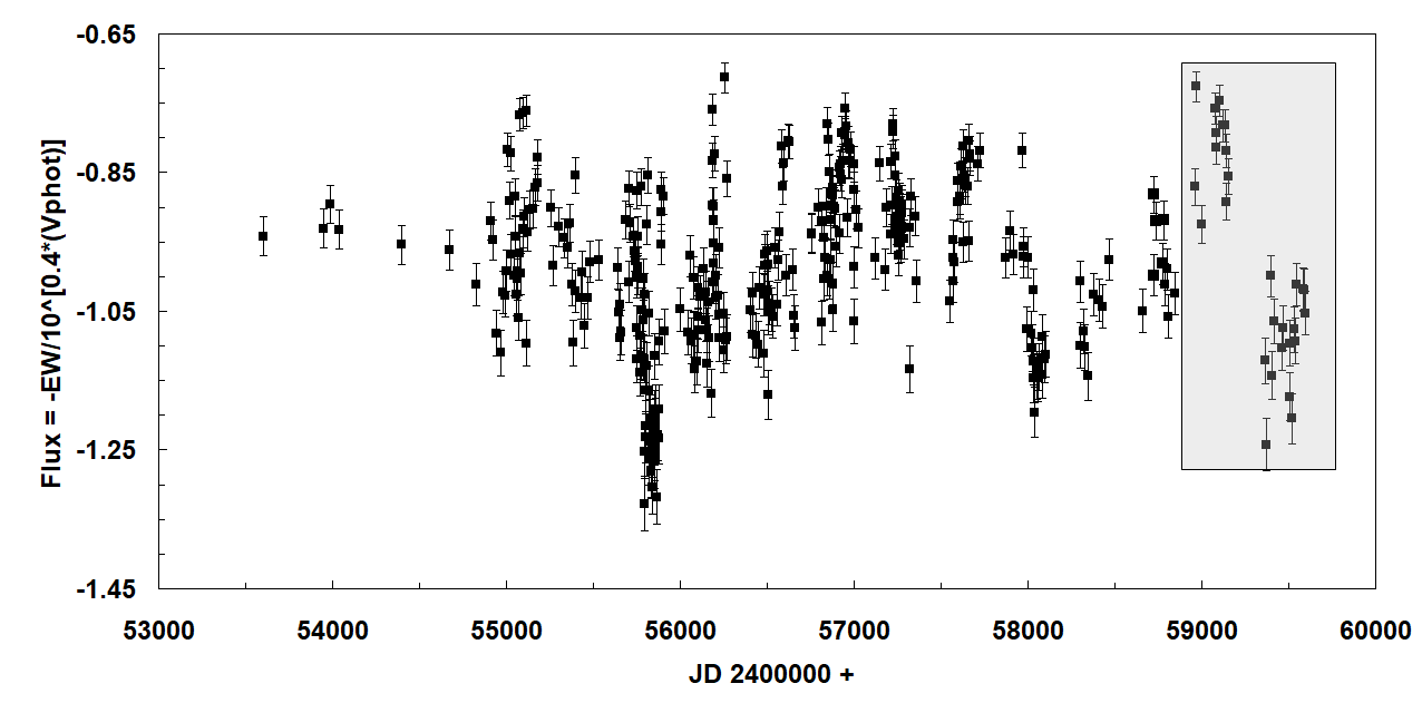

you write in capter 4.3.1:
In short, despite our ability to reproduce fairly well the Hα line profile of P Cygni observed in 2020 using such a less intense wind model, it is beyond the scope of the current paper to state that the intensity of the wind of P Cygni varied in this way during this two-year period.
I find this to be an unacceptable disregard for the facts. In fact, the intrinsic Halpha flux has changed dramatically during this period (see the attached ARAS long-term monitoring of the intrinsic Halpha flux of P Cyg)
It would be good if you could share this important observation with your fellow authors. It could be that your interpretation and summary of the results will change significantly as a result. Regards,
Ernst
Ernst

Dear Ernst,Ernst Pollmann wrote:Hi Olivier,
Ernst
Firtst it's not me, but others professional working on this paper whose wrote this sentence, then they precisely asked me to redo the spectra of P Cyg at the same time as their observations, to have a spectrum of the state of P Cyg at the same time as their observations. They just had a doubt about the stability of the anterior P Cyg profiles.
My work in this article consisted in providing them with spectra made at the same time as their interferometry measurement, but I have not written anything nor issued conclusions that go far beyond my knowledge of astrophysics.

Ok, I understand, Olivier,
but nevertheless, could you be so kind to pass them my posting?
Ernst
Ernst
- Posts: 1268
Re: Publication about spectroscopy and interferometry
Of course, i will send your graph.Ernst Pollmann wrote:Ok, I understand, Olivier,
Ernst
