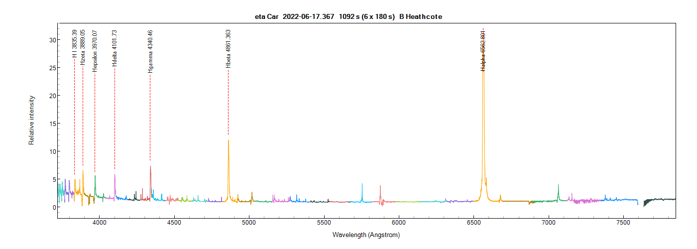

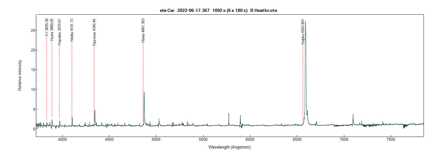

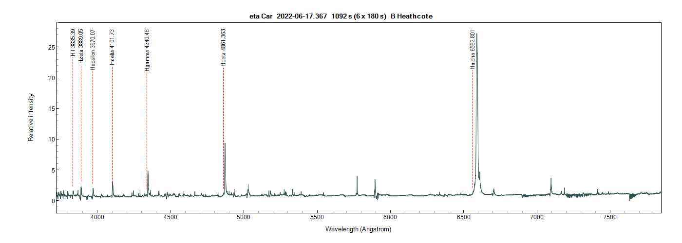

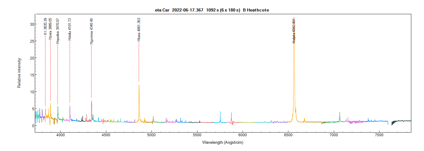

There is no wavelength shift with the individual orders, so the error is only introduced during the merge process.
The plots below show the correct wavelength for individual orders and the shift for the merged orders.
