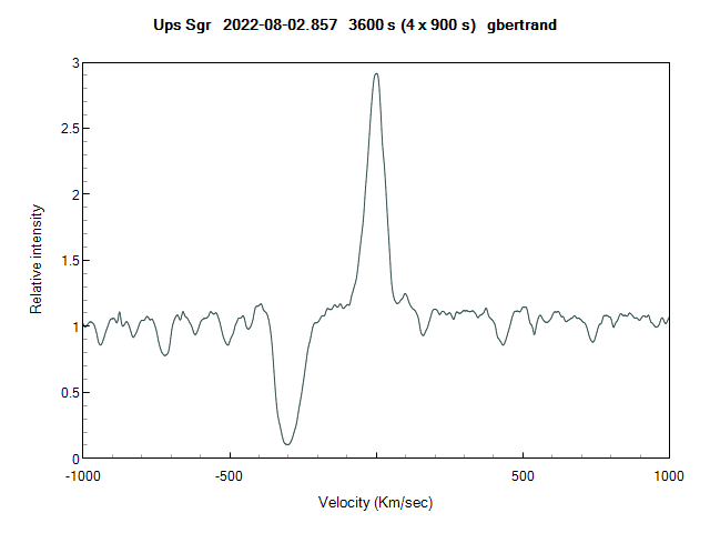

Here a recent (from a few minutes ago) hight resolution spectrum of Ups Sgr.
There is indeed an absorption on the blue wing of the h-alpha line...
If you have any explanations regarding this particular profile, I'm interested!

Great spectrum ! Sorry I do not know any more about this rather strange system. I cleaned up the telluric lines and produced a velocity plot from your spectrum.
Assuming the emission is centred at the H alpha rest wavelength, the centre of the absorption line is at -300km/s. It is remarkable how much the emission and absorption are separated. Not like the usual P Cygni profile.

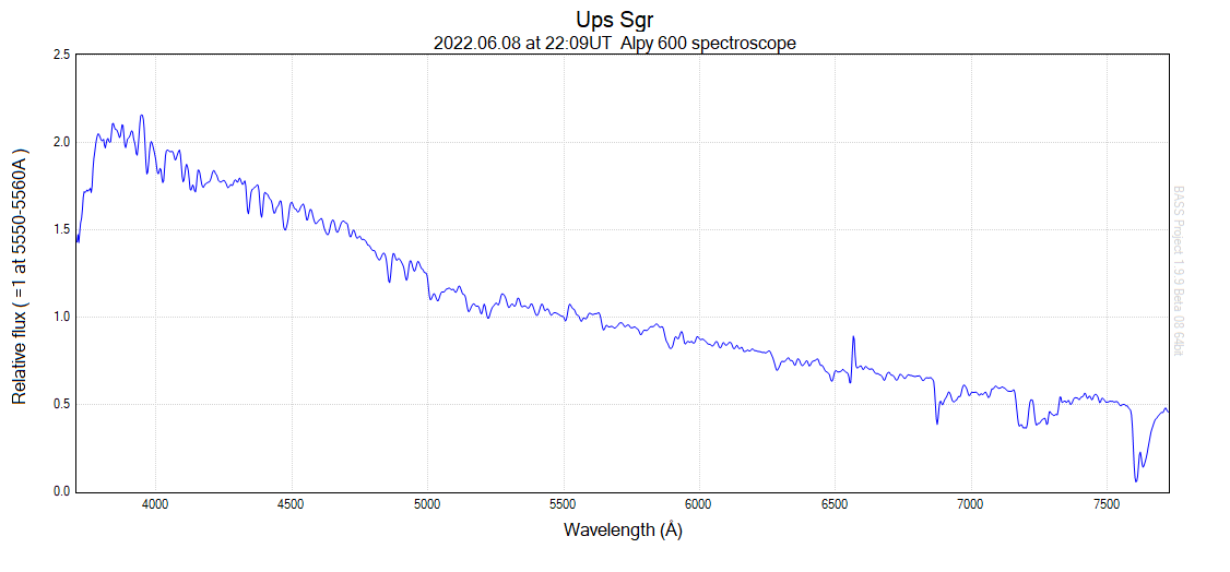

Thanks Robin for highlighting this interesting star. Even at the low resolution of my Alpy 600 the apparent P Cygni profile is quite distinct, although at this resolution not the plateau between the Hα emission and absorption visible in Guillaume's high resolution spectrum. For such a hot star the spectrum is unusually full of relatively strong absorption lines. It would be intersting to catch another spectrum in a month's time if that's possible at such a low altitude

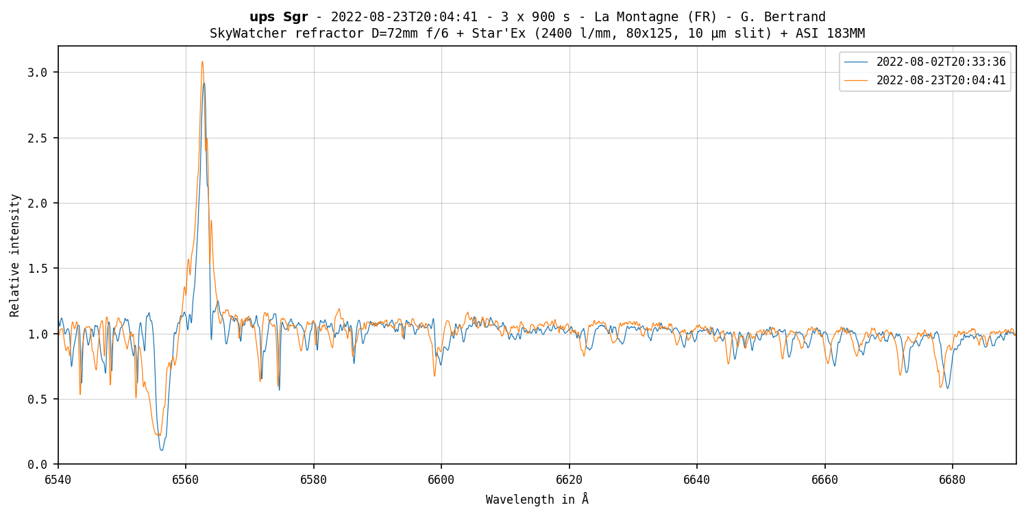

The profile of ups Sgr has changed significantly in a few days :)
Here the comparison of two spectra (heliocentric correction applied). All lines are shifted! Probably the doppler effect of the binary system...

That's a beautiful Doppler shift between your high resolution spectra Guillaume.

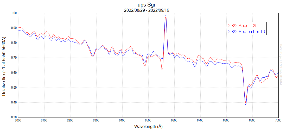

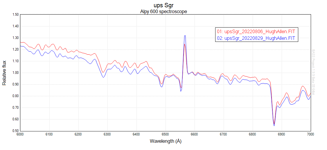

I captured another Alpy spectrum on 29th August that shows no sign yet of any weakening in the Hα absorption feature. Here's a comparison with my spectrum taken 23 days previously:
Full wavelength range normalised at 5550-5560 Å:
Zoom around Hα normalised at 6580-6590 Å:

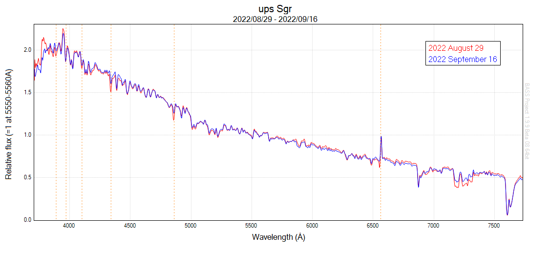

I captured another Alpy spectrum of ups Sgr on September 16th which shows that the blue shifted Hα absorption has now faded compared to the last spectrum I captured on August 29th:
upsSgr 2022.08.29-16.09.png (43.4 KiB) Viewed 25110 times
upsSgr 2022.08.29-16.09 Halpha zoom.png (44.89 KiB) Viewed 25110 times
All of the hydrogen Balmer lines appear to have weakend between these dates, and they all show a significant blue shift. The Hβ line provides a good example:
