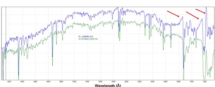

After processing the spectrum, i get the telluric lines at the red part of the spectrum as emision lines, obviously wrong.
In the next image, the blue filter, processed with ISIS shows some of those lines. On the other hand, the same one processed with Demetra -green spectrum- does not. It seems Demetra is doing a better job.
ISIS vs Demetra.jpg (41.82 KiB) Viewed 30006 times

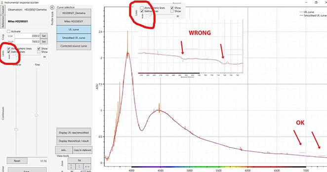

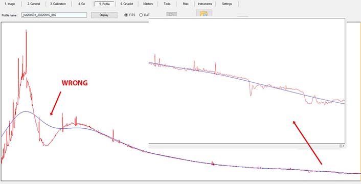

I found out that the aparition of those lines depends on how the instrumental response is built.
In Demetra, in the "Instrumental response builder", there is the option to tick or not the button "Atmospheric lines". I always leave it ticked ON, as then, when the reponse line is fitted, the area of the instrumental response where the atmospheric lines is will stay flat. While if i untick it OFF, that line shows waves and the resulting spectrum will result with atmospheric lines on emission. See the next attached image. The inset shows how the instrumental response, at the red end of the spectrum, will look if "Atmospheric lines" is not ticked.
Demetra response.jpg (43.62 KiB) Viewed 30006 times
I did not find how to do this same and simple procedure with ISIS, while Demetra makes it very simple.

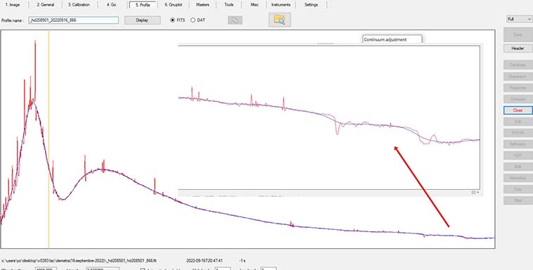

Building the instrumental response with ISIS, if the curve is properly fitted, the atmospheric lines area is not correct. With the following curve the final spectrum will show those atmospheric emissions.
ISIS response atmo wrong.jpg (36.9 KiB) Viewed 30006 times
While to fit the curve in the atmospheric area correctly, the rest of the curve will be poorly fitted.
ISIS response fit wrong.jpg (32.21 KiB) Viewed 30006 times
I already tried many fittings to arrive at a good final result but i did not manage to achieve it.

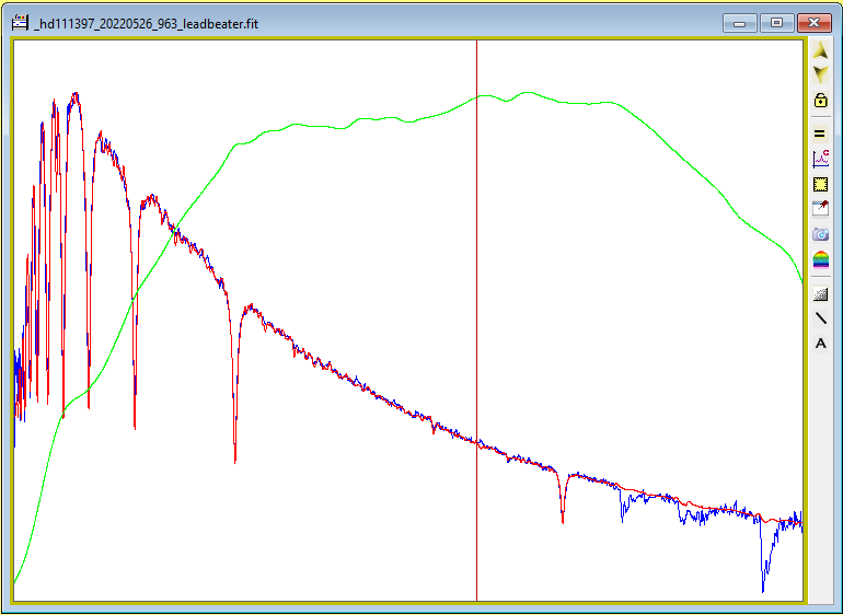

In ISIS you crop out the parts of the spectrum you do not want to appear in the response before fitting a smooth curve. (Double click at the start and end of each region) This is typically used to remove the Telluric band but also for example any residual Balmer lines which have not exactly divided out. This makes it very flexible. (Demetra must do something similar but perhaps automatically)

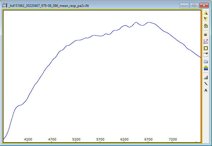

The flexibility of ISIS means you can remove exactly the regions you do not want to include and you can smooth the profile by exactly the amount you need without losing the important detail in the response. The test that the resulting response is correct is to run the reference star spectrum again using the calculated response. If the response is correct the result should closely match the spectrum from the library (except that the resolution may be different and the measured spectrum will have Telluric bands in it) For example this is what my typical ALPY600 response looks like
