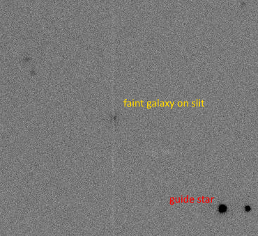

These targets are much to faint to guide directly on so I guide on brighter stars in the same field. (I first take a long exposure and calculate where I need to place the guide star so the target is on the slit)
Re: how to improve the visibility of objects in an Alpy600?
Here is an example of the ALPY guide camera image when measuring a galaxy (IC708) using a brighter guide star in the same field
The spectrum is here
https://britastro.org/observations/obse ... c89b9255ae
