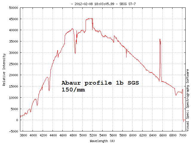

Some days my spectra show a deviation of the continuum linewhich I can'texplain,the other day everything seems o.k.I looks like interference from outside??The circumstances in my observatory do'nt change:two desktops one lcd monitor and one led screen, LCD TV with DVB-T antenna.My observatory is located at 50 m away from one railroad rack and 500m from another railroad.Could it be the ccd camera ST7XME.

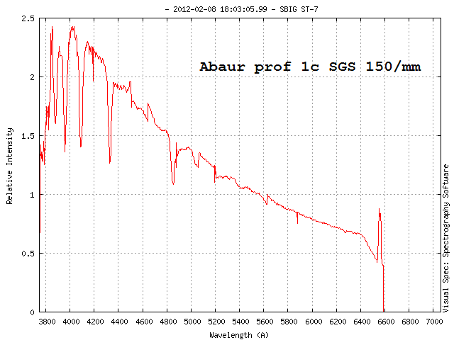

I reprocessed spectrum ABAUR spectrum ,now it looks allright,maybe I forgot to check the "remove cosmic rays box in Spcaudace"Default = no.There are other raw spectra with show bright white spots which I can not eliminate after carefully recalibrating f.i this spectrum of delsco.

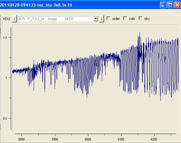

I had a quick look at your spectra. They look allright. A quick analysis in ISIS (without specrtral calibration) showed no modulation of your baseline as in your spectrum. So my guess it has to do with the processing. Some time ago I had a similar problem with some echelle spectra in Audela:
modulation in binned echelle spectrum with Audela eshel
binning echelle.jpg (41.8 KiB) Viewed 12110 times
I attributed it to a very narrow width of the spectrum (about two pixels), which the algorithm for calculating the spectral intensity was not doing correctly. What you see is a modulation when jumping from ond CCD row to the next. In your spectrum the width is also quite narrow, so I could imagine it is a similar error. Maybe you had a better guiding for this spectrum,so the effect shows only here, but this is only speculation.
My recommendation: learn and use ISIS, I never had this problem there (although I am not using 2x2 binning in the camera anymore). Try without and with optimal binning and see if there is a difference.
