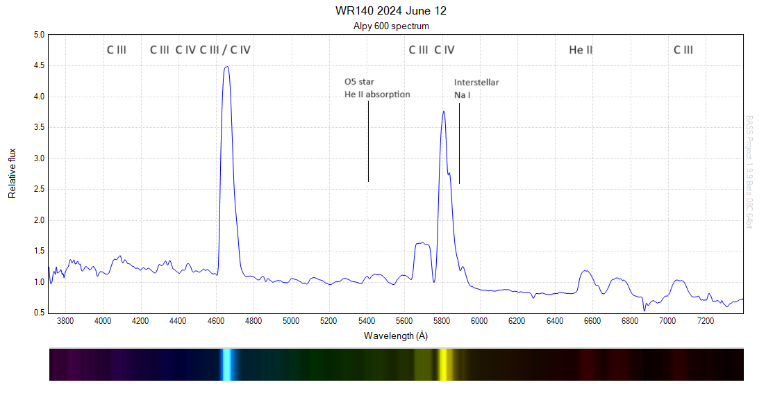

Whilst the uncertain eruption of TCrB has become a focus for observation this year, I think the forthcoming periastron of the binary Wolf Rayet star WR140 shouldn’t be neglected. A high-resolution pro-am campaign around the previous periastron in 2016 December resulted in improved orbital elements with an estimate of 2024 November 22 for the next. (‘The orbit and stellar masses of the archetype colliding-wind binary WR 140’ Joshua D Thomas et al, Monthly Notices of the Royal Astronomical Society, Volume 504, Issue 4, July 2021, Pages 5221–5230 https://arxiv.org/abs/2101.10563 ). Regular observations in low resolution during the weeks around periastron should make for a great project, allowing many of the broad emission lines to be monitored for changes:
WR140 2024 June 12.png (60.31 KiB) Viewed 14142 times

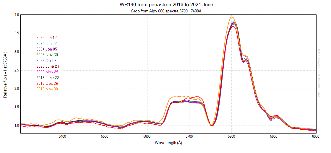

The flat-topped CIII emission was the focus for observation in 2016 and although I was at the beginning of my spectroscopic journey back then, I managed to observe changes in this line with my Alpy 600:
WR140 time series periastron 2016 - 2024 Jun.png (74.11 KiB) Viewed 14142 times

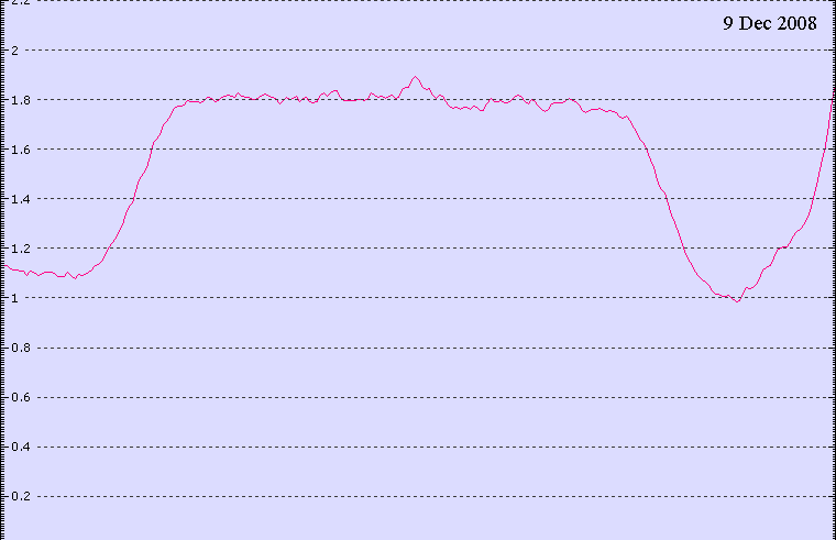

The periastron previous to that one was also followed in 2008-9 by the same "Convento" pro-am team.
https://ui.adsabs.harvard.edu/abs/2011M ... F/abstract
Here is what happened to the flat topped CIII line as the winds collided
http://www.threehillsobservatory.co.uk/ ... tra_41.htm
It is plotted in the WR star rest frame. You can see the excess emission from the wind collision and the tiny bump in the middle from the O star moving in velocity relative to that as they sweep past each other.

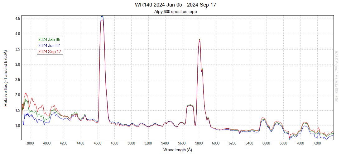

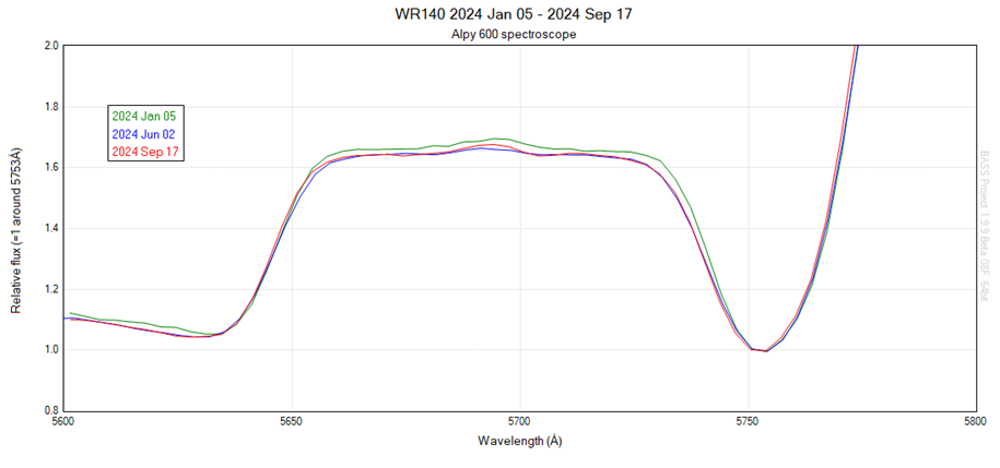

I think we could expect to see the first blue-shifted excess on the flat-topped CIII emission by October 16th or even earlier, based on what I observed during the last periastron. At the moment the CIII emission is still fairly constant:
WR140 time series 2024 Jan 05 - Sep 17 CIII zoom.png (60.83 KiB) Viewed 13344 times
A heliocentric correction has been applied, and the calibration has then been adjusted based on the interstellar sodium absorption line in the spectra.
Here is the comparison at the full wavelength range:
WR140 time series 2024 Jan 05 - Sep 17.png (81.03 KiB) Viewed 13344 times
Hugh

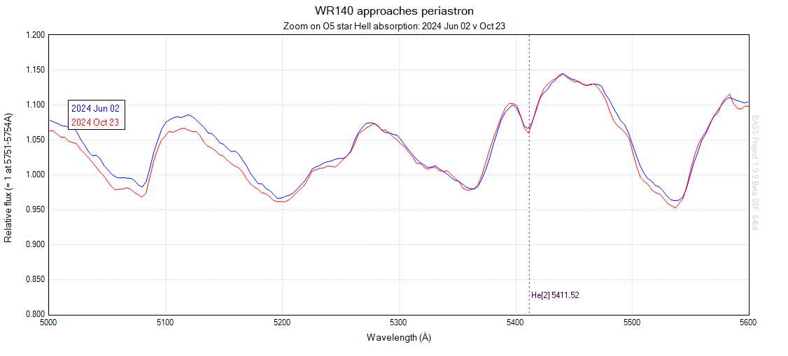

All of the emission lines from the Wolf Rayet star are showing a significant blueshift of the order of 100km/sec, whilst the He II absorption from the O5 companion star shows barely perceptible redshift at this resolution:
WR140 approaches periastron O5 star HeII absorption zoom 2024 Jun 02 v Oct 23.png
WR140 approaches periastron O5 star HeII absorption zoom 2024 Jun 02 v Oct 23.png (57.39 KiB) Viewed 12750 times
Hugh Allen
