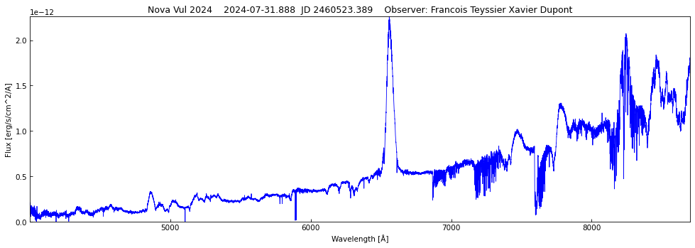

Spectrum secured at SMM Joan Guarro remte station with an echelle NOU-T R =9000
Flux calibration using V Band magnitude.
The spectrum is strongly reddened (see the shape of the continuum and the strength of interstellar Na I).
Fe II (42) mutliplet appears clearly.
OI lines (7776, 8446) in the near UV are very strong.

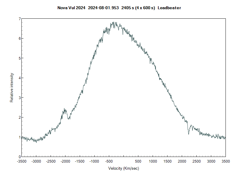

H alpha line profile 20240801.953 LHIRES 2400 R=15000

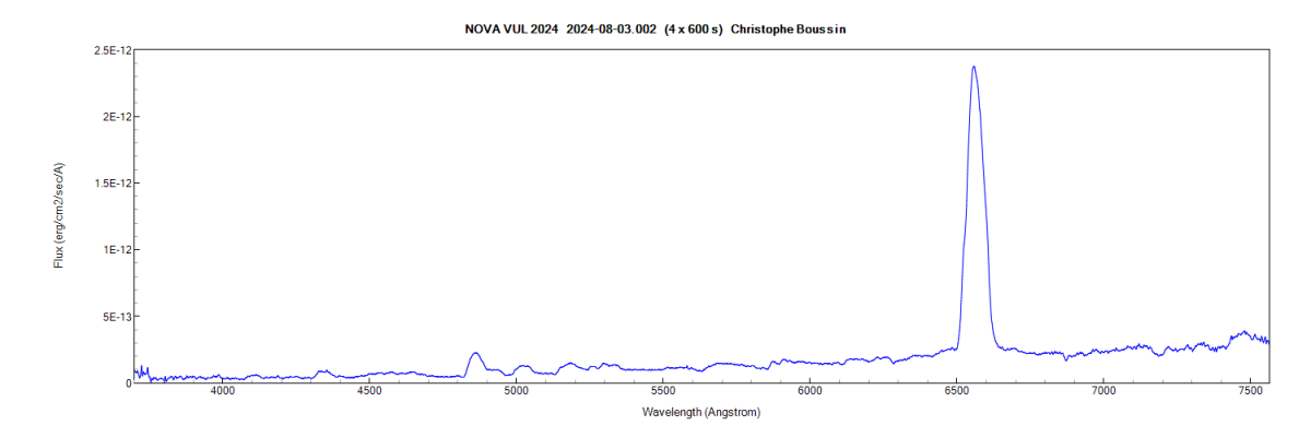

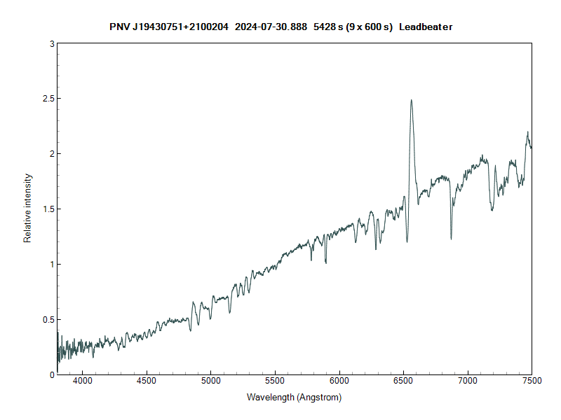

Here is my contribution to the monitoring of Nova Vul 2024.
I obtained the following spectrum calibrated in flux (magnitude measured V = 11.12) with a spectral range from 3700 to 7565 A the 3th of August at 0 h 02 UT with my Alpy 600 (resolution of 543, JJ = 2460525.5016) and an acquisition time of 40 min (4 x 600 s) :
Nova Vul 2024 on August 3th, 2024 (flux calibrated, 3700-7565 A)
Clear skies,

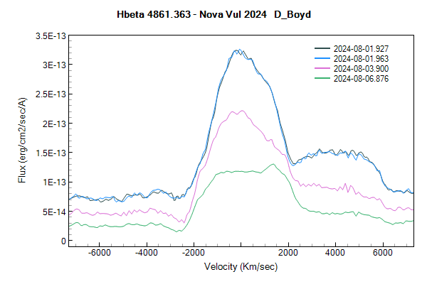

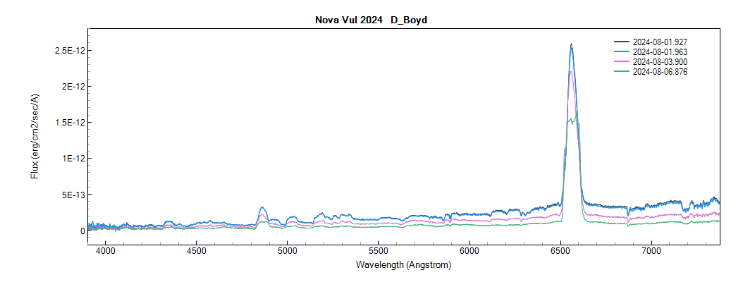

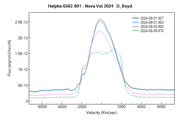

Recent evolution of Nova Vul 2024 at low resolution. C-11 + LISA, R~1100, flux-calibrated with concurrent V-band photometry.
novavul2024_20240801_927_D_Boyd H-beta.png (27.64 KiB) Viewed 24784 times
novavul2024_20240801_927_D_Boyd H-alpha.png (26.94 KiB) Viewed 24784 times

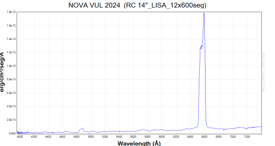

Nova Vul_2.png (20.04 KiB) Viewed 24724 times
Last night´s. Resolution around 720. Flux calibrated
Re: Nova Vul 2024 July, 2024
Posted: Mon Aug 12, 2024 3:59 pm
by David Cejudo
Evolution in low resolution (R≈730) during the last four days.
