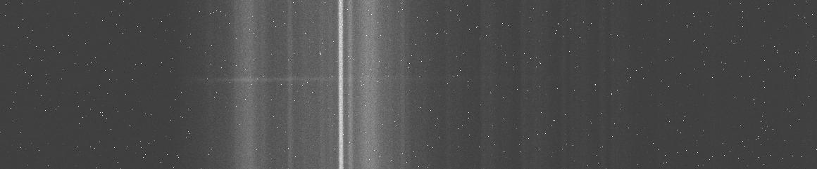

I pointed the object (m=19!!!) by aligning the extension of the slit with a small star almost same declination as the target. Previously, 2 minutes of exposure via the guidance camera revealed a very very small blur at the supposed target's location. I noted the x,y position in pixels that I report on another star (guide star).
Target is about 65° high in the sky, hd43378 is the reference star.
Here is the first spectrum of 30 minutes
I reduced the data on day after and here is the 1D spectrum resulting of 5 fits of 30mn

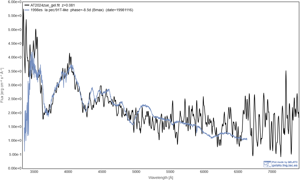

The continuum’s profile intrigues me and I submit the spectrum to Gelato. Here is the result with a 68 pc test.
gelatoplot (17).png (174.04 KiB) Viewed 10987 times

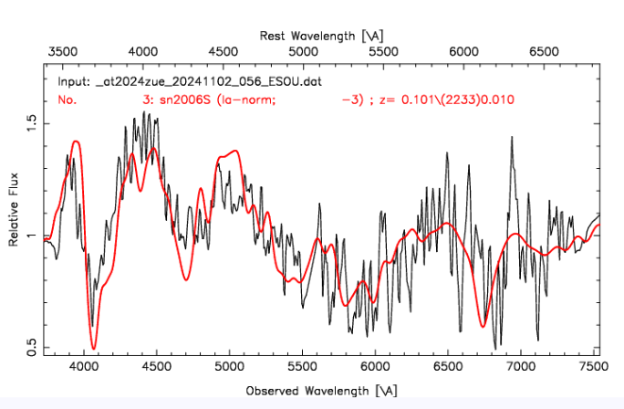

I send an email to Robin Leadbeater and attach the corresponding fits.
Shortly after, he answers me and there: Bingo!!!! The profile matches (SNID) with that of a sn type Ia. Wow, z=0,1!!!!
The TNS site is being updated by Robin https://www.wis-tns.org/object/2024zue
According to him, and if we leave it at that, this is probably the most distant supernova ever classified by an amateur.
