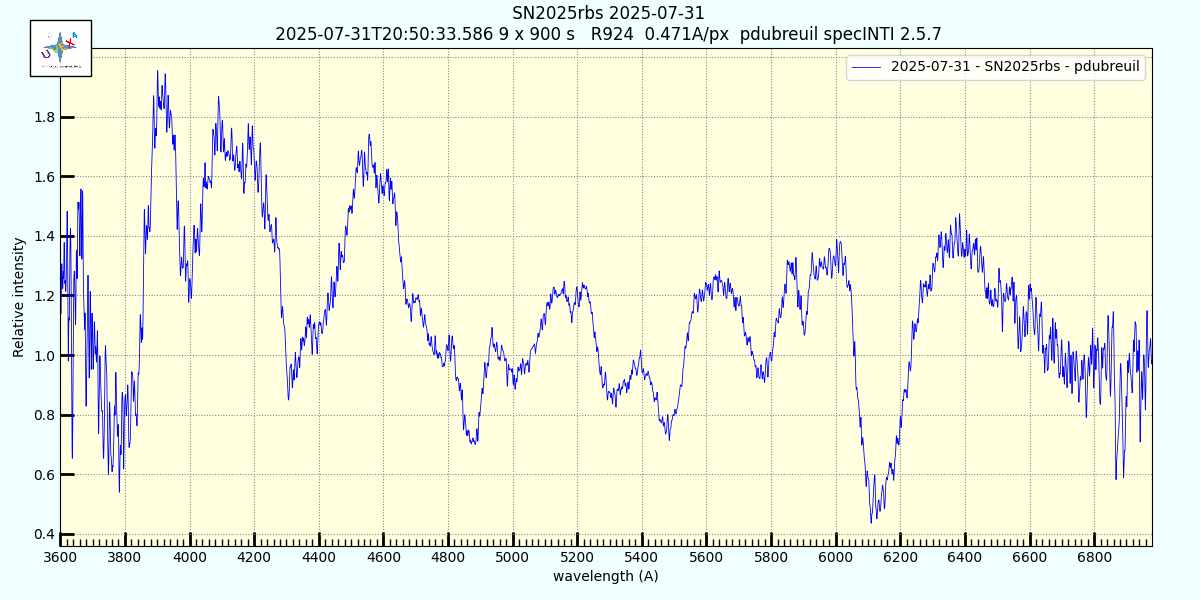

Bonjour
SetUp UVEX4i G300 slit25µ sur RC8 caméra ASI585MM
champ du chercheur
le spectre avec ref Vega
Spectre SN2025rbs 3599 to 6979.png (145.15 KiB) Viewed 3820 times
toujours brillante !
Re: SN sn2025rbs dans NGC7331
Posted: Sat Aug 09, 2025 12:05 pm
My analysis of the spectrum at maximum. (ALPY600)
https://britastro.org/observations/obse ... ea2d03013c
Not all type Ia are the same but SN 2025rbs looks like a very normal type Ia :)
