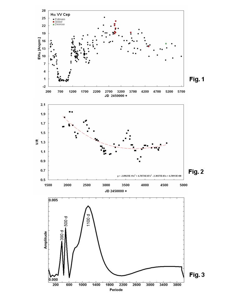

Before the background of the already running collaboration at this project, here some of the Spectro-L-communication regarding details in terms of observation and physics:
The longterm (4.9 mag) periodic binary system VV Cep (primary component = M type, secondary component Be-star with disk) is one of my program star since 1996 (fig.1). After the eclipse in 1997-1999 particularly the Halpha V/R ratio of the Be-star disk is one of my special interest (fig.2).
Recently a period analysis reveals three periods of V/R (fig. 3), but this result is not sufficiently reliably. The observation frequency has to be higher.
Because of this situation I'm looking for observers who are interested to take part at this project. In case of interest please contact me.
Ernst

Your readiness to take part is really great. For requirements see my attached last spectrum as a template. To determine the S/N is somewhat difficult, because of the strong presence of the metal lines. But approximately 100 should be sufficiently.The usage of the 2400 grating would be fine, the star is bright enough for this relatively large dispersion. But on the other side it is helpfull for the separation of the double peak. It would be a great pleasure for me, to have you as member at this campaign. Let me know, if you want to learn more of VV Cep.
Ernst

My colleague B. Hassforther from the German Association of Variable Stars (BAV) and me have used his data and your PEP data in terms of the period analysis, what I mentioned here. But we couldn't find any connection to the quasi periodic behavior of the companion´s disk. Maybe PEP data in the future will contribute to a clarification in this sense.
Ernst
