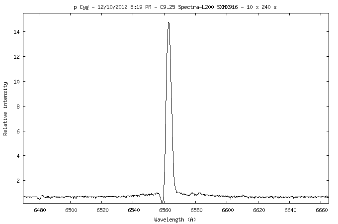

this is my spectra made with L200 spectroscope.

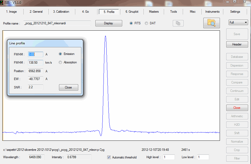

and the profile (ISIS):

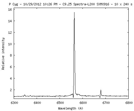

yes it will be a big pleasure for me to partecipate at p Cyg campaign. Recently I installed a new grating: 1800 lines/mm (the previous spectra has been made at 600 lines/mm).
Here below please find yesterday night p Cyg spectra with 1800 lines/mmm grating and the EW at H alpha calculated by ISIS.
Let me know if you want also the absorption line EW near H alpha.
Thanks and Regards,
Marco
