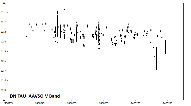

Such behaviour looks common for this star.
Here's the AAVSO light curve in V Band
Varitations at hour time scale are frequent
Time serie at higher resolution with LISA or LHIRES 150 l/mm should be interesting

Hello François,
Yes such variations should be easy to see in the photmetry. (or even visually - there are anecdotal reports of flickering seen in this star apparently) The V mag perhaps increased by ~ 1 magnitude during this event and the B mag by even more! I have posted on the AAVSO campaigns forum encouraging photometrists to measure their individual exposures for this project and not to average them as is often done.
