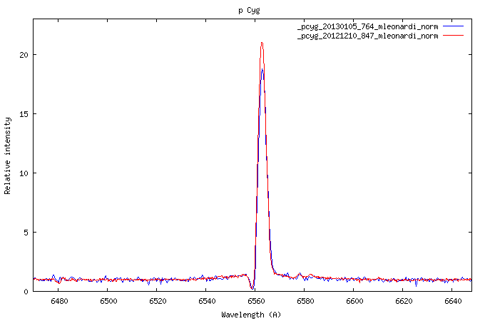

In my today observation of p Cyg I noted a decrease in H alpha intensity and EW .
p Cyg.gif (6.04 KiB) Viewed 4149 times
EW December 12, 2012 = -87.2529 A (max intensity = 20.99)
EW January 05, 2013 = -76.4043 A (max intensity = 18.80
EW measured with ISIS, lambda range 6510 6617.
Probably somebody can confirm a similar behaviour ?
