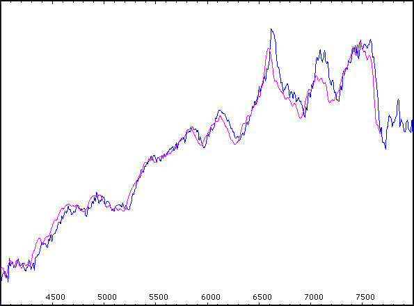

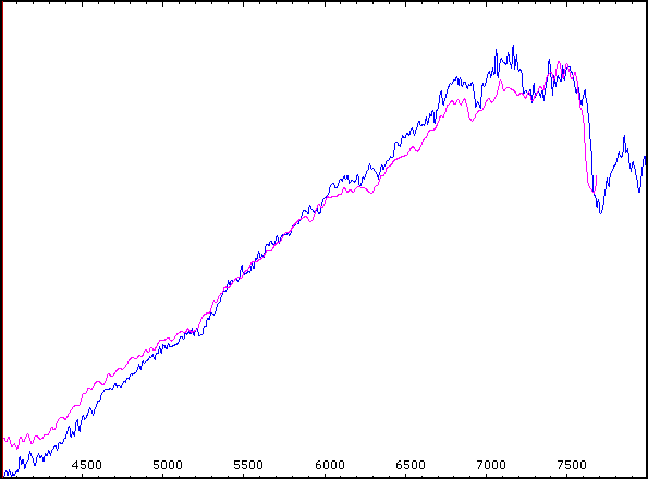

Re: RY, DN, DR Tau with Star Analyser
Hi Andrew,
This version of DN Tau is much closer to mine. Your GSC1829-18 is similar but has a slightly different slope. This could be the result of using a different star for instrument response or different atmospheric extinction. See attached (blue are your spectra, pink are my spectra from 20121211.
Independent of this though, the ratio of DNTau to GSC1829-18 should be repeatable between observers for a measurement taken at the same time. I will reduce my spectra taken on the same night and we can then compare them this way.
My resolution is low at only about 60A FWHM at H beta, partly because of the low dispersion (17.5A/pixel) I decided to sacrifice resolution for SNR for this project because as I understand it, the use of the Star Analyser spectra is to accurately measure the shape of the continuum. Other spectrographs like the LISA/LHIRES are better at measuring the spectrum at higher resolution but with the disadvantage of lower cadence and no simultaneous comparison star measurement. My observation of the fast transient suggest there is a risk of not seeing all the variation unless the cadence is faster than around 2 min per observation.

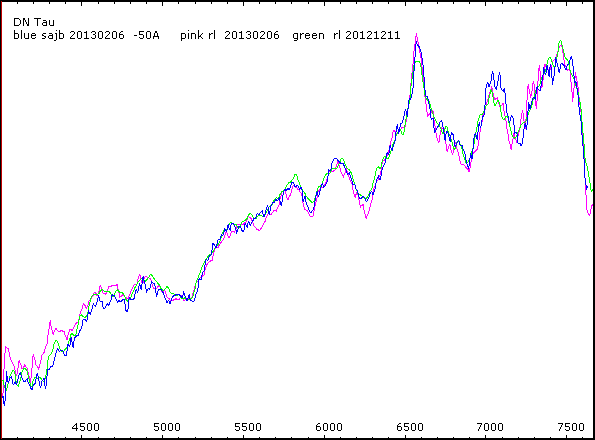

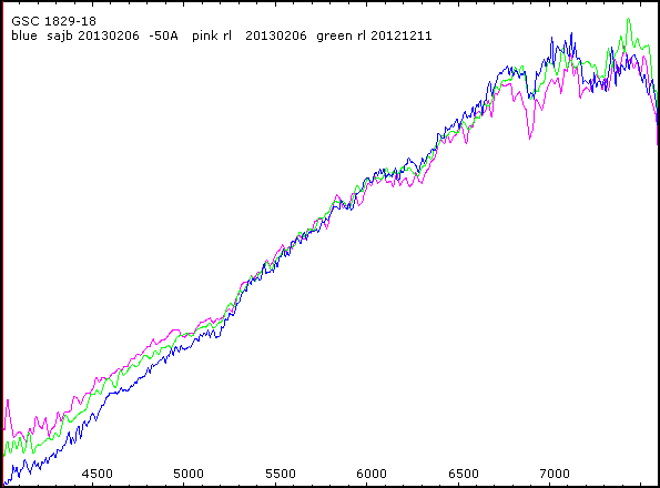

Hi Andrew,
Here are your spectra (blue) compared with mine for the same night (pink) and in December (green)
I noted a significant offset (+50A) in your wavelength calibration relative to mine (I have shifted your spectra to compensate for this in the graphs)
There are differences but they tend to be broadly similar in both DN Tau and GSC1829-18 asmight be expected for differences in atmospheric conditions or in instrument response due to using a different reference.
Remaining differences could be down to variations in the background subtraction for example (In my observations at least, the background is higher than the signal at the extreme ends of the spectra where the differences are greatest)
I suspect we are now exploring the limits of accuracy in terms of producing quantitative data using the Star Analyser
