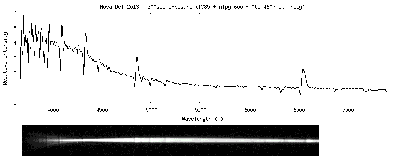

Here is a 300sec exposure with a very small 85mm refractor and our new Alpy 600 spectrograph.
I quickly processed with last night calibration (I'll do the calibration in about one hour) and the result is impressive with only one exposure:
