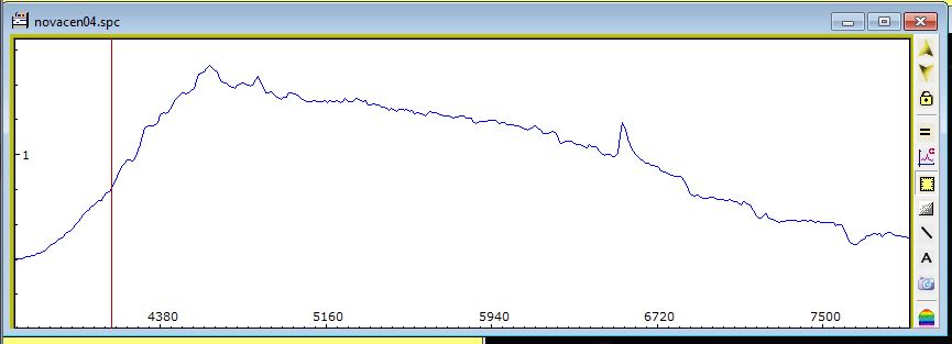

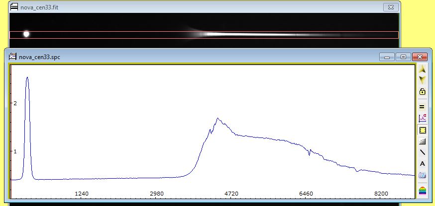

We've been lucky enough to have a couple of clear morning to image the nova.
Yesterday it was showing P Cygni profiles - clearly visible in the Ha, today they seem to have diminished dramatically.
Only lo-res spectra from the Baader 207 l/mm grating on the 4" f5 Genesis - 12A/ pixel, 30s exposures.

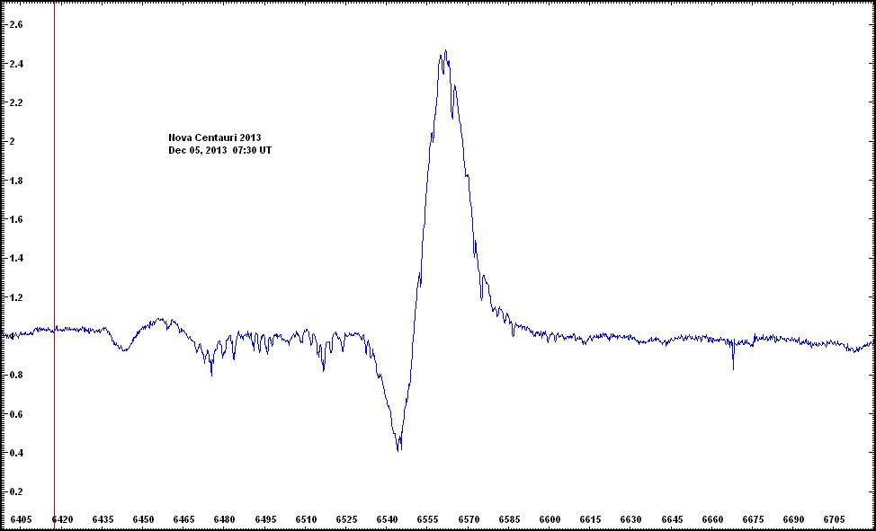

Dear friends,
Spectrum of V 1369 Cen taken on December 5, 2013 (07:30 UT) by Rogerio Marcon and Tasso Napoleao. Exposure 600s. Observing site: Campinas, SP, Brazil (22.792271 S, 47.070032 W, height 597m). Spectroscope R=11 000 (grating 2400 l/mm), Newtonian scope 315mm, Audine camera (KAF 1602); all equipment built by R. Marcon. Pre-treatment and reduction made with Maxim DL and VSpec 4.1.2.
P-Cygni profile in the H-Alpha line very prominent in this date. Expansion speed estimated as close to 900 km/s.
Regards,
Tasso.

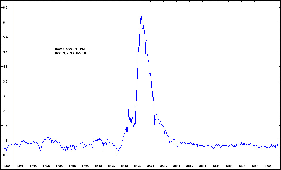

Dear friends,
Spectrum of V 1369 Cen taken on December 9, 2013 (06:28 UT) by Rogerio Marcon and Tasso Napoleao. Exposure 600s. Observing site: Campinas, SP, Brazil (22.792271 S, 47.070032 W, height 597m). Spectroscope R=11 000 (grating 2400 l/mm), Newtonian scope 315mm, Audine camera (KAF 1602), all equipment built by R. Marcon. Pre-treatment and reduction made with Maxim DL and VSpec 4.1.2.
The emission in H-Alpha has increased significantly as compared to our December 5 spectrum. On the other hand, the P-Cygni profile in absorption has weakened. This scenario appears to be very similar to the one observed in Nova Del 2013 a few days after the explosion.
Regards,
Tasso.

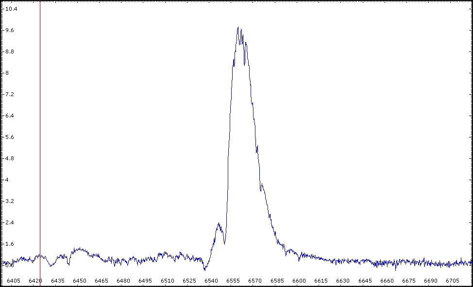

Spectrum of V1369 Cen taken on December 12, 2013 (07:12 UT) by Rogerio Marcon and Tasso Napoleao. Exposure 600s. Observing site: Campinas, SP, Brazil (22.792271 S, 47.070032 W, height 597m). Spectroscope R=11 000 (grating 2400 l/mm), Newtonian scope 315mm, Audine camera (KAF 1602), all equipment built by R. Marcon. Pre-treatment and reduction made with Maxim DL and VSpec 4.1.2.
The emission in H-Alpha has further strengthened as compared to the December 5 and 09 spectra. From our measures, we have estimated a development in the EW of the line from about -17 by Dec 05 to -135 by Dec 12, with room for further growth over the next few days. Will keep an eye on it.
Tasso.
Tasso.

Re: V1369 Cen
That's excellent
The evolution is well shown
How many exposures du you stack ? Perhap's the SNR could be improved.
The data base is updated : http://www.astrosurf.com/aras/Aras_Data ... n-2013.htm
Bonne continuation
Bonne continuation

Francois Teyssier wrote:That's excellent
Bonne continuation
Bonjour, François,
Those are guided single exposures, 600s each (not stacked). In the first round of images (Dec 05) we tried to combine two 600-sec images to check the effect on SNR, but we noticed that the improvement was quite small...but anyway, we will be glad to hear your recommendations.
Amicalement,
Tasso.
