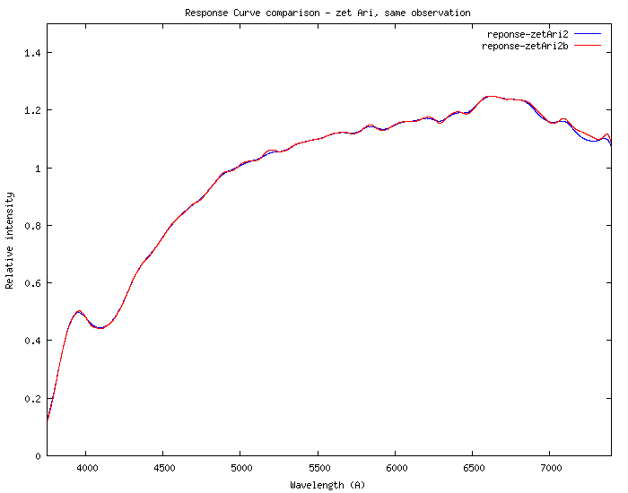

For zetAri2, I did the calculation two times at different moments, to see how consistent is my own contribution (buliding a response curve has some subjective effect). Here is the result :
... I consider this is really consistent !

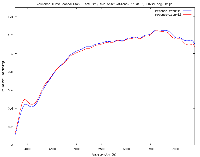

Now, here is the comparison of both zet Ari spectra (1 and 2) :
Again, this is consistent, but we see a gap, mainly in blue part. I suspect this is because of the height of the star in the sky (atmospheric effect). This is why we must take reference stars as close as possible of the observed star (at least close in elevation).

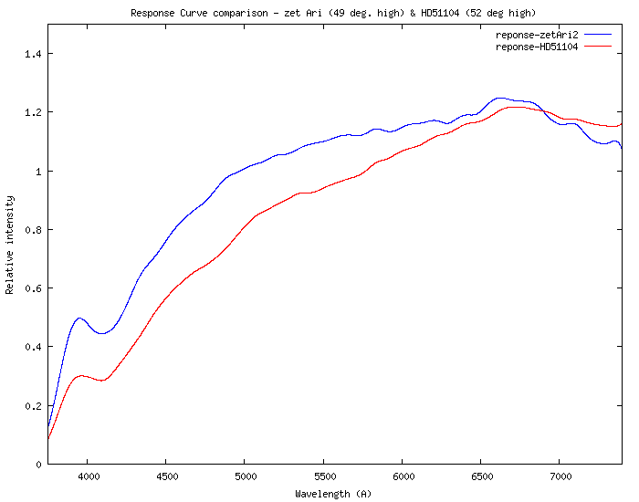

Now, here is my real problem. The picture below shows a comparison of the zet Ari (2nd observation) and HD51104. Spectra were not taken at the same moment - about 6 hours difference between observations - but stars were at the same elevation (49° vs 52°).
This time, I cannot say anymore that data are consistent.
And I have, of course, the question ; which one is the right one ?

as I know from my own experience, instrument response is a tricky business with a mount which is not tracking well. Looking at the difference between the response from zet Ari and HD51104 I notice that the difference is correlated to the signal intensity. This may hint at a problem with background subtraction or an offset in signal level (before dividing by the flat), but of course it may have a completely different cause. I noticed this with echelle spectra, but with an old Audela version, which has been corrected a while ago.
