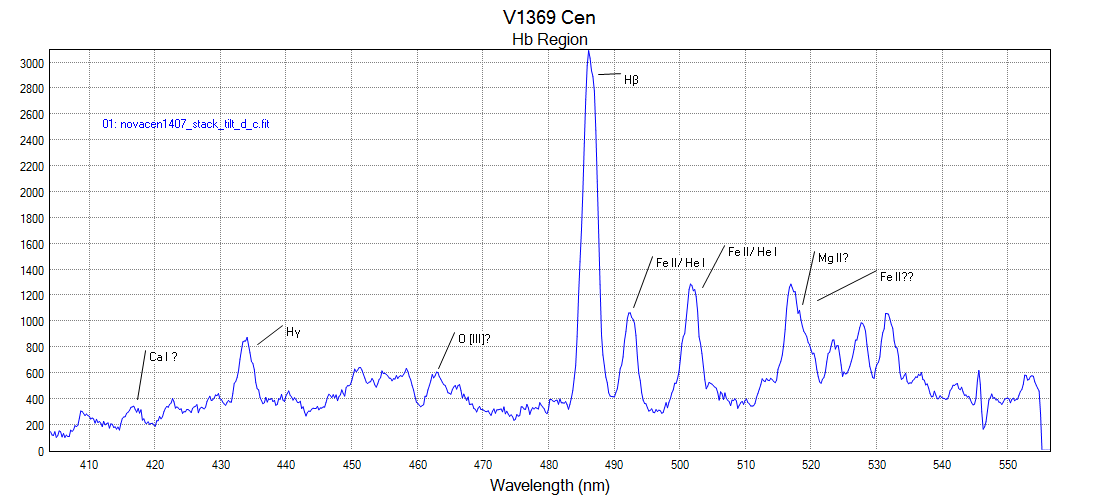

Using the Spectra-L200, 300 l/mm grating for approx. R=1000, Genesis 4" f5
The region around Hb continues to show strong Fe emissions.
Still processing the Ha - it appears to have reduced in intensity.
Re: V1369 Cen
Posted: Fri Dec 20, 2013 5:12 am
Good spectrum, Ken. Could you send the fit file for Aras Data Base ?
The spectral development is very similar to Nova Del.
As I said in AAVSO forum, at this stage, there's no [O III] line ; they will appear at the beging of the nebular stage.
[OIII] lines are 4363, 4959 and 5007
All the best

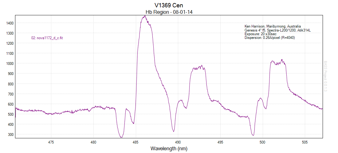

Posted: Wed Jan 08, 2014 3:22 am
by Ken Harrison
Hmmm

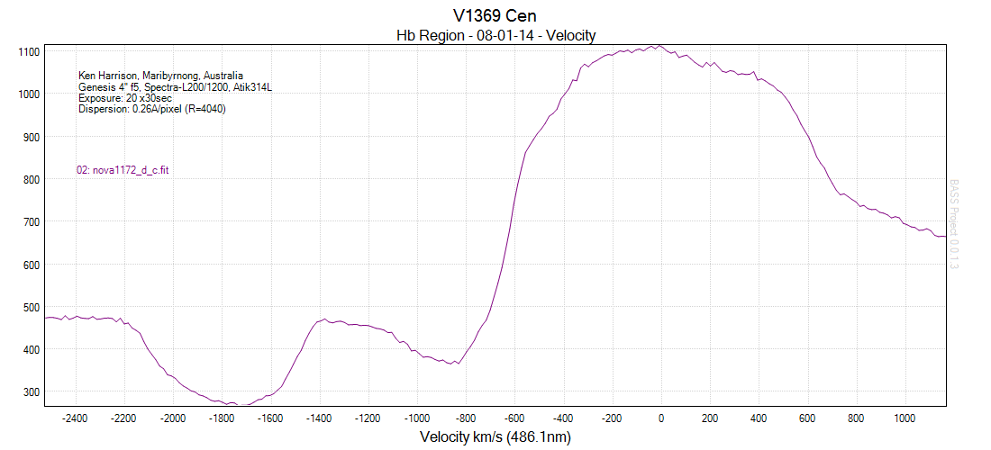

Now working at R=4040....
Could have done with more exposure time....
The Hb region is the first processed...showing the now "standard P-Cyg" in both the Hb and Fe lines.
I've run a velocity graph based on the Hb (4861A) showing the larger absorption is still around the 1600Km/s
Feedback/ comments welcome.
(Francois - I sent a fits file to you...did you receive?)

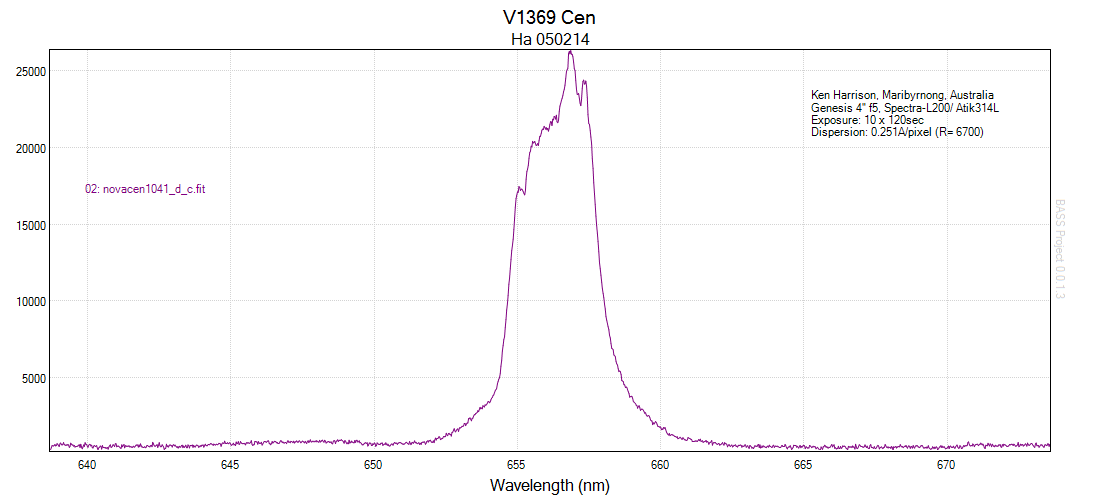

Posted: Wed Feb 05, 2014 4:51 am
by Ken Harrison
Very hot weather for the past few days (over 32 deg overnight!) stopped the observing sessions.
A bit cooler last night (28 deg)
The attached spectra show the absorption features beginning to show in the Fe and Ha. P-Cyg profiles certainly reducing.

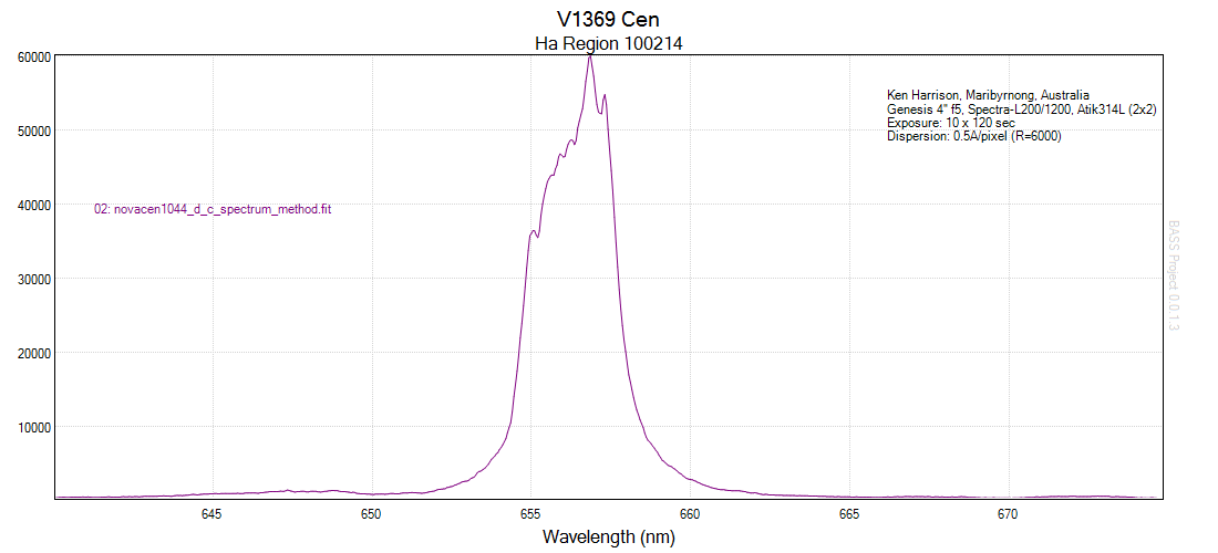

Posted: Sat Feb 15, 2014 5:48 am
by Ken Harrison

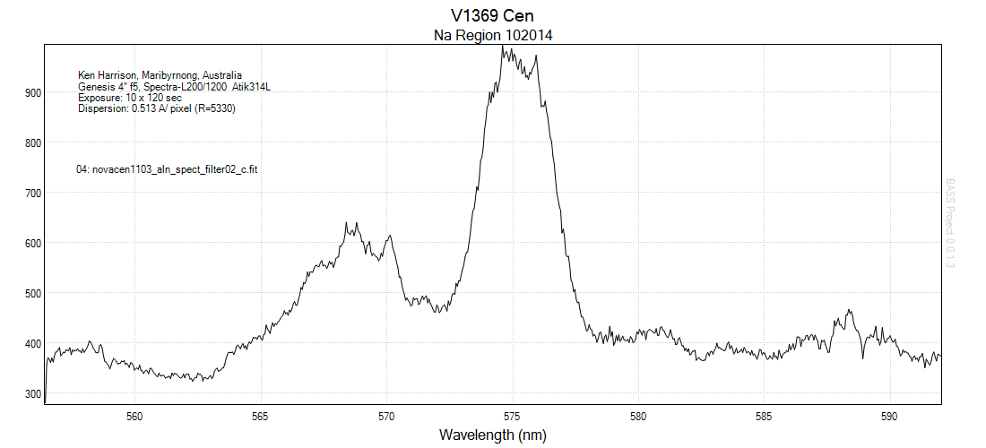

The observing conditions in Victoria, Australia have been very poor due to the horror bushfires and thick smoke haze we've been having.
Thankfully the loss of life has been minimal.
The attached spectra were obtained on the 10th Feb and show the current situation for the nova. The Ha emission is very strong.
just look at the ADU values!
some P-Cyg ?
some P-Cyg ?
still shows atmospheric absorption in the Na line?

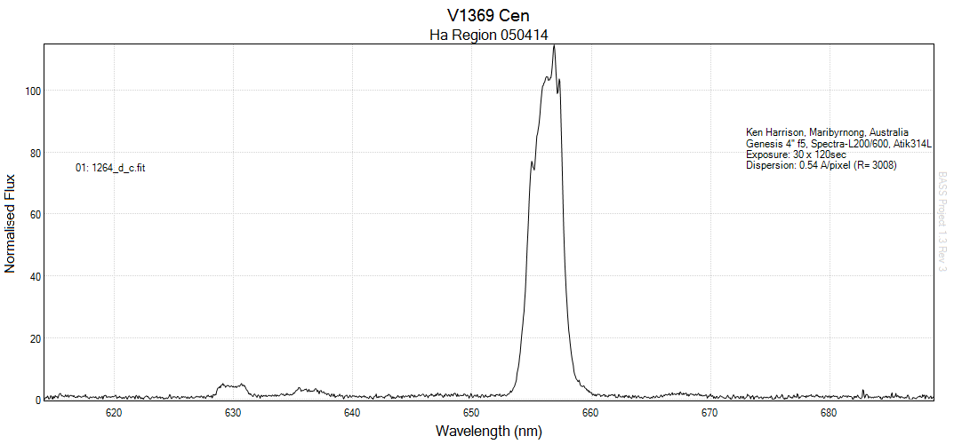

Posted: Mon Apr 07, 2014 9:42 pm
by Ken Harrison

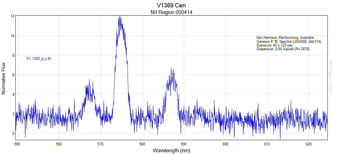

Some V1369 data from the 5th April.
Significant changes around Hb, the Fe "curtain" seems to have gone and the nebula phase starting?
NII/[OIII] now more intense than Hb - Fe disappears
Region around Na/NII
similar Ha profiles and intensity

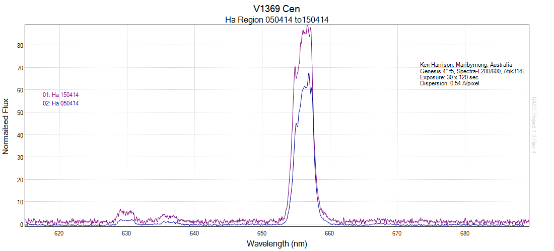

Posted: Tue Apr 15, 2014 11:14 pm
by Ken Harrison
Results from last night show the persistent Ha absorptions and the steady increase of the Ha emission.
Ha from 5th to 15th April

Posted: Mon Apr 21, 2014 12:14 am
by Ken Harrison
Here's the Hb Region from the 15th.
Hmmmm
I think the [OIII] at 4959 and 5007 are beginning to develop.
The others could be NII (5001), NIII (4638) and HeII (4686)
Growth of the [OIII]??
Every spectrum seems to show more and more features......
