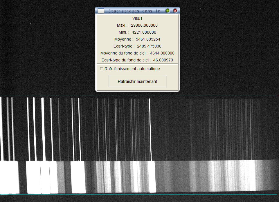

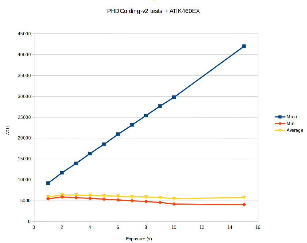

Robin, i also tested PHD v2 with Atik460EX on calibration light and you are right.
With 1s, 2s, ....15s exposure, the brightness did not change much but the background was getting darker.
Here are some results :
PHD did not give me any information about CCD temperature.
