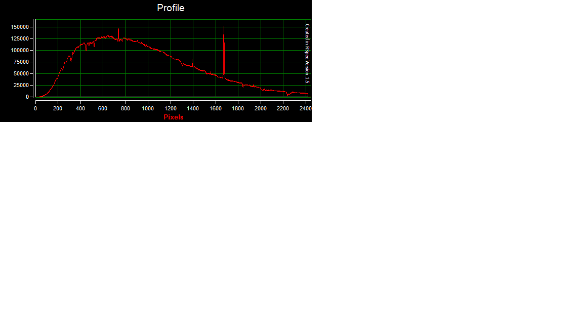

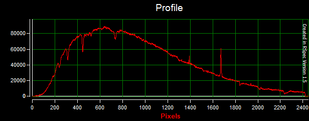

I find HD189847 / HIP98525 to be in emission. I can't find it in Bess database and Simbad has it as B7V. From a quick look at the references I see no indication of emission. I am now clouded out.
I also find the star HD192445 / HIP99667 to show emission in H alpha and H beta.
See attached
Regards Andrew
See attached
Regards Andrew
- HD192445
- HIP 99667 HD192445.png (13.47 KiB) Viewed 10452 times
- HD 189947
- HIP 98525 HD 189947.png (8.04 KiB) Viewed 10452 times

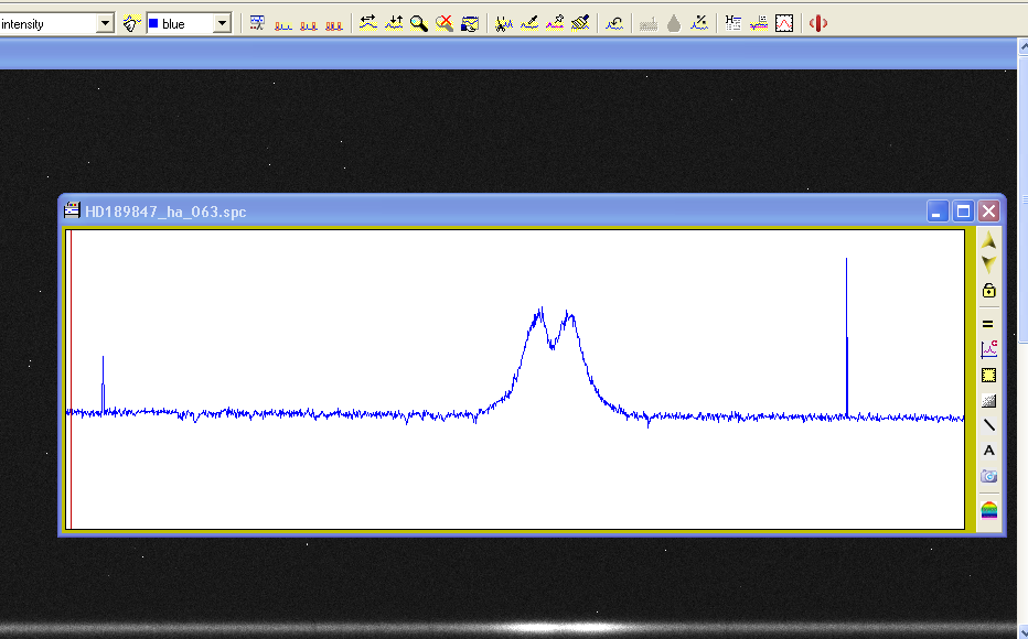

Re: HD189847 in emission
Confirmed (LHIRES 2400)
- HD189847_halpha_20140924.png (214.13 KiB) Viewed 10450 times

Please note I misslabled the images. The text has the correct star numbers.
Regards Andrew
