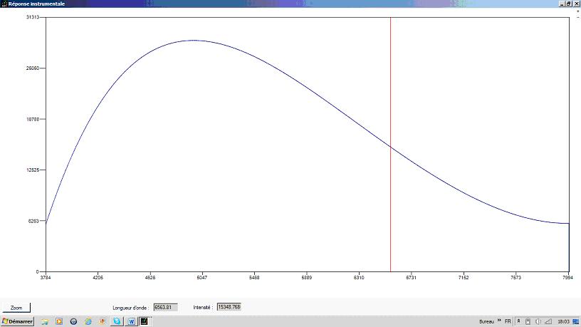

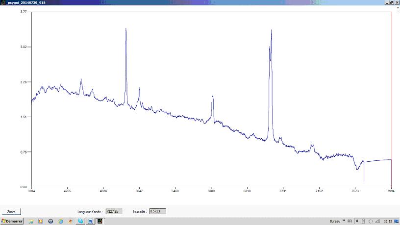

Post by Vincent Marik »
Thanks Miguel for your comment about the P Cygni spectrum ;) . I tried to do it take care of response calibration. This is what I obtain.
:?: Is that better ?
Thanks a lot for comments
Vincent Marik
Réponse instrumentale.JPG (24.41 KiB) Viewed 3857 times

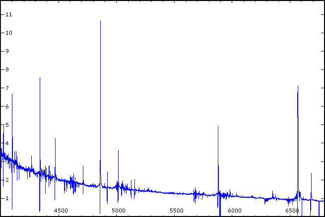

Hi Malik,
The instrument response correction looks pretty good
Here is a very high resolution spectrum from the ELODIE archive
http://atlas.obs-hp.fr/elodie/
for comparision
