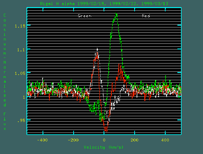

by Joan Guarro Flo
These are two comparasion Rigel graphics.
JG.

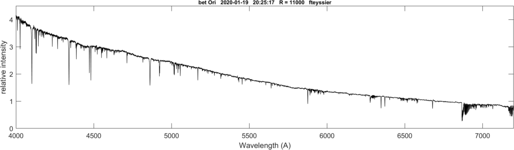

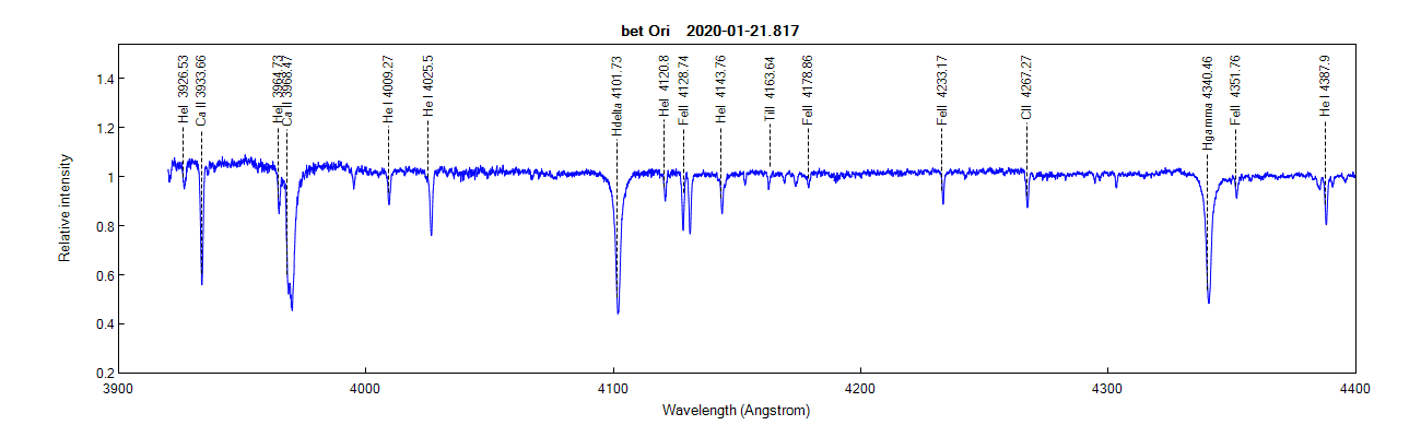

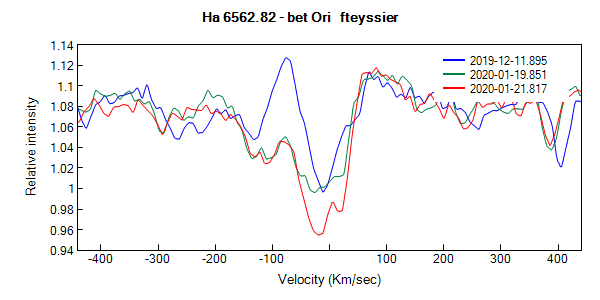

Posted: Sat Jan 25, 2020 6:38 pm
Echelle spectrum obtained on 2020-01-19
Lines identification:
H alpha evolution:
About H alpha variability, see e.g. Morrison+, 2008 :
https://publishup.uni-potsdam.de/opus4- ... icle34.pdf
Rigel is a hot, luminous star that is well known to
show mass loss. Studies of the Mg II resonance lines
have shown its terminal wind speed to be about
230 km s−1 (Kaufer et al. 1996b). According to
Gilheany (1991), Mg II in this star shows episodes
of increased mass-loss rate and edge velocity, as well
as DAC-like behavior. Hα is also well known to be
highly variable, with profile morphologies ranging
from P Cygni to double-peaked to inverse P Cygni
(Kaufer et al. 1996b, Israelian et al. 1997).
An easy and interesting target!

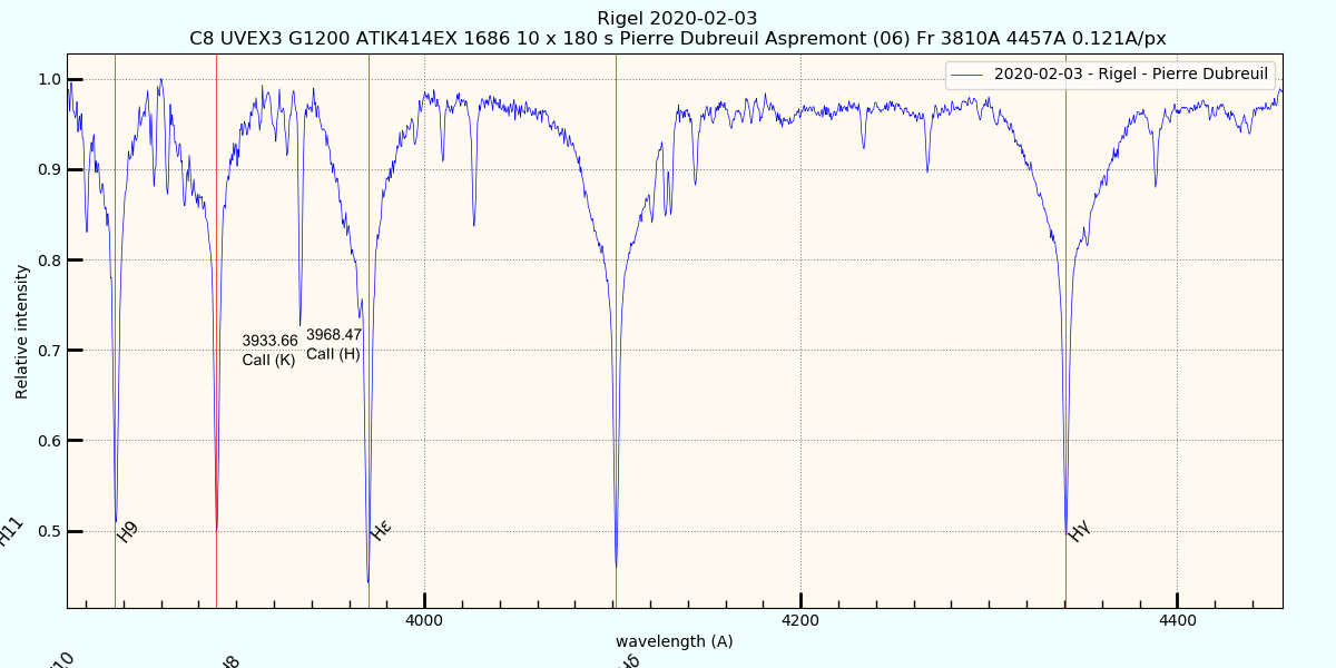

Bonjour à tous
Hier soir reprise spectro avec UVEX 1200tr/mm partie UV
Certes ce n'est pas de la haute résolution, cela reste informatif (ou pas :) ).
Le spectre a été normalisé par son continuum
Spectre3810 to 4456norm.png (112.47 KiB) Viewed 33033 times
Cordialement
