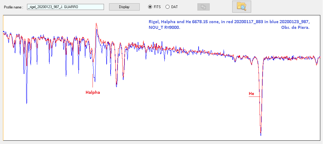

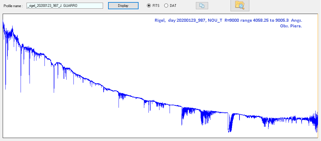

- Posts: 731
Re: Spectre à haute résolution de Rigel demandé
These are two comparasion Rigel graphics.
JG.
JG.

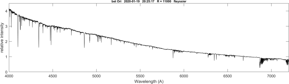

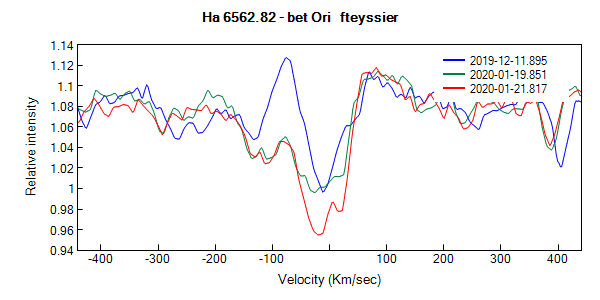

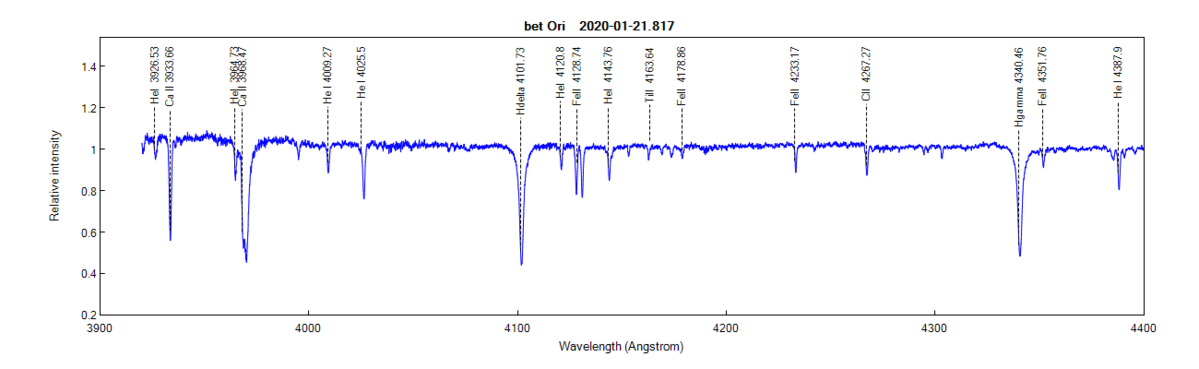

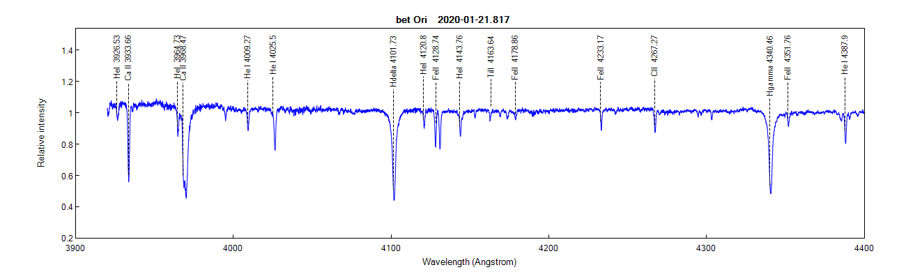

- Posts: 1562

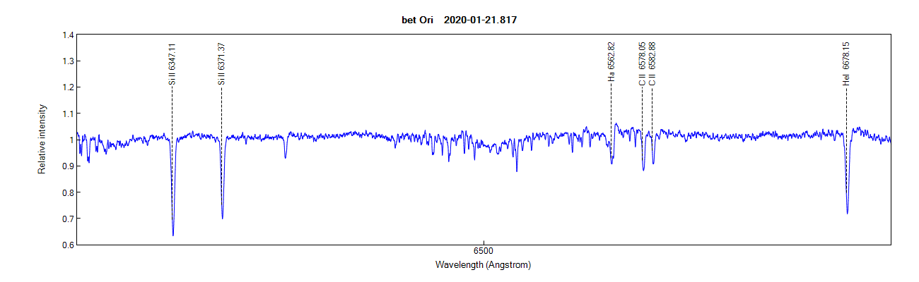

Echelle spectrum obtained on 2020-01-19
Lines identification:

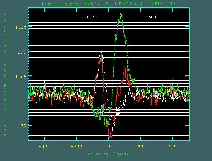

H alpha evolution:
About H alpha variability, see e.g. Morrison+, 2008 :
https://publishup.uni-potsdam.de/opus4- ... icle34.pdf
Rigel is a hot, luminous star that is well known to
show mass loss. Studies of the Mg II resonance lines
have shown its terminal wind speed to be about
230 km s−1 (Kaufer et al. 1996b). According to
Gilheany (1991), Mg II in this star shows episodes
of increased mass-loss rate and edge velocity, as well
as DAC-like behavior. Hα is also well known to be
highly variable, with profile morphologies ranging
from P Cygni to double-peaked to inverse P Cygni
(Kaufer et al. 1996b, Israelian et al. 1997).
An easy and interesting target!
H alpha evolution:

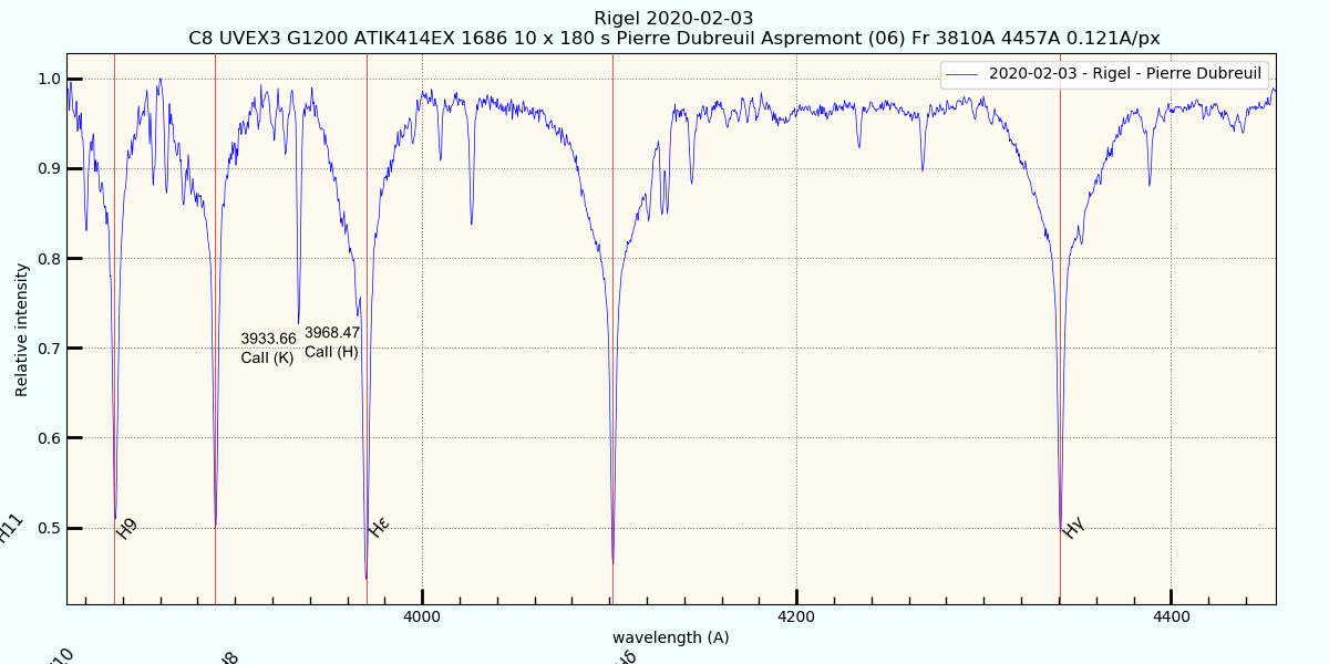

Hier soir reprise spectro avec UVEX 1200tr/mm partie UV
Certes ce n'est pas de la haute résolution, cela reste informatif (ou pas
Le spectre a été normalisé par son continuum
Cordialement
Cordialement
