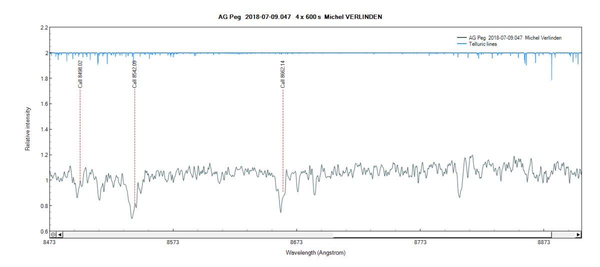

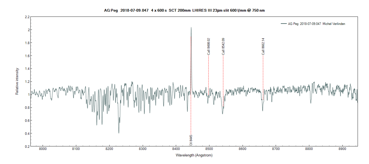

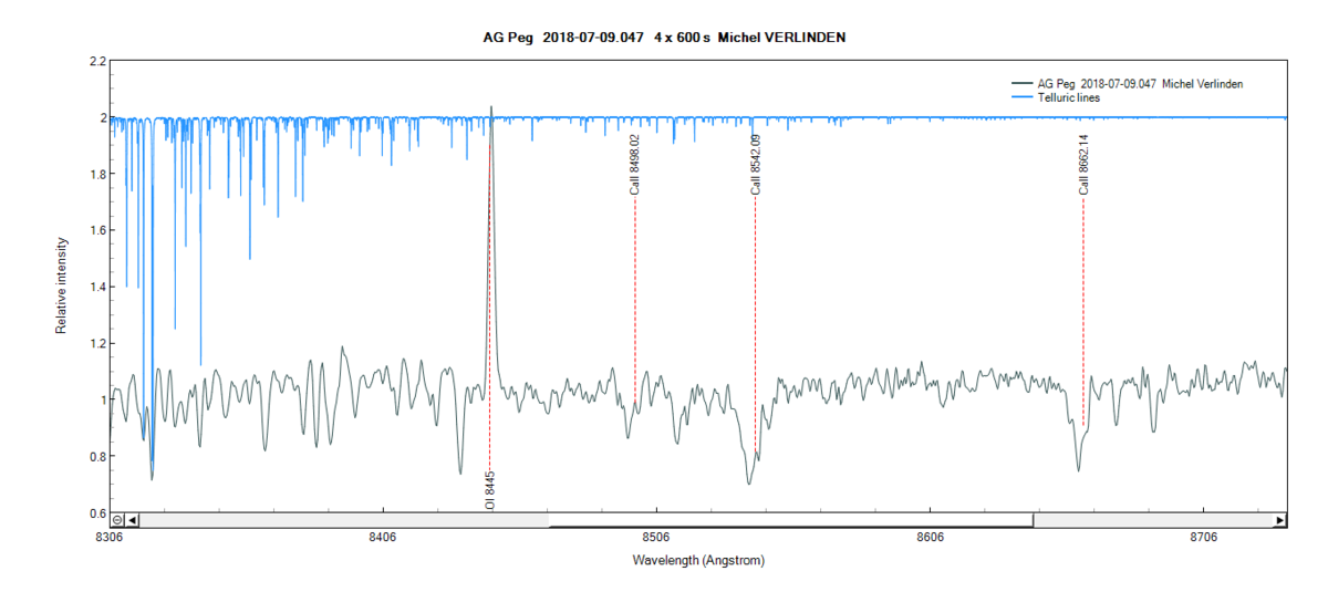

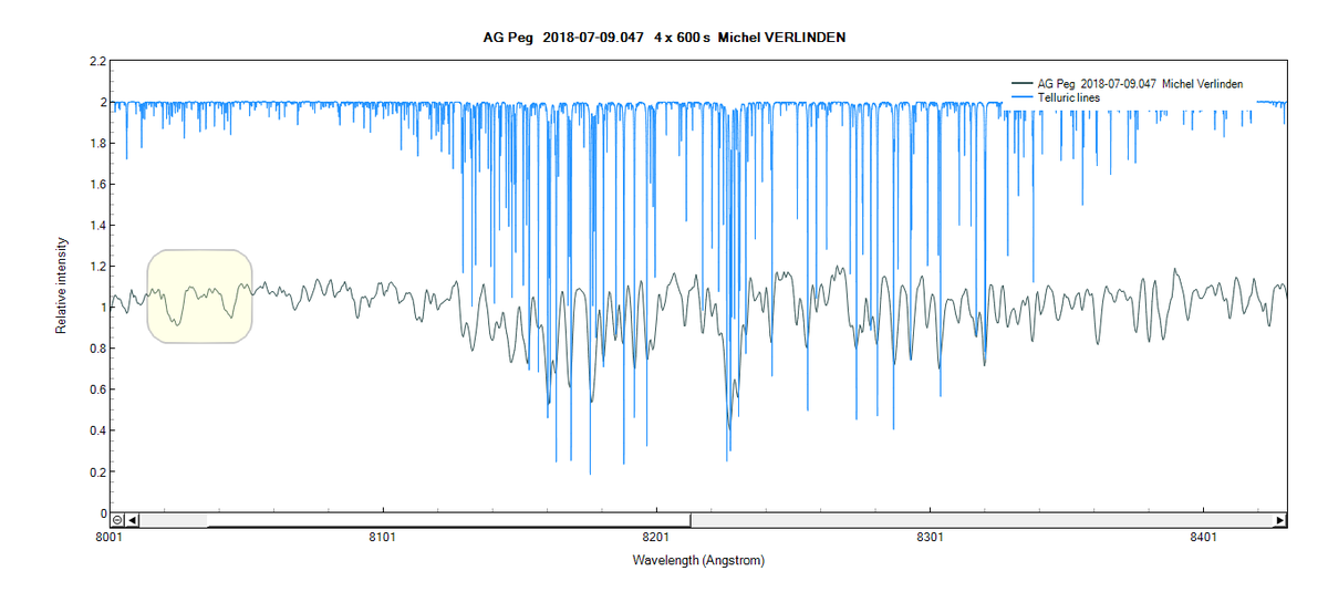

I captured spectra of AG Peg between 8000A and 9000A last night.
You will recognize a dominating OI emission line. It would be nice if someone could help me to analyse it, especially identify some elements and molecular bands. I join the data.
I didn't correct the héliocentric velocity (-20 km/s) and the RV of the target (-15.86 km/s).
Cheers.
Michel Verlinden
_agpeg_20180709_047_Michel VERLINDEN.zip
(10.05 KiB) Downloaded 526 times

Bonjour Michel,
C'est un résultat très intéressant et à une bonne résolution.
La présence de OI alors que les raies [OI] et [OIII] n'apparaissent pas dans le visible s'interprète par le fait que la densité électronique le la nébuleuse est suffisamment élevée pour emplêcher l'apparition des "raies interdites".
En ce qui concerne les bandes moléculaires elles sont inexistantes (ou très faible). AG Dra est une des rares symbiotiques dont la géante est de type K (K0 à K3) selon les auteurs
Le suivi de la zone IR est intéressante en complément du monitoring de l'étoile (minimum un spectre par mois) et durant le prochain outburst (printemps 2018)

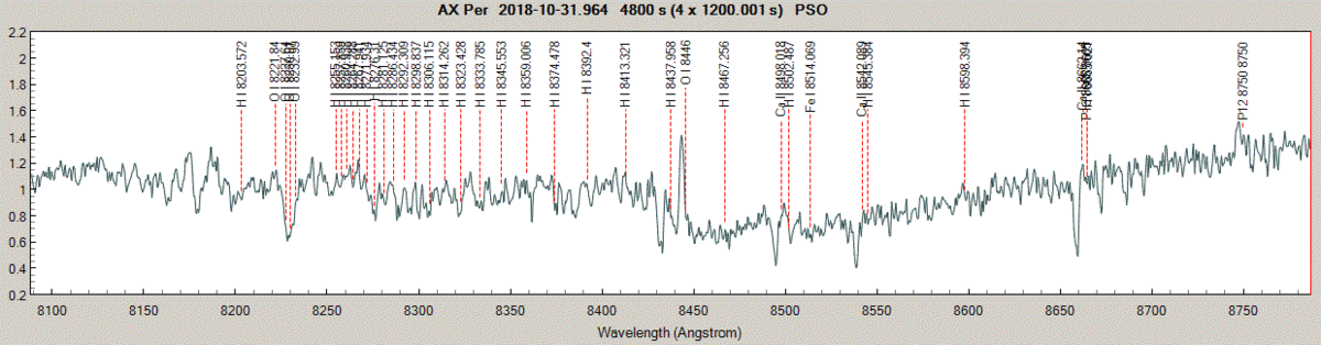

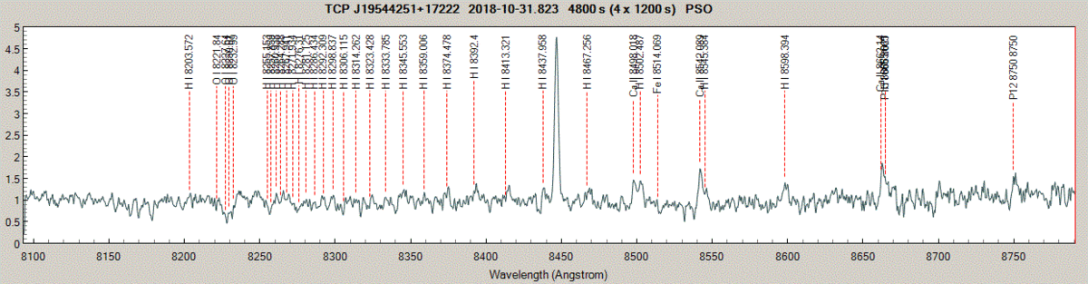

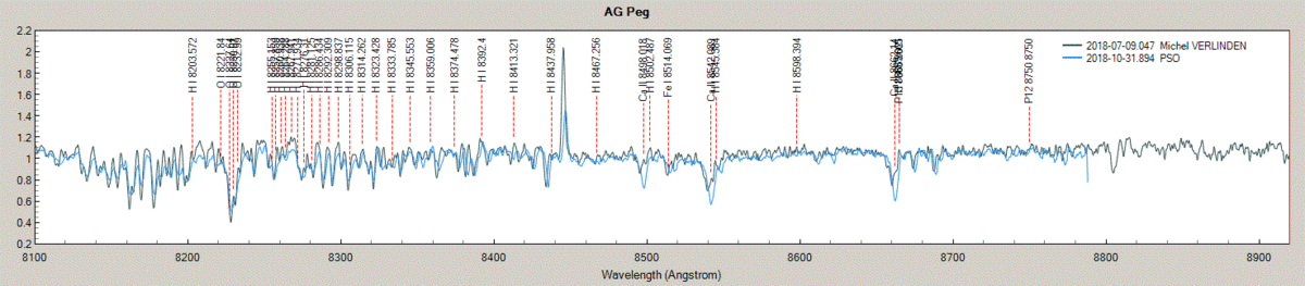

I have just managed to gather further results (Ca II triplet + O I 8446 region, but O I 7774-76 was left off, my ccd is not enough large), so let me extend this collection with further - mainly - symbiotics:
Changes to Michael Verlinden's AG Peg
My resolution was typically R~2700 (35 micron slit, LHires III + 600/mm Vis + Orange wratten filter directly on top of the ccd), lower than Michael's R~3688.

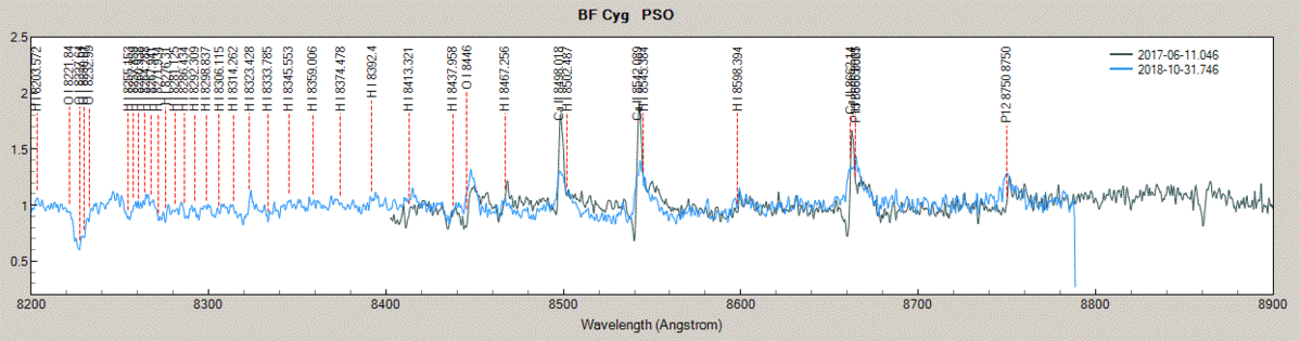

BF Cyg was suffered by defocus both (R~2200):

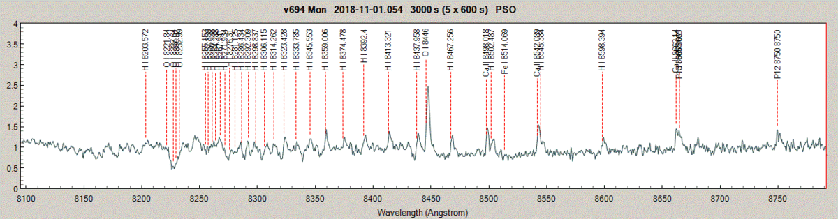

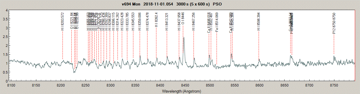

And, the one I was most curious (only 5 x 10 minute, of last covered by veily clouds):
v694 looks to be a good school example to see how the CaII and Paschen end overlap (the notation of H I .... and P 12,13 brought from VSpec via copy/paste), here all in emission.
The only unusual, that all the Balmer serie rather wide (like 500 km/s half width), but Paschen and CaII are so thin that here unresolved (R~2700). Possibly they are part of the outer nebula.
In contrast with BF Cyg, where these lines also play some role.

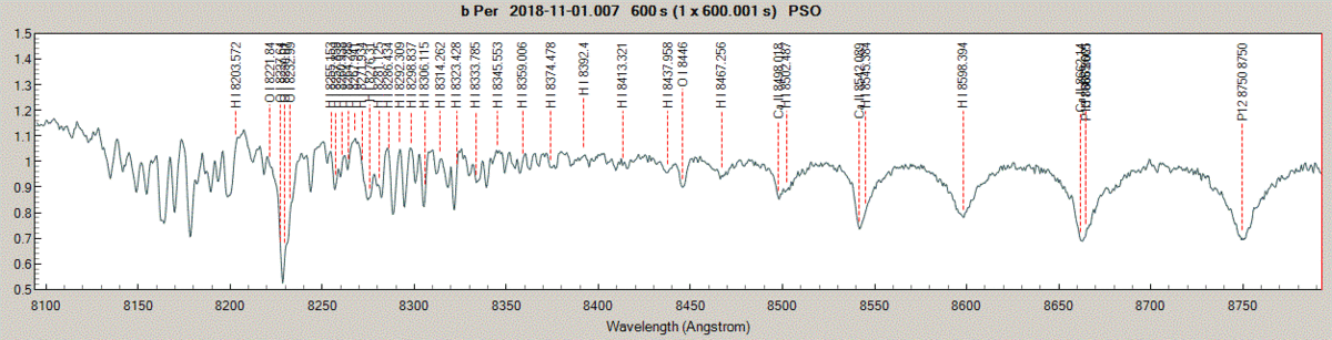

And finally, an experiment of b Per just to speculate where the 3rd star could show any mark:
However in this b Per case (as most common), the Paschen is showing similar characteristics as Balmer.
