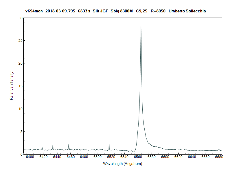

by umberto sollecchia
Bonjour à tous, placez le profil de l'observation du 09-03-2018. Umberto
v694mon_20180309_795_Umberto Sollecchia.png (21.47 KiB) Viewed 15792 times

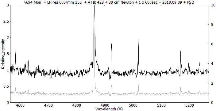

Posted: Sun Sep 09, 2018 12:21 pm
by Peter Somogyi
Opening the new season for v694 Mon: a fresh, lucky 1x10 minuter at the lowest level I can shoot v694 Mon from this morning - the P-Cyg profile has mostly vanished (a very rare state), uncovering a blue wing:
Fresh 1 x 10 minuter
Had to wait like 30 minute to rise above a tree, and had to move the next 10-minuter to trash because of too much sunlight contamination and poor guiding against rising sun.
The two wings confirmable visually on the raw image, and the removed background is a bit contaminated by the Sun's H-beta absorption (that is narrower than the wings).
I'd appreciate if somebody could confirm the existence of the blue wing, as once I've had hard times to prove such a validity for a professional.
- Peter
Re: V694 Mon revisted
Posted: Mon Sep 10, 2018 1:13 pm
Interesting, Peter
You've an the blue end of the line in faint emission
The last spectrum obtained by Umberto shows a very weak blue absorption
See
http://www.astrosurf.com/aras/novae/Inf ... 018-02.pdf
All the best

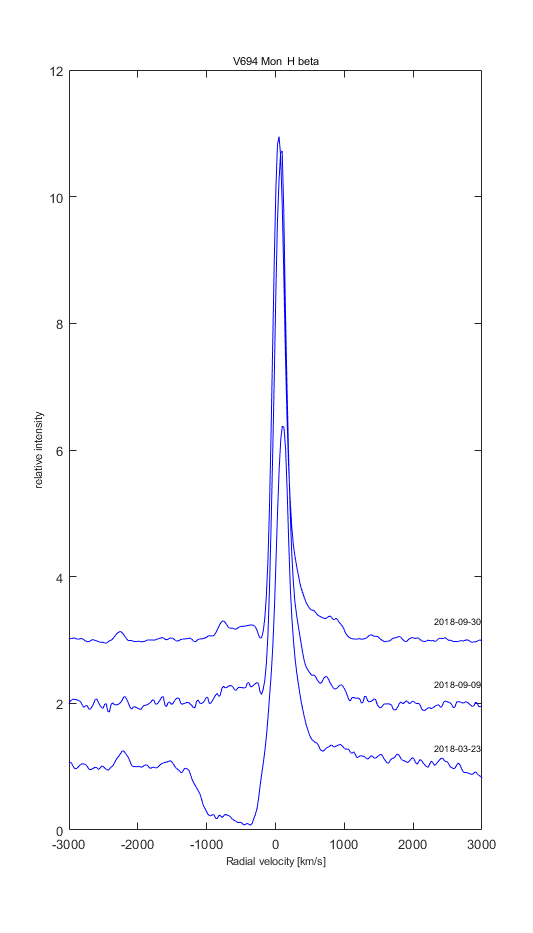

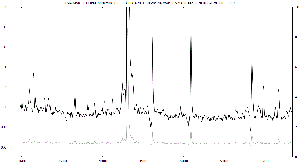

Posted: Sun Sep 30, 2018 11:38 am
by Peter Somogyi
Today morning's result - similar, in a better quality (5 x 10 mins):
This SNR would allow high resolution (maybe next time).
A narrow absorption is definitely still there (as previous result suggested).
- Peter

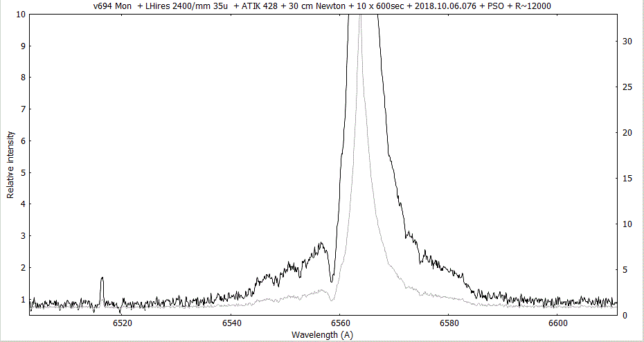

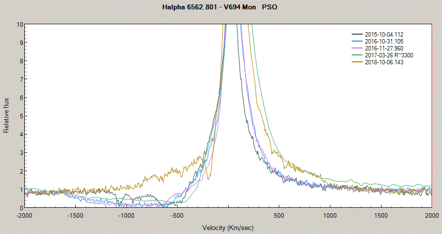

Posted: Sat Oct 06, 2018 1:00 pm
by Peter Somogyi
Fresh result from this morning, a similar structure at H-alpha - this time high resolution (R~12000):
A year-to-year comparative evolution (all spectra captured by me):
The plateu suddenly drops at -800 and +900 km/sec.

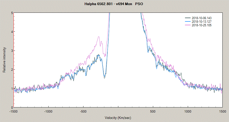

Posted: Thu Oct 25, 2018 4:26 pm

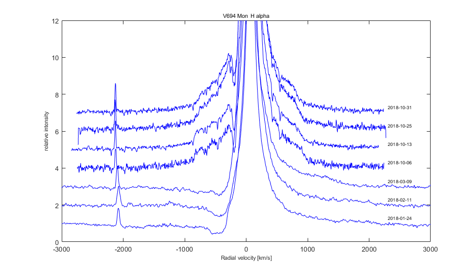

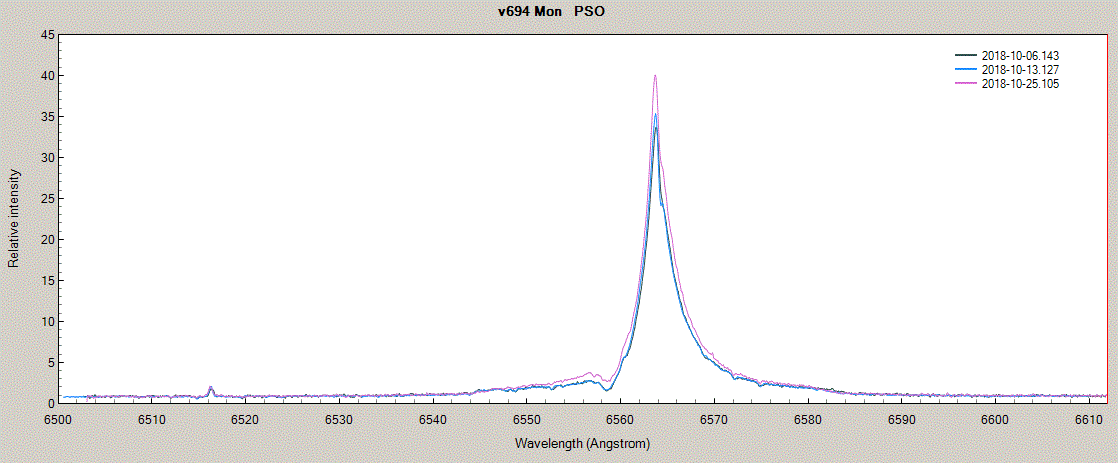

by Peter Somogyi
With a fresh result from this cloudy morning, presenting H-alpha evolution in the past few weeks:
The essence of changes require magnification + good SNR:
Although there have been no remarkable change between 10.06 and 10.13, the V wing has increased by now (whilst the R side remained proportional to the H-alpha intensity).
Perhaps (hard guess), a V-side peak is uncovering?
- Peter
Posted: Tue Nov 06, 2018 9:38 am
That's very interesting, Peter.
I don't remember such profiles in the various publications about V694 Mon
It could be interpreted as the weakening or loss of the jets
Of course, monotoring of MWC560 is strongly recommended.
H alpha and H beta this year from spectra obtained by Peter and Umberto
showing the sudden changes of the profiles.

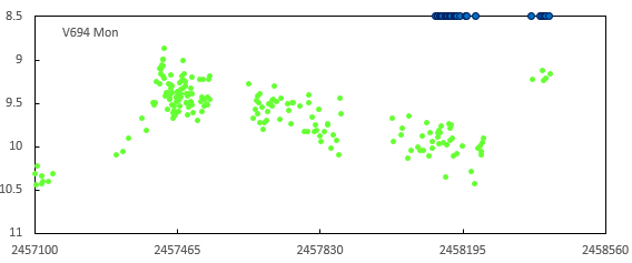

The lightcurve:
