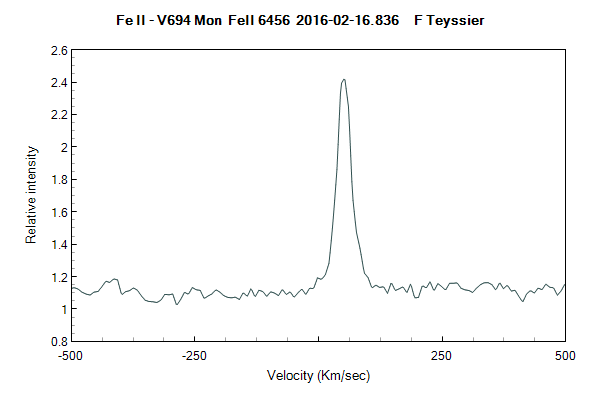

Only the *emission* component of metal lines - Fe, Ti, Mg ... - have a low FWHM (about 20 km/s, 40 km/s with a broader pesdestrial for Fe II (42) multiplet) and are considered to be produced essentially in the accretion disk, the nebula anf jet near the hot component of the sytem.
The absorption is mainly produced in the jet itself
Here's for instance Fe II 6456 in a spectrum obtained last year
FWHM = 35 km/s

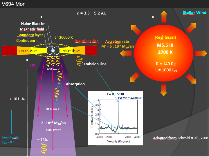

Following new questions, here's a model adapted from Schmid & al.
See also Shore & al. 1994, Tomov, 1992, 1997
The wind from the red giant (sollar type matter) forms an accretion disk around the magnetic white dwarf of low luminosity
The magnetic field acts as an propeller to form the jet
The boundary layer, the viscosity of the disk heat the upper layers of the disk at about 20 000 K which provoques ionisation (low ) of H and metals, essentially one time ionised
The narrow emission lines of hydrogen and ionised metals (Fe II, Ti II, Cr II, Si II ..) are emitted from a large part of the disk. These are narrow lines. From a spectrum obtained two days ago, I get FWHM of 30-35 km/s for most of the lines. Only Fe II 42 multiplet gives broader lines (50 km/s).
The jets is formed by the solar ionised matter (at least at the begining). The recombination time is long.
So the ions can absorbe the photons of the continuum at the blue shift wavelenght produced by their velocity. This is the reason why the absortions are much wider than the emission. They are not formed in the some region of the sytem.
For Fe II (42) about 25% of the photons of the continuum are absorbed. While HI can absorbed about 75% of the photons due to its higher column density.

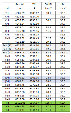

Here's the measures of a few lines that I obtained with the excellent Tim Lester's PlotSpectra All the best,

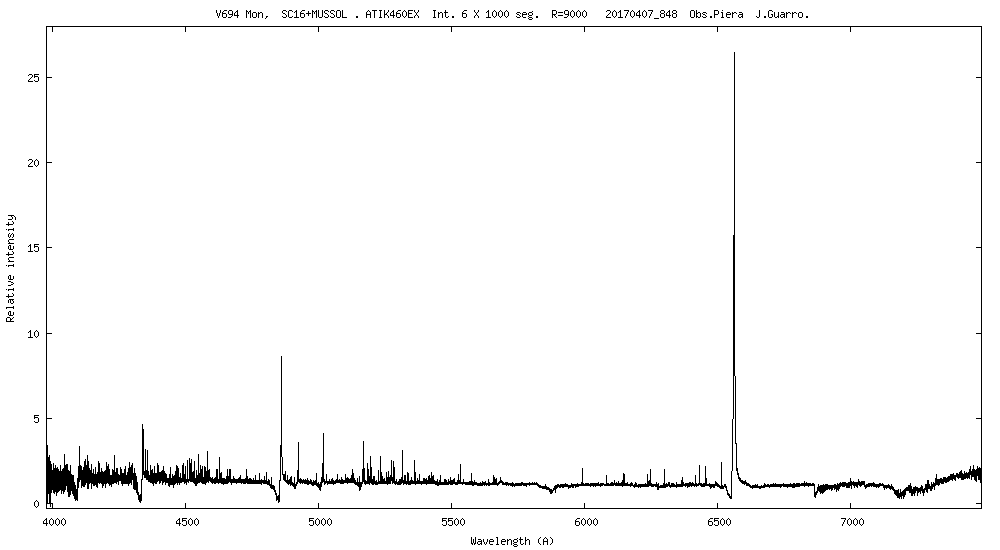

- Posts: 731
Re: V694 Mon revisted

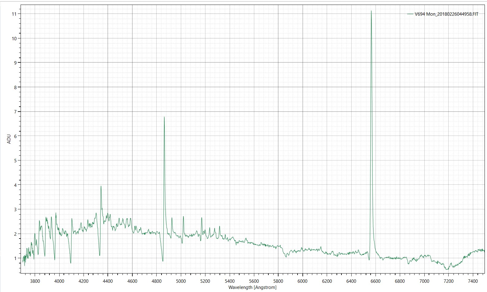

This is a new spectra of V694 Mon.
Cheers, Joan.
Cheers, Joan.
- _v694mon_20170407_848_J. Guarro.png (7.17 KiB) Viewed 20476 times

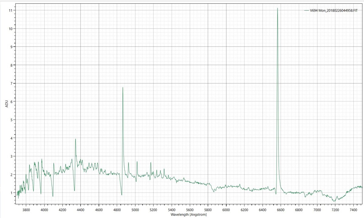

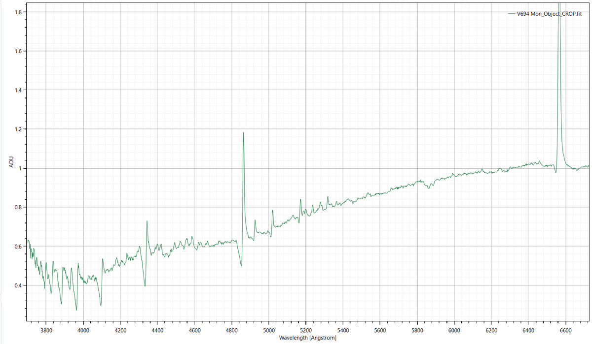

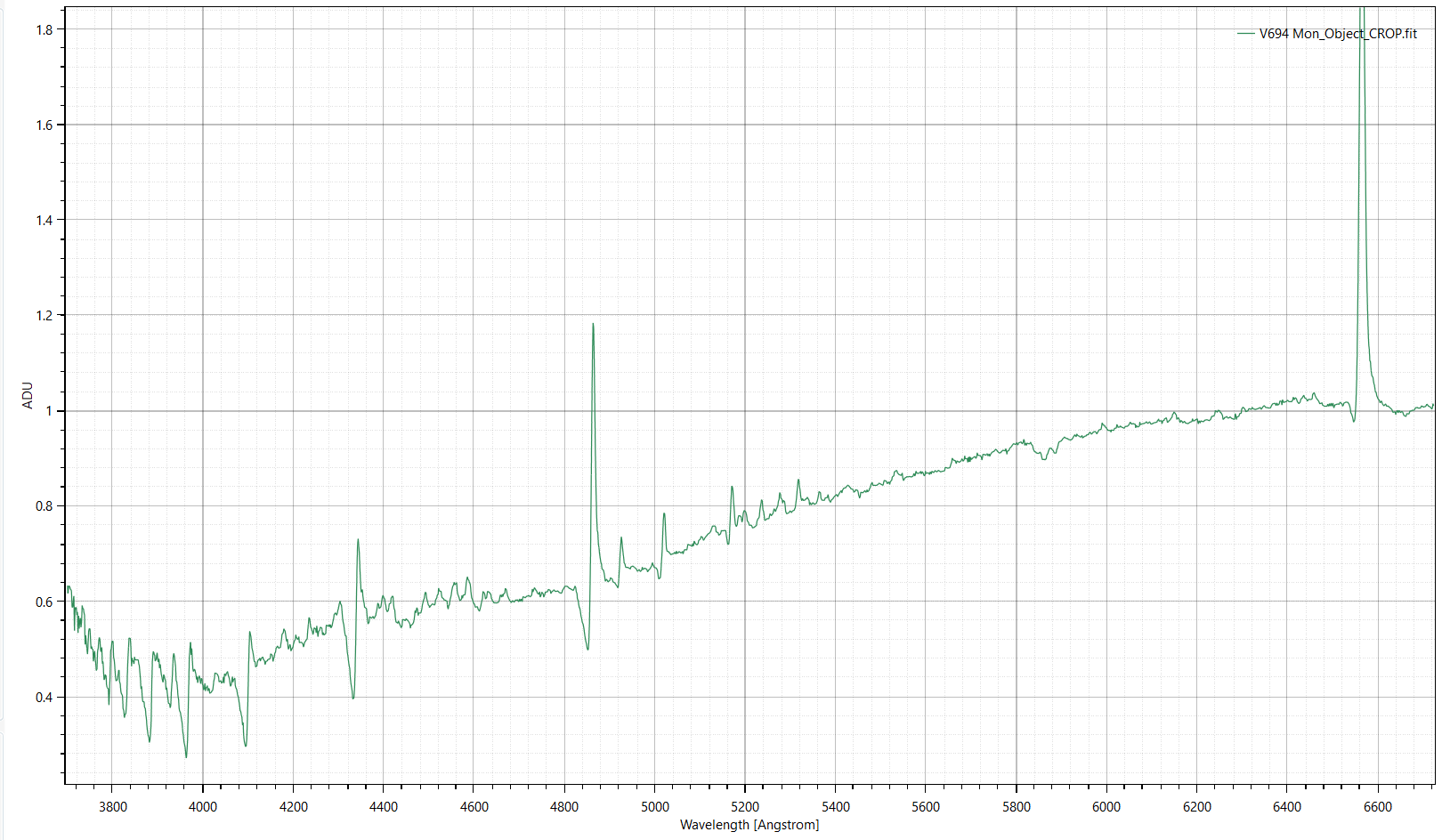

My first attempt at V694 Mon. 9 x 300 s
Looks like the Red Giant is showing itself (or my instrumental response isn't so good; C Hydrae is the reference)
The broad absorptions seem to get narrower with increasing wavelength. Is that because shorter wavelengths are produced near the center of the disk,which results in more coverage by the jet = more dispersion of velocities?
Does the Red Giant account, in part, for the small H-alpha absorption?
Thanks.

Il y a beaucoup de choses à observer et à comprendre. Beaucoup de questions. Merci Francois pour le dessin.

- Posts: 1562
Bonjour James,
Le spectre est très bon au niveau de la résolution.
Effectivement, la correction atmosphérique n'est pas bonne. Voir les derniers spectres obtenus par David et Woody:http://www.astrosurf.com/aras/Aras_Data ... 694Mon.htm
pas facile de trouver une bonne étoile de référence dans cette région
del Mon est brillante, mais un peu trop haute. Son spectre peut être obtenu avant V694 Mon de façon à faire coïncider les hauteurs
voir aussi HD 49147 Bonne continuation

Merci pour le schema explicatif c'est top !
- Posts: 458
Thanks to Francois Teyssier for the beautiful graphic on this interacting symbiotic!

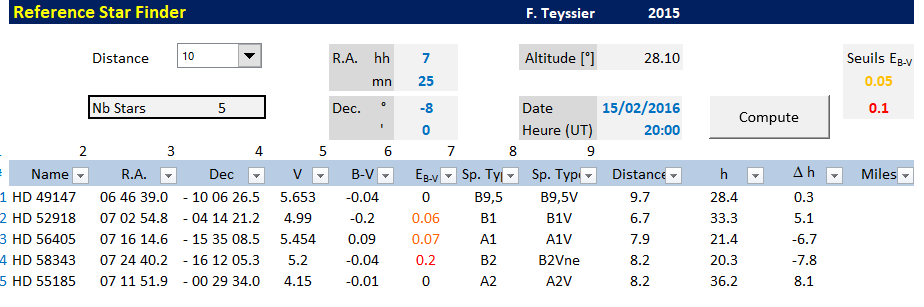

Merci François. Le spreadsheet ReferenceStarFinder sera très util. Je n'ai pas traité ce specturm avec ISIS et je pense que la réponse instrumentale n'était pas correcte. J'ai essayé encore et bien que la réponse soit meilleure, je ne pense pas que cela corresponde parfaitement à la référence A0V. Je vais essayer à nouveau avec ISIS et choisir une autre étoile la prochaine fois.Francois Teyssier wrote:Bonjour James,
