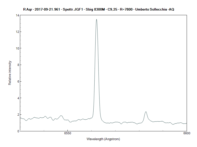

Posted: Mon Sep 25, 2017 10:58 pm
by umberto sollecchia
Bonsoir à tous, voici ma contribution. Umberto
raqr_20170921_961_Umberto Sollecchia.png (18.93 KiB) Viewed 11822 times

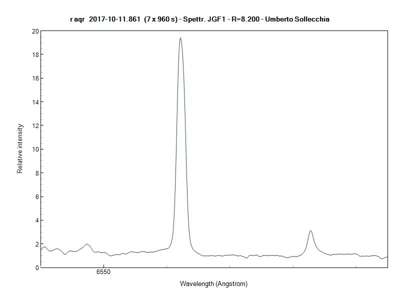

Bonne journée à tous, ma collaboration avec l'observation du 11-10-2017.
raqr_20171011_861_H-alfa-Umberto Sollecchia.jpg (63.56 KiB) Viewed 11707 times

by Olivier GARDE
Last observation of R Aqr last night.
All emissions lines increases like H alpha
