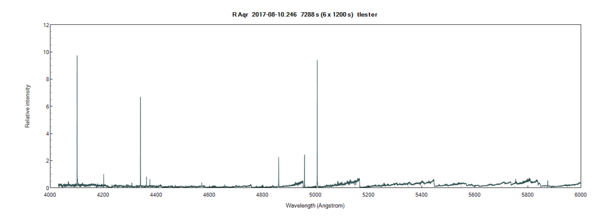

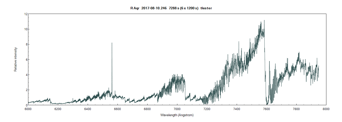

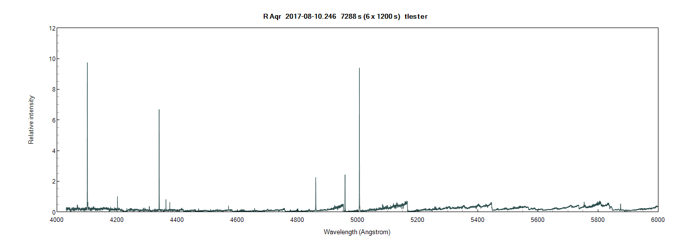

Re: R Aqr spectra requested by Margarita Korovska
Post by Tim Lester »
My attempt at this star on Aug 10th. About as low as I can reach from my location (unless I cut the tops off some of our trees).
I am pleased with the signal to noise I was able to get in spite of the poor seeing at this low altitude and the lower slit efficiency.

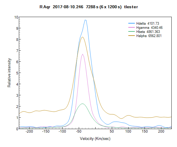

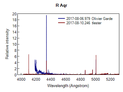

Hi Tim,
I think you have the same problem on your spectrum than on mine (below 4500 Å). That why I crop my spectrum at this wavelength
I don't think that H gamma and H delta can be greater in flux than H beta and H alpha.
Because the continuum is very low in the blue of the spectrum, the relative intensity of emissions may be false.
Maybe it is real but strange because in principle the Balmers Lines progressively decrease from red to the blue and therefore H Delta must be lower than H gamma it even lower than H beta and H alpha.
Maybe "pros" astronomer could give us information on this ?
Olivier,
Tim's spectrum is correct
R Aqr is D type symbioctic, with a Mira as giant
In Miras spectra, the Balmer decrement is abnomalous, with H delta as the main emission line
see
http://www.astronomie-amateur.fr/feuill ... Miras.html
or
http://www.astronomie-amateur.fr/feuill ... ctres.html
The abnomalous Balmer decrement was first expalaine by the TiO absorption.
Modern theory claims that the lines are produced by chocks in the pulsating atmosphear. The strenght of the lines depend of the deepth at which are formed the lines (optical deepth accompts)
Note that all the lines, comprising Balmer lines are narrow. Their origin is the Mira atmosphere and wind
François,
Thank you for this explanation.
So my spectrum is good also below 4600 Å.
Olivier,
Good for calibration and the shape of the lines, notably H gamma
But not for the atmo/instrumental correction. The continuum is too high and thus give an anomalous heigh for H gamma
raqr_20170806_979_Olivier Garde.png (10.89 KiB) Viewed 15353 times
Amicalement,
I will try to do better next time, but these last nights, I have a lot of mist on the horizon and variable sky conditions....
