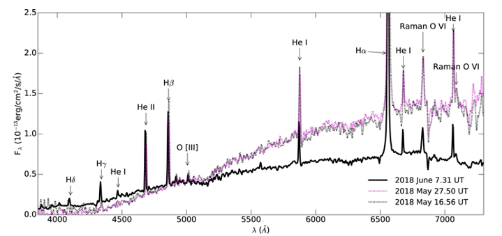

1. Research note of the newly identified yellow symbiotic Hen 3-1768 (≡ASAS J195948–8252.7), based on spectra obtained by Terry Bohlsen. Congratulations to Terry!
http://iopscience.iop.org/article/10.38 ... af71c/meta

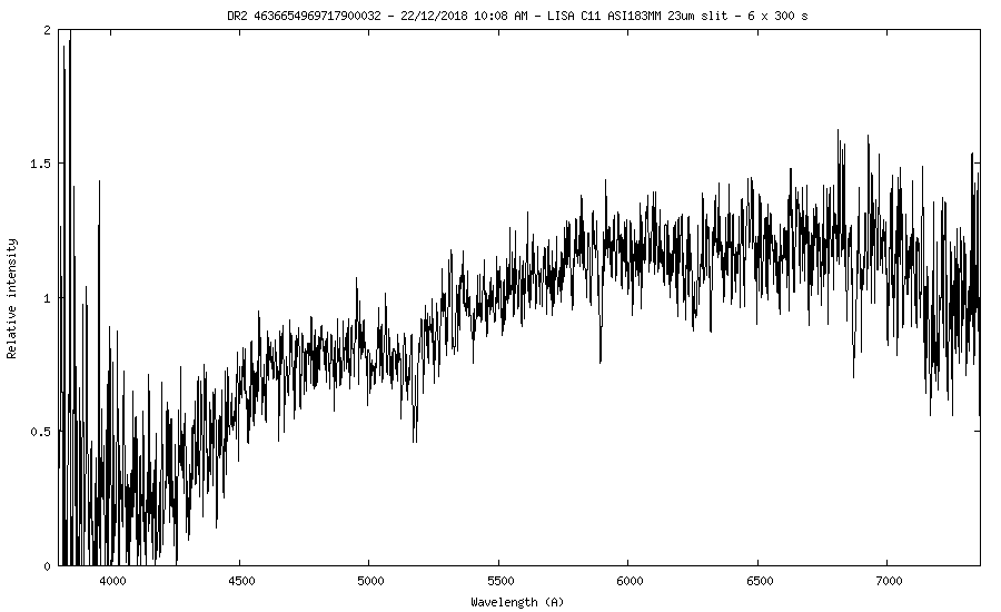

We have had poor weather in December so I haven't been able to do much observing. I did have some clear skies last night but with a full moon.
I observed GAIA DR2 4636654969717900032 which I have observed before. It is a mostly flat featureless spectrum.

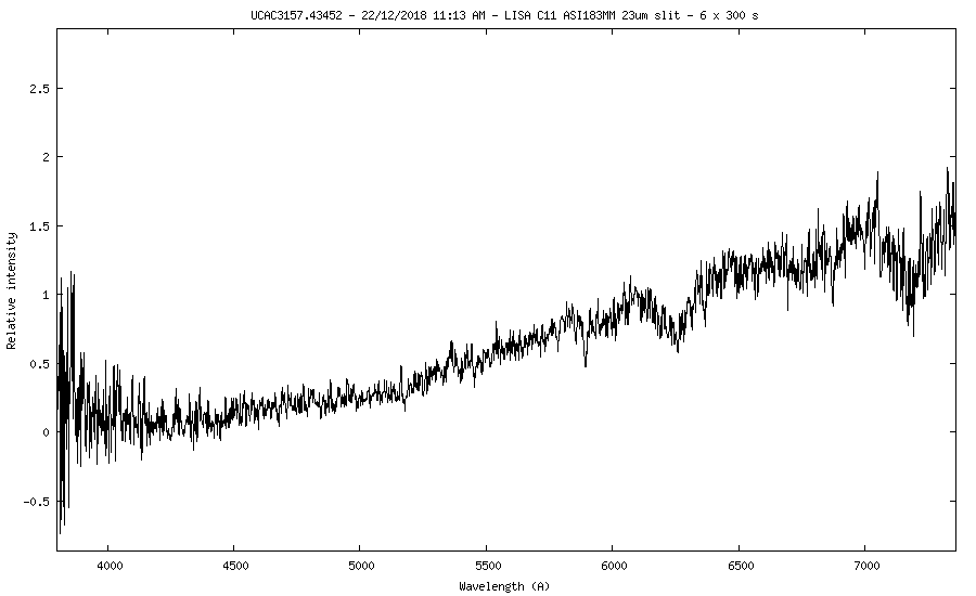

I also observed the second star on the list without a name but it is UCAC3 157:43452 at mag 12.3 in CMa.
It shows some features but no emission. Both were 30 mins of exposure. More time is probably needed but since there wasn't any emission I didn't persevere.

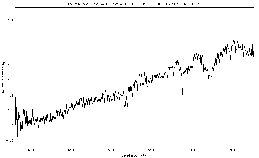

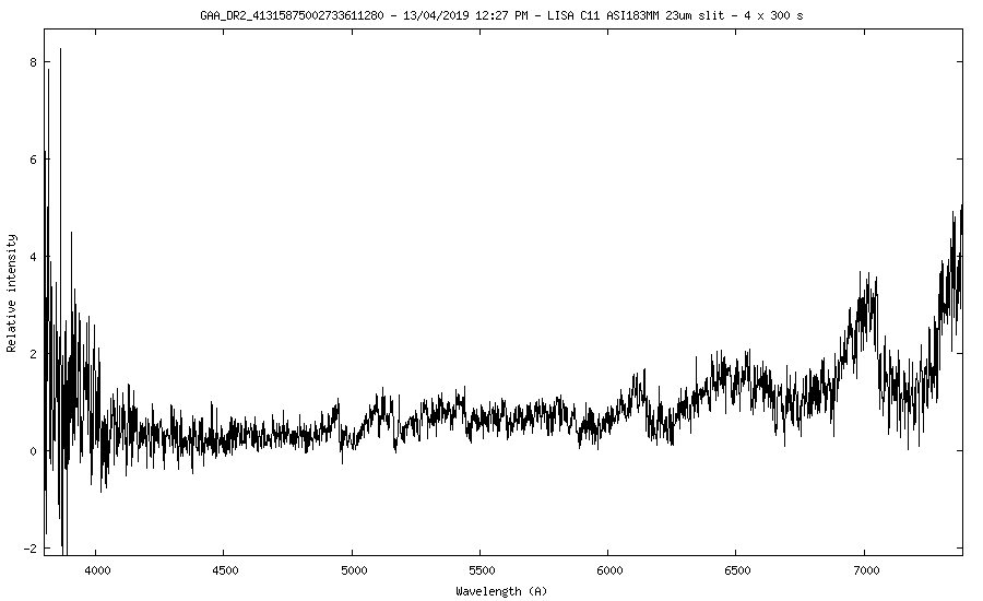

These stars are starting to become visible in the evening again. I have taken spectra of 2 further targets.
GSC9507:2249 which is the 6th star on the list with no name.
GAA_DR2_41315875002733611280
Terry
