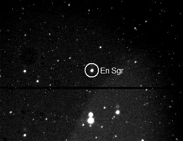

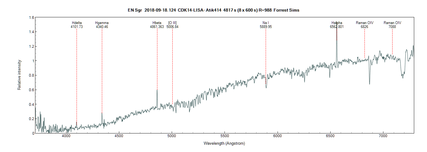

I chose EN Sgr last night to see if I could get a spectrum. As you might have noticed all of these targets have a big fat (-) minus sign in front of the DEC. Makes me think they are made to order for Paul Lukas:) Add in the position of the Moon, the magnitudes and that many of these targets are setting in the west early in the evening reduces the candidates I can reach here from southern Arizona. I took 8 600sec images of EN Sgr with my LISA using HD214994 as a Reference star.
Here is a plate solved guider image of the field and the results displayed in PlotSpectra. Some preliminary analysis by François and Adrian Lucy point in the direction of this possibly being a Carbon Mira type star.

Or for Terry who added two spectra in the base: http://www.astrosurf.com/aras/Aras_Data ... pected.htm
Another spectrum of EN Sgr confirms Woody's observations: Balmer lines in emission, but no sign of high ionization lines (He II, [OIII], [Fe VII], [Fe X], [Ca V], Raman OVI)
The Balmer decrement is normal. The continuum evoques a C star, but flat.

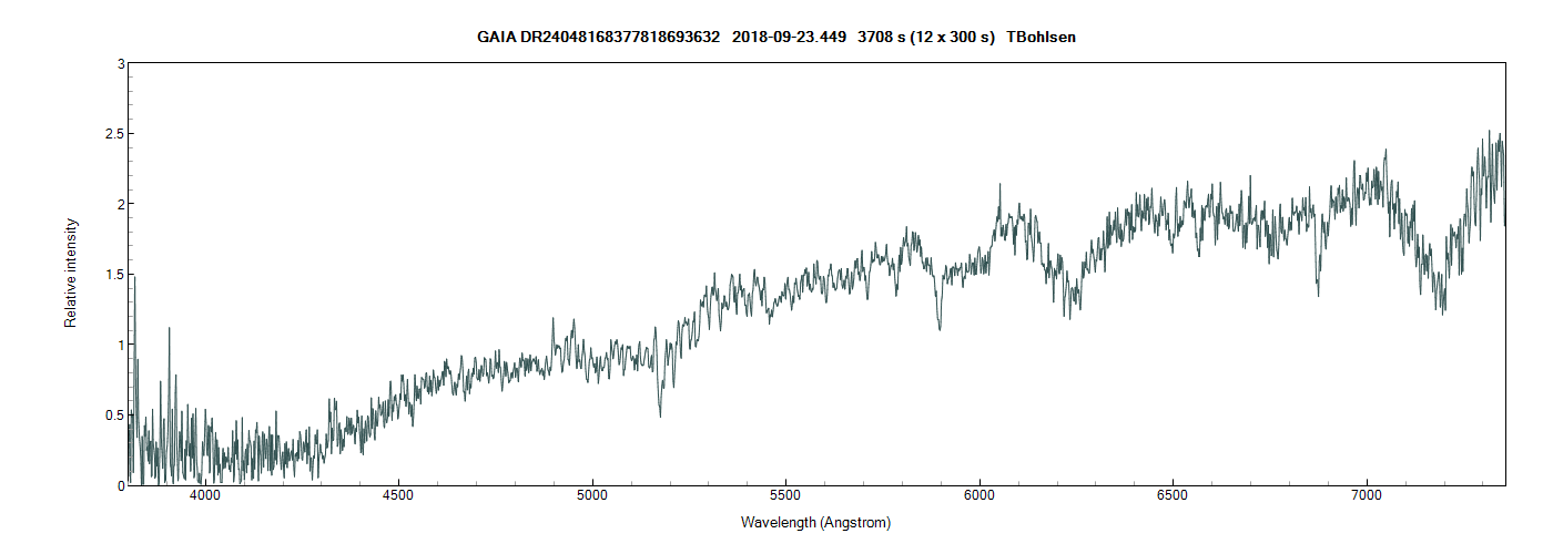

I've taken a spectrum of another candidate on the list. This one in Sgr.
GAIA DR 24048168377818693632. No emission lines are visible but lots of close absorption lines.

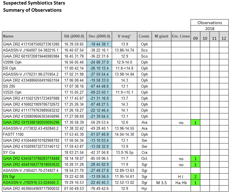

The summary of the campaign - current status: http://www.astrosurf.com/aras/Aras_Data ... tedLog.htm
In blue: targets observable from northern hemisphere (low but possible)

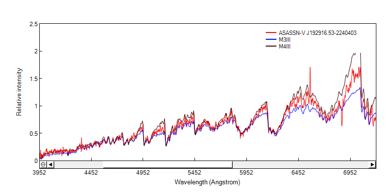

ASASSN-V J192916.53-2240403 obtained by Woody Sims with LISA
M3.5 continuum, H alpha and H beta (normal decrement)
A promising candidate
asassn-vj192916.53-2240403_20180921_153_Forrest Sims.png (41.7 KiB) Viewed 4668291 times
Blue and Black: MIII3 and M4III Pickles

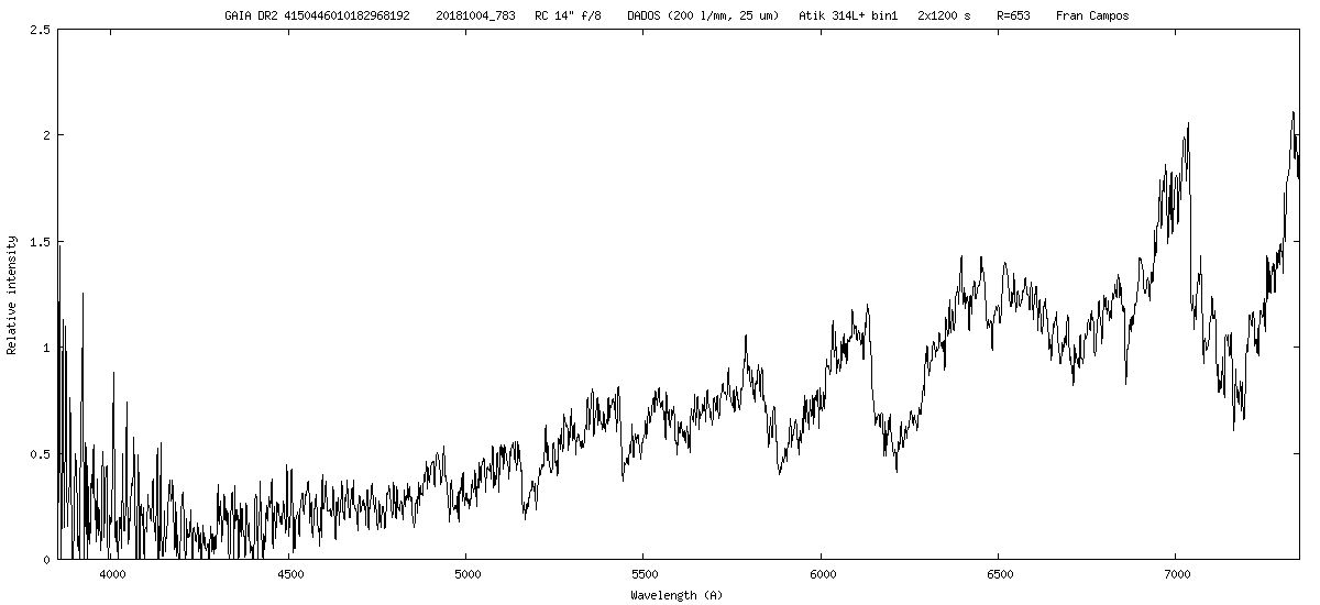

after a long absence, I tried to take some spectra of these suspected symbiotic star. They are very faint and bad placed to my observatory and, after trying with two different stars and avoiding guidage problems with PHD2, only with GAIA DR2 4150446010182968192 I could obtain something decent. With the other star (GAIA DR2 4150099732733246112) the spectrum I could obtain was too faint, although there were no emission signals also).
This suspected doesn't show emission lines

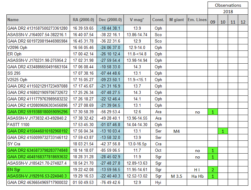

Re: Suspected Symbiotic Stars: campaign for Adrian Lucy
Excellent result on a faint target, Fran!
The continuum evoques a M4 giant
Update of the journal:

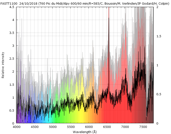

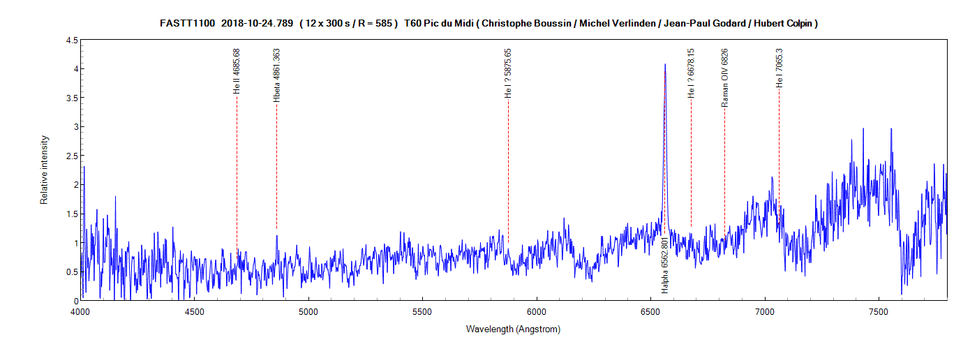

During our mission to the Pic du Midi from 22 to 26 October 2018, our team (Christophe Boussin, Michel Verlinden, Jean-Paul Godard and Hubert Colpin) was able to obtain, thanks to the 60 cm telescope and an Alpy 600, a first spectrum of the suspected symbiotic star FASTT 1100 of magnitude 14 !!
The following spectrum was obtained on October 24, 2018 at 18 h 56 UT (JJ = 2458416.311) with a resolution of 585 and an acquisition time of 60 min (12 x 300 s).
FASTT1100 on October 24th (T60 Pic du Midi / Alpy 600)
_fastt1100_20181024_789_Christophe Boussin_4000_7800_T60.png (142.42 KiB) Viewed 4667780 times
The observation conditions were not optimal (full Moon, low height of the target above the horizon) but it's possible to recognize without ambiguity the hydrogen Halpha and Hbeta lines in emission while the Helium HeI lines at 5876 and 6678A remain very uncertain.
The other lines are mentioned for information only...
