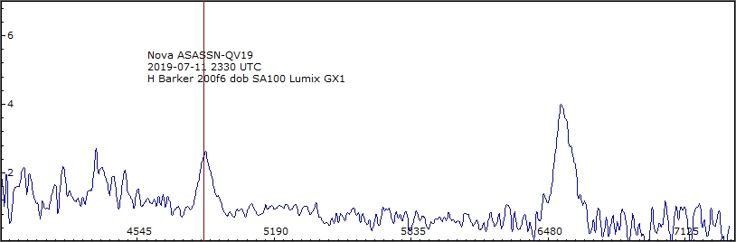

New spectrum from last night. Had some issues with moonlight, mount and drive rate, and possibly haze, as the sub exposures seem a bit dimmer.
I think the calibration from my previous one was incorrect due to an automatic function in ISIS.
Does any know if there is a section on Bess database for nova spectra? (when I get my data quality sufficiently improved).
(updated the spectrum as it had a completely incorrect calibration)

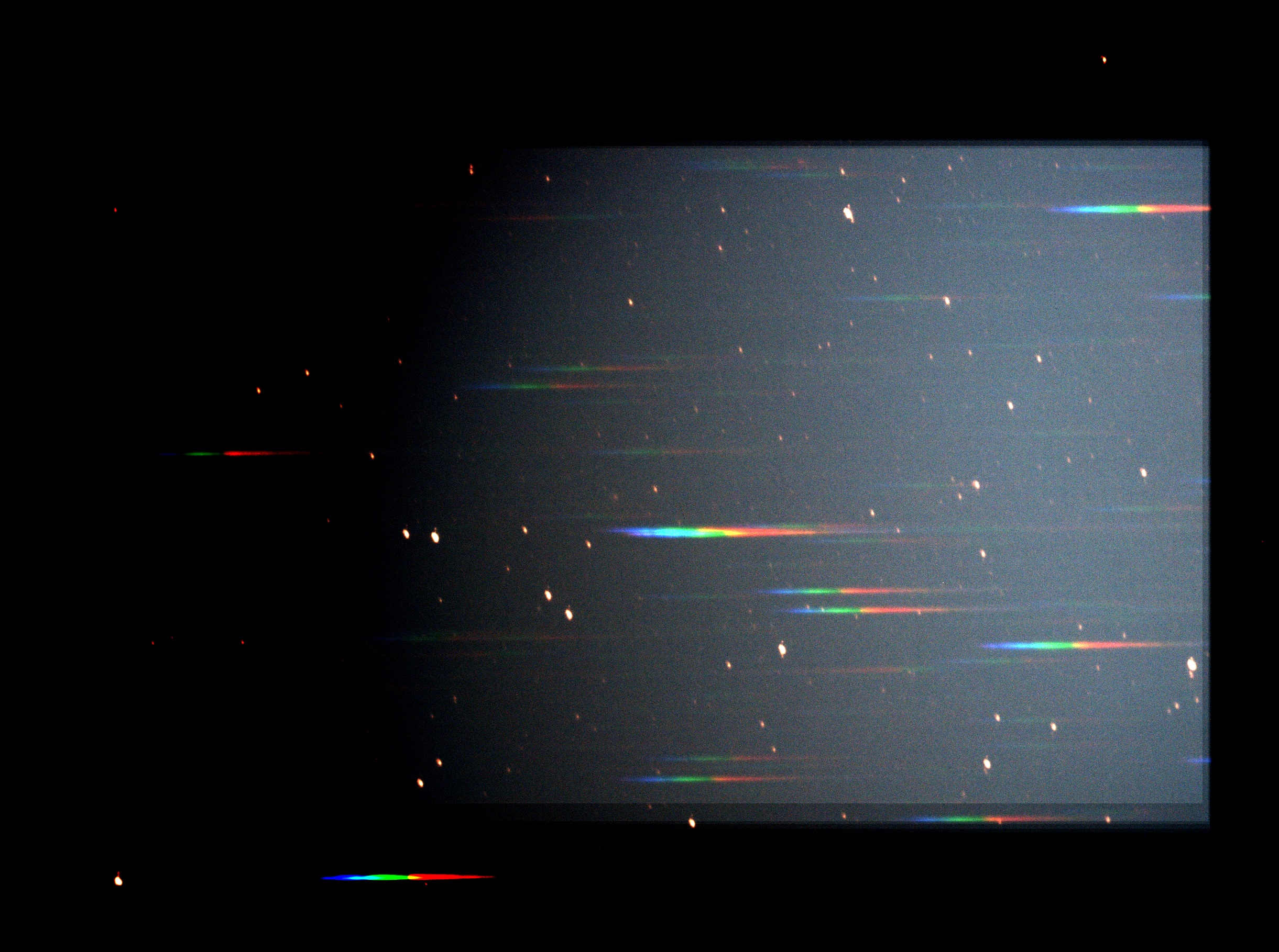

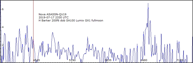

Clear again last night but full moon and the nova seems to have faded rapidly, now seems to be fainter than the adjacent mag 12.76 star GAIA 4685624430186064768.
So my S/N for last night is terrible, maybe 2-3. Anyway for what it's worth here is the stacked colour image (processed to show the spectra) and spectra taken from the binned 25x30s exposures.
The nova is right at the top of the frame. The GAIA start is immediately adjacent (below).
I wonder if Terry has managed to get another spectra?

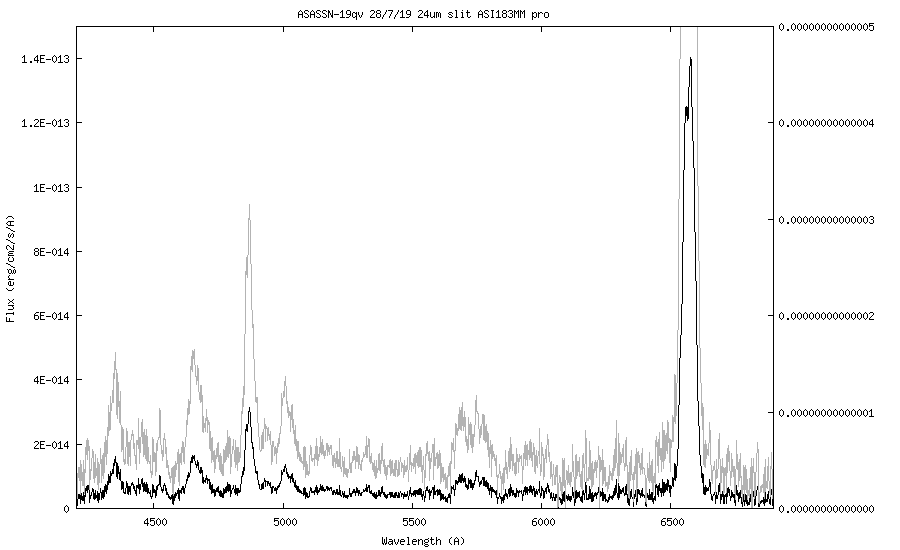

I have taken multiple spectra of this nova. It is getting pretty dim now at mag V=14.5
I don't think flux calibration would be easy with a SA200. I am using a slit spectrograph (LISA) and I can flux calibrate because I take simultaneous photometry through a V filter.

Absolute flux calibration using the Star Analyser is an interesting subject. If you have a reference star in the same field you can do the spectroscopic equivalent of differential photometry and because it is slitless you don't need to worry about loss of flux at the slit. It is not straightforward (flat fielding in particular) and a rather niche technique but it can be useful for studying fast transients.
http://www.threehillsobservatory.co.uk/ ... tra_42.htm
For the BAAVSS/AAVSO meeting last year I took the results from that run and generated B and V mag data for comparison with conventional photometry. See the attached slides extracted from the full presentation (zipped pdf)
