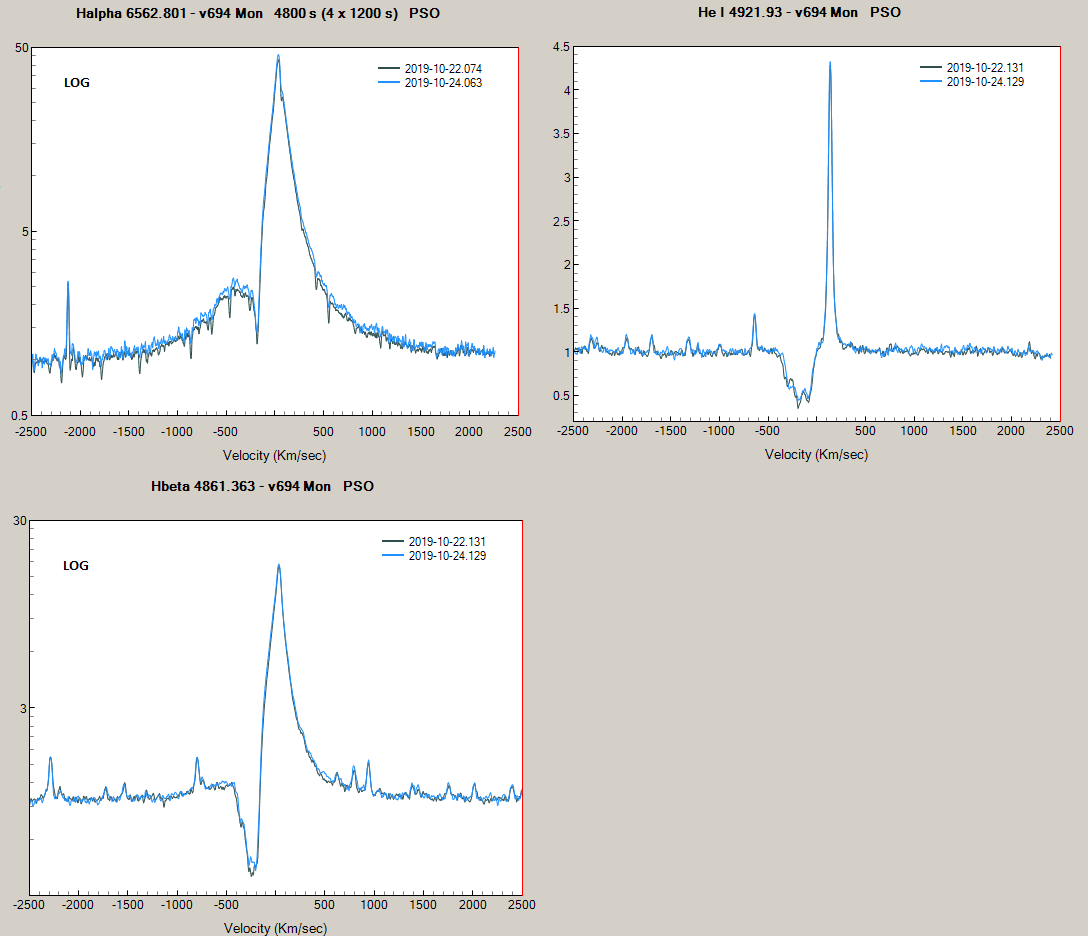

Nice coverage with the HST, Terry and Woody!
I can shoot it only in the morning skies - managed at least bracketing the critical time (2 days before - vs - today):
4 x 20 minute H-alpha, 4 x 20 minute H-beta
The He I 4922 change is visible also visually on raw spectra, it's the most obvious above noise level.
H-beta show some smaller RV changes (far above noise), and H-alpha some global EW change.
- Peter

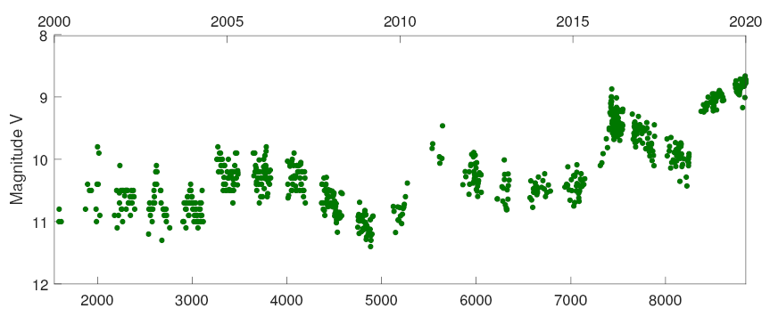

The extraordinary V694 Mon (MWC 560) is at its historical brightest luminosity. The previous record was ~ 9 during 1990 visual outburst.
Daily monitoring is recommended (very fast variation)

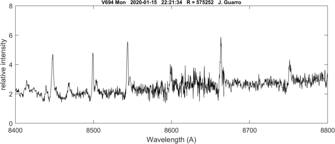

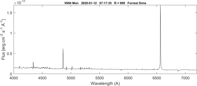

Flux calibrated spectrum obtained by Woody Sims
Echelle spectrum obtained by Joan Guarro;
_v694mon_20200115_932_J. Guarroa.png (13.68 KiB) Viewed 10241 times

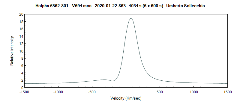

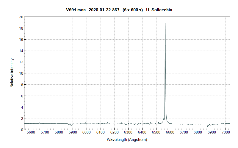

Bonsoir à tous, ma contribution sur cette symbiotique.
Vitesse radiale
v694mon_20200122_863_V.R._U. Sollecchia.png (12.94 KiB) Viewed 10123 times

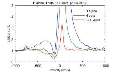

Excellent monitoring for this campaign.

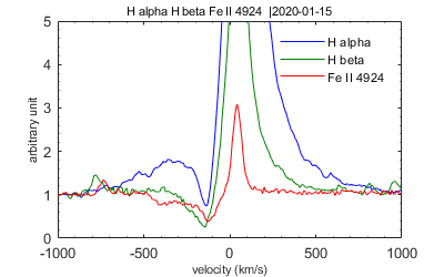

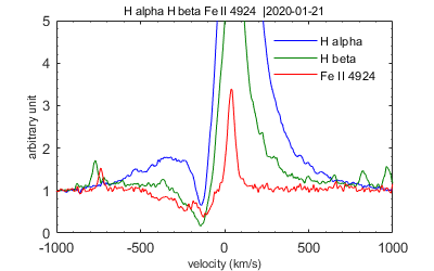

From echelle spectra obtained by Joan Guarro and François Teyssier:
asdb_v694mon_20200115_932_H alpha H beta Fe II 4924.png (15.12 KiB) Viewed 10090 times
asdb_v694mon_20200117_917_H alpha H beta Fe II 4924.png (14.91 KiB) Viewed 10090 times
asdb_v694mon_20200121_886_H alpha H beta Fe II 4924.png (15.52 KiB) Viewed 10090 times

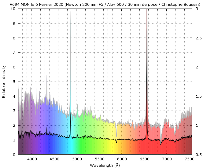

by Christophe Boussin
Here is my contribution to the monitoring of V694 Mon.
The spectrum below was obtained on February 6 at 22 h 59 TU (Alpy 600, resolution 502, JJ = 2458886.4577, 6 exposures of 300 s) :
V694 Mon on February 6th, 2020
_v694mon_20200206_958_Christophe Boussin_3700_7570.png (76.68 KiB) Viewed 9700 times

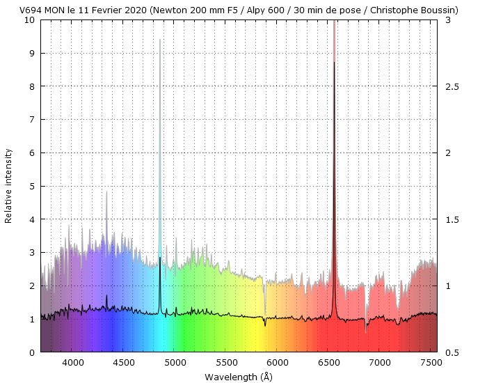

Here is my last contribution to the monitoring of V694 Mon.
The spectrum below was obtained, last night, on February 11 at 21 h 46 TU (Alpy 600, resolution 503, JJ = 2458891.4072, 6 exposures of 300 s) :
V694 Mon on February 11th, 2020
_v694mon_20200211_907_Christophe Boussin_3700_7570.png (70.25 KiB) Viewed 9643 times

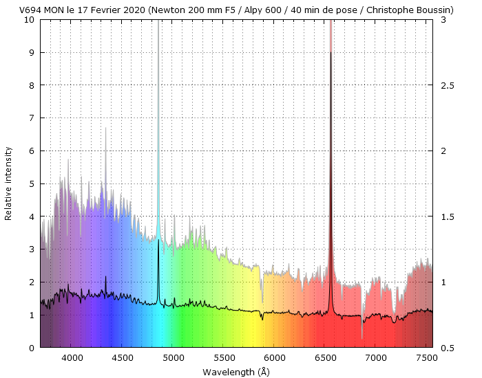

After several cloudy nights, a « window » of clear weather opened last night to resume the monitoring of V694 Mon !
The spectrum below was obtained, on February 17 at 22 h 25 TU (Alpy 600, resolution 504, JJ = 2458897.4341, 8 exposures of 300 s) :
V694 Mon on February 17th, 2020
_v694mon_20200217_934_Christophe Boussin_3700_7570.png (76.62 KiB) Viewed 9491 times
Clear skies to all !
