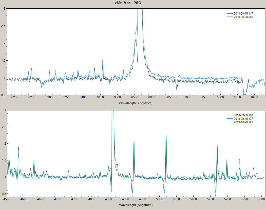

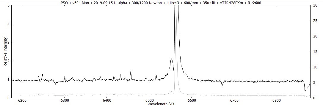

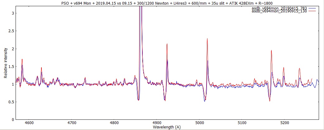

2019.10.20 morning, with LHires III + 600/mm + 35 micron slit + ATIK 428 + 300/1200 Newton (+ APM 2.67x barlow), variable sky:
- H-alpha @ R~2500
- He/Ne (~5800A) region @ R~2000=
- H-beta @ R~1800
Not much change within a month at this resolution, except H-alpha changed somewhat:
graphs produced with PlotSpectra

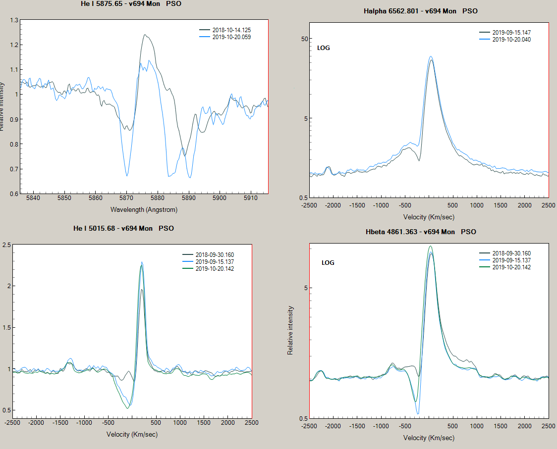

Velocity view (Balmer - logarithmic):
Beware, colors not maching across graphs! (noticed later)
All intensities are relative, no flux.

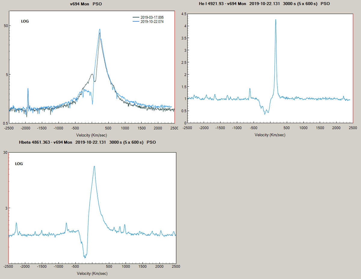

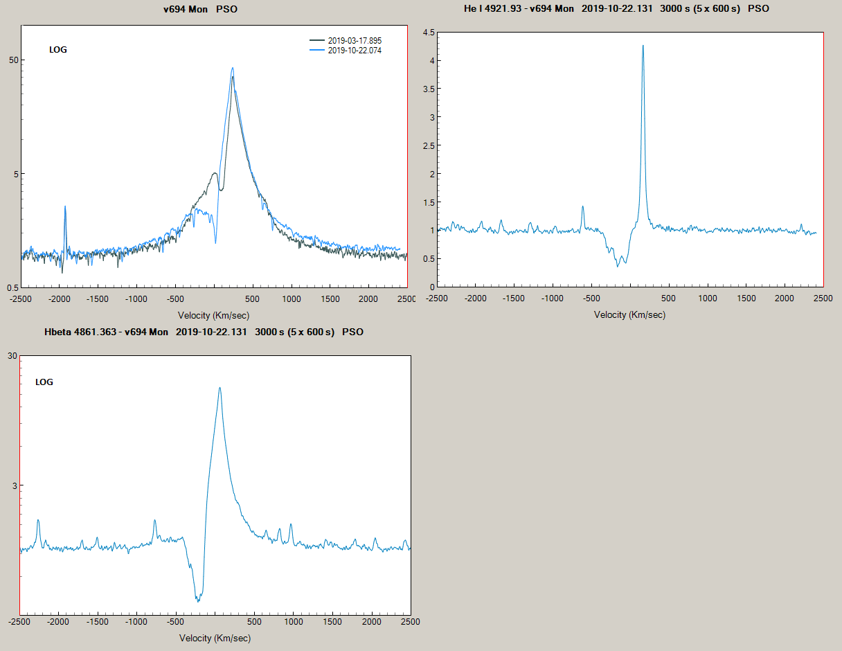

Fresh spectra from this morning, having switched to 2400/mm grating:
- 4 x 20 min. H-alpha (R ~ 15000, 6500 - 6610A)
- 5 x 10 min. H-beta (R ~ 9000, 4817 - 4961A), includes Fe I emissions + He I 4922 absorption
Velocity plot (the H-alpha is comparative to half year before):
generated via PlotSpectra + Paint (cut & paste screen capture)

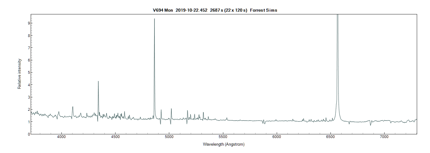

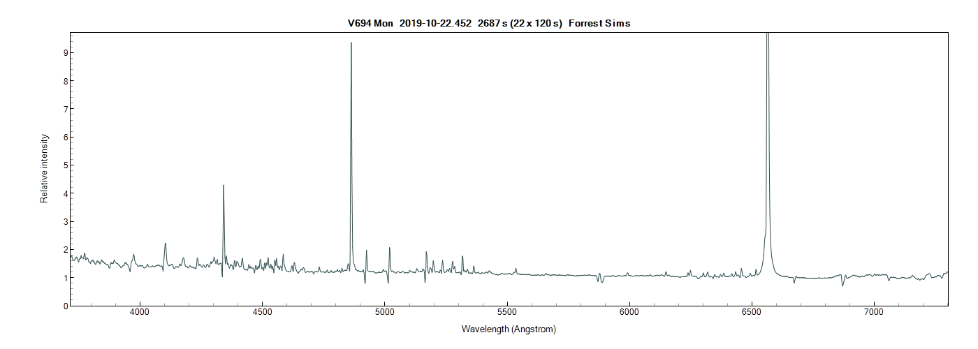

I also just acquired this fresh spectrum of V694 Mon with my LISA. This is 22 120sec exposures. I am still taking more exposures up until daylight. Also I have simultaneous VBand data for that last nearly two hours.
Woody

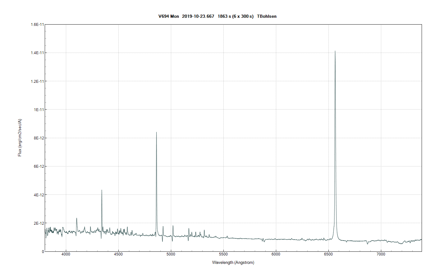

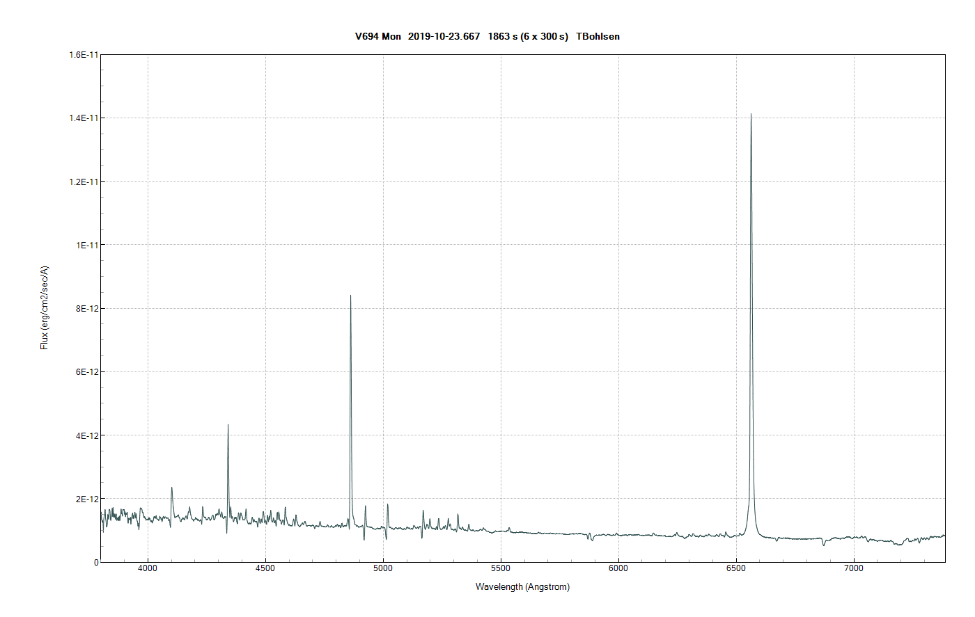

I also succeeded in taking spectra of this star last night.
Similar to Forrest's data.
Terry
