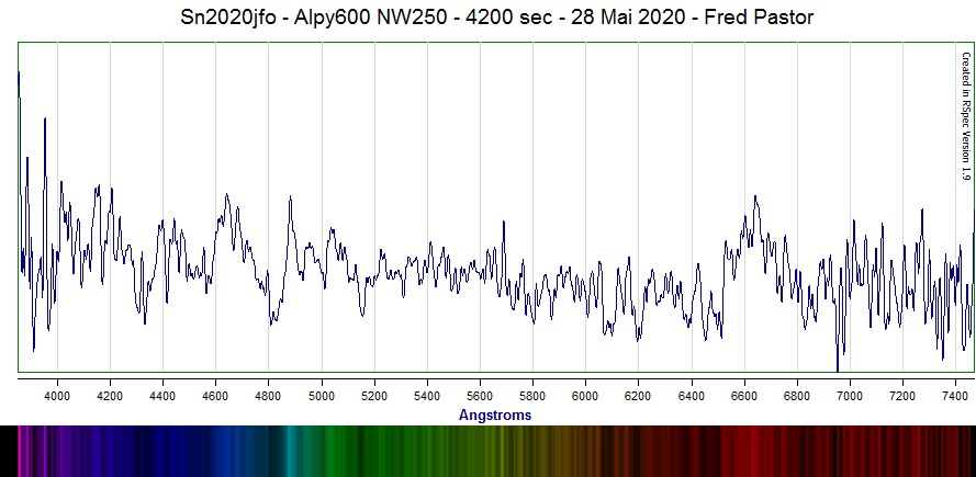

I wanted to make a spectrum of SN2020jfo, 3 weeks after its discovery. Here is below my contribution cumulating 4200 sec (only):
Sn2020jfo
Sn2020jfo
SN2020jfo publication ARAS.jpg (83.91 KiB) Viewed 5463 times

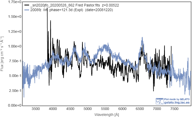

Despite noise, it fits in GELATO with the SN2008fz, type IIn:
gelato
gelato
gelatoplot (2).png (66.02 KiB) Viewed 5463 times

Peter Velez wrote:There are a couple of spurious spikes though the emission at around 6600 is genuine.
Hi Peter, They wont be from the supernovae though they could be galactic perhaps. I suggest first checking that they are not sky lines than have not been subtracted cleanly by the sky background subtraction though. The line at ~5600 in particular has that characteristic shape for this sort of problem.
The velocity of ejecta can be estimated from the absorption component of the H balmer p cygni lines (either relative the the unshifted emission component or relative to the local rest wavelength.) Note the value depends on the line measured as we see to different depths depending on the line observed and I understand the apparent slowing with time observed is mainly due to us seeing deeper into the increasingly transparent ejecta rather than an actual slowing)
