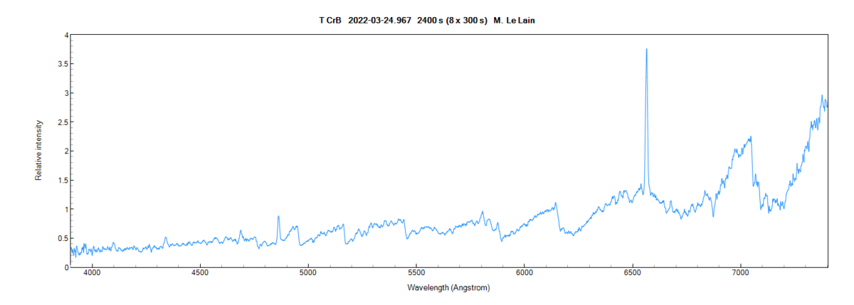

Here is a new spectrum of T CrB with an alpy on C8 (24/03/2022)
- T CrB - 24/03/2022
Matthieu

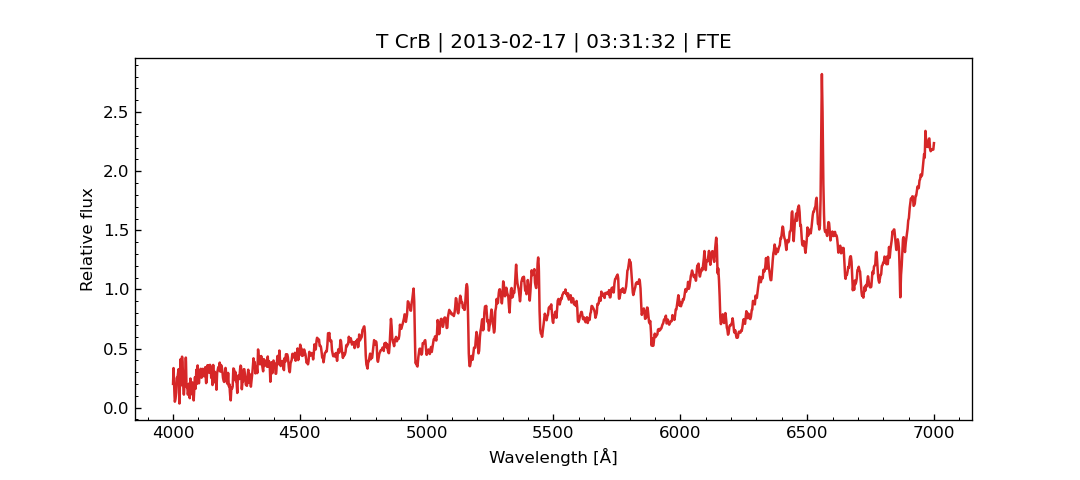

Yes, the spectrum returns to the pre-high state aspect: the continuum is dominated by the M4 III red giant. The emission lines becomes fainter (even if He II and He I are still present)
During the two last months, the EW grew a little bit according to orbital phase. But the global trend is decline.
First low res spectrum in the database, more than 10 years ago.
- asdb_tcrb_20130217_146.png (52.02 KiB) Viewed 19066 times
Guillaume's comparison shows the decline observed during the last months.
But a word a caution: the flux and profiles of the lines are strongly dependent of the orbital phase. Thus the most accurate comparison should use spectra acquired at the same orbital phase
This is a key point of the symbiotic stars monitoring: long term and high cadency observations can produce very valuable results
