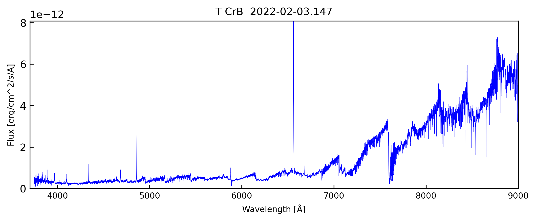

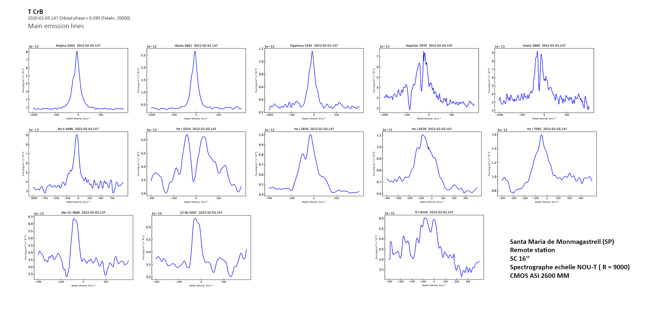

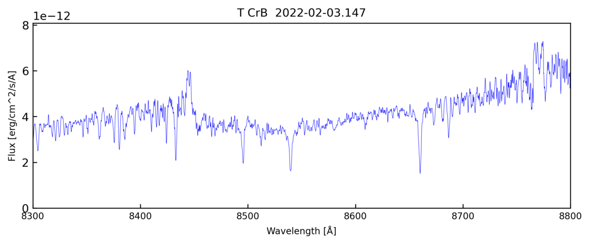

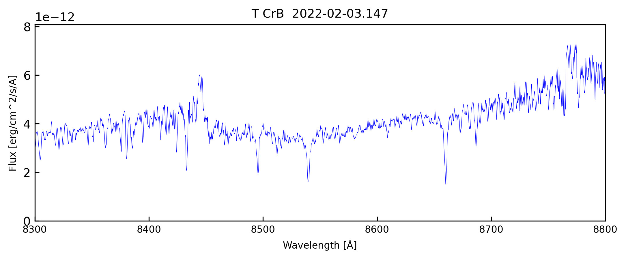

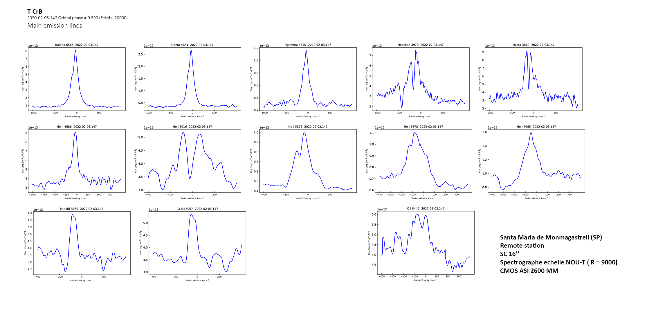

An echelle spectrum secured at SMM-SP remote station now equiped with an ASI2600 MM.
The NOU-T spectrograph produces a very large wavelength range, from 3750 to 9500 A
The spectrum shows both [Ne III] in the near UV and OI 8448 in the near IR, important diagnostic lines for symbiotics systems.
a crop on OI (in emission) and Ca II triplet (absorption)
Main emission lines profiles:
with Balmer series from H alpha to H zeta
Note the similar profiles of [Ne III] and [O III] (possibly formed in a bipolar ejection)
The spectrum is calibrated in flux using a CR photometry.

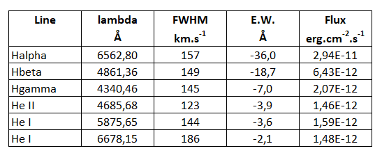

Some measures:
Spectrum in the database:https://aras-database.github.io/database/tcrb.html
Of course, from now, high cadency acqusiton is highly recommanded in order to dectect variations of the activity before the next nova outburst.
Thanks a lot to Joan
(and Tim for the optical concept)

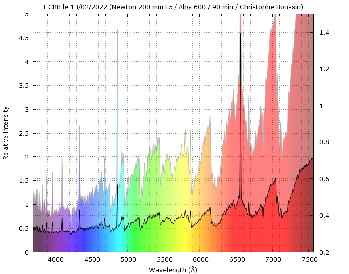

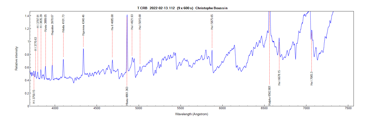

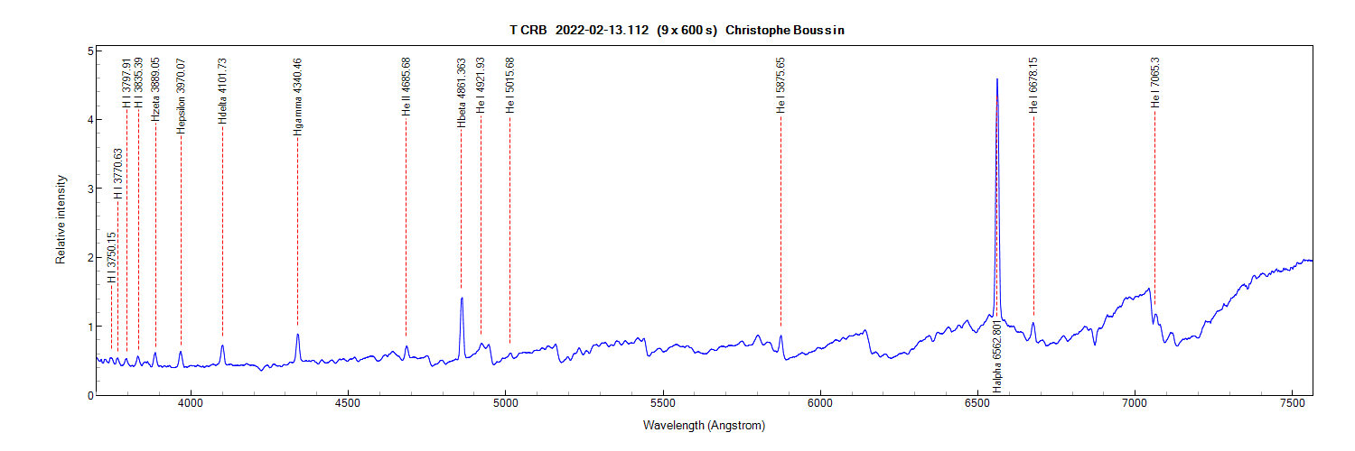

Here is my contribution to the monitoring of T CrB.
I obtained the following spectrum of T CrB with a spectral range from 3700 to 7565 A the 13th of February at 2 h 41 TU with my Alpy 600 (resolution of 527, JJ = 2459623.6115) and an acquisition time of 90 min (9 x 600 s) :
T CrB on February 13th, 2022 (3700-7565 A)
_tcrb_20220213_112_Christophe Boussin_3700_7565.png (94.3 KiB) Viewed 79711 times
Identification of some lines (from PlotSpectra) :
T CrB on February 13th, 2022 (3700-7565 A) (zoom)

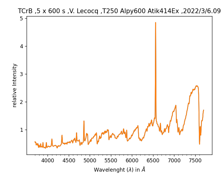

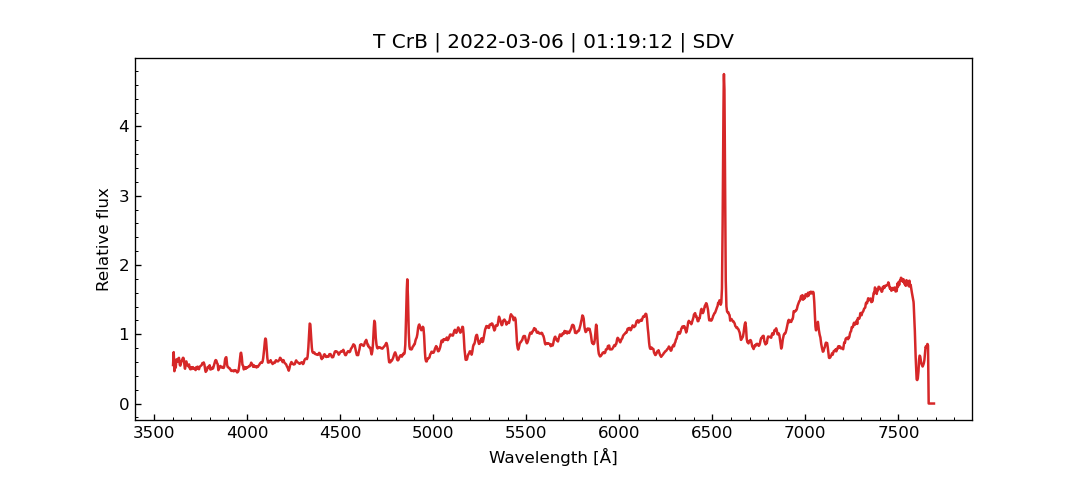

hello,
here is a new low resolution spectrum of T CrB taken 06/03 morning, with Alpy600 on T250 newtonian telescop,
kind regards,
vincent

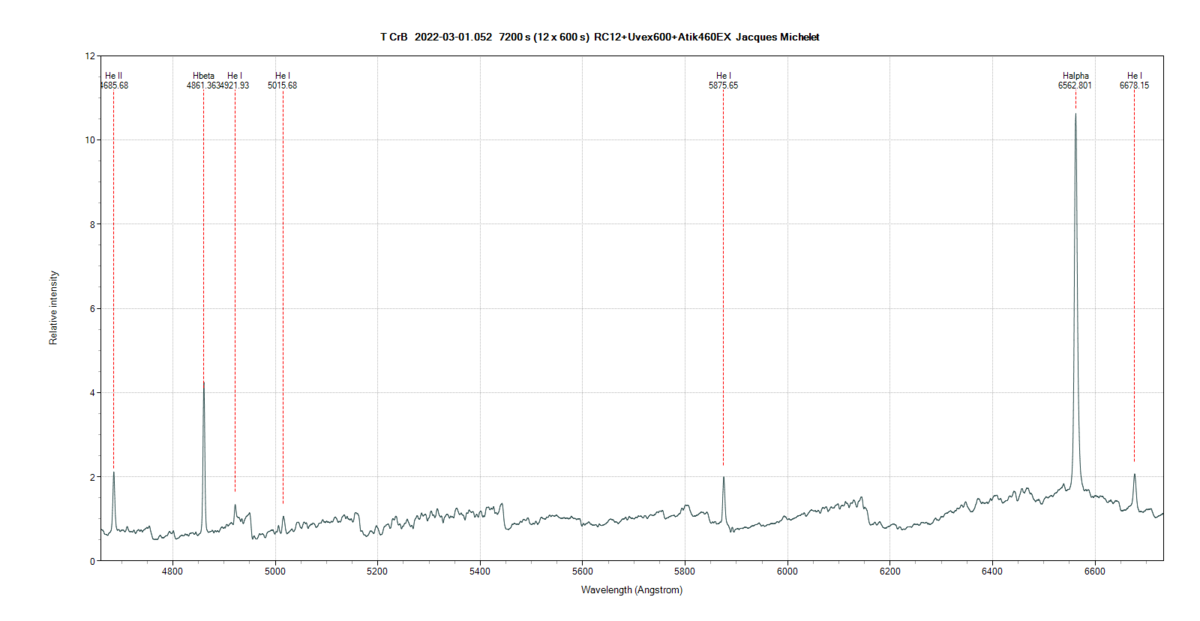

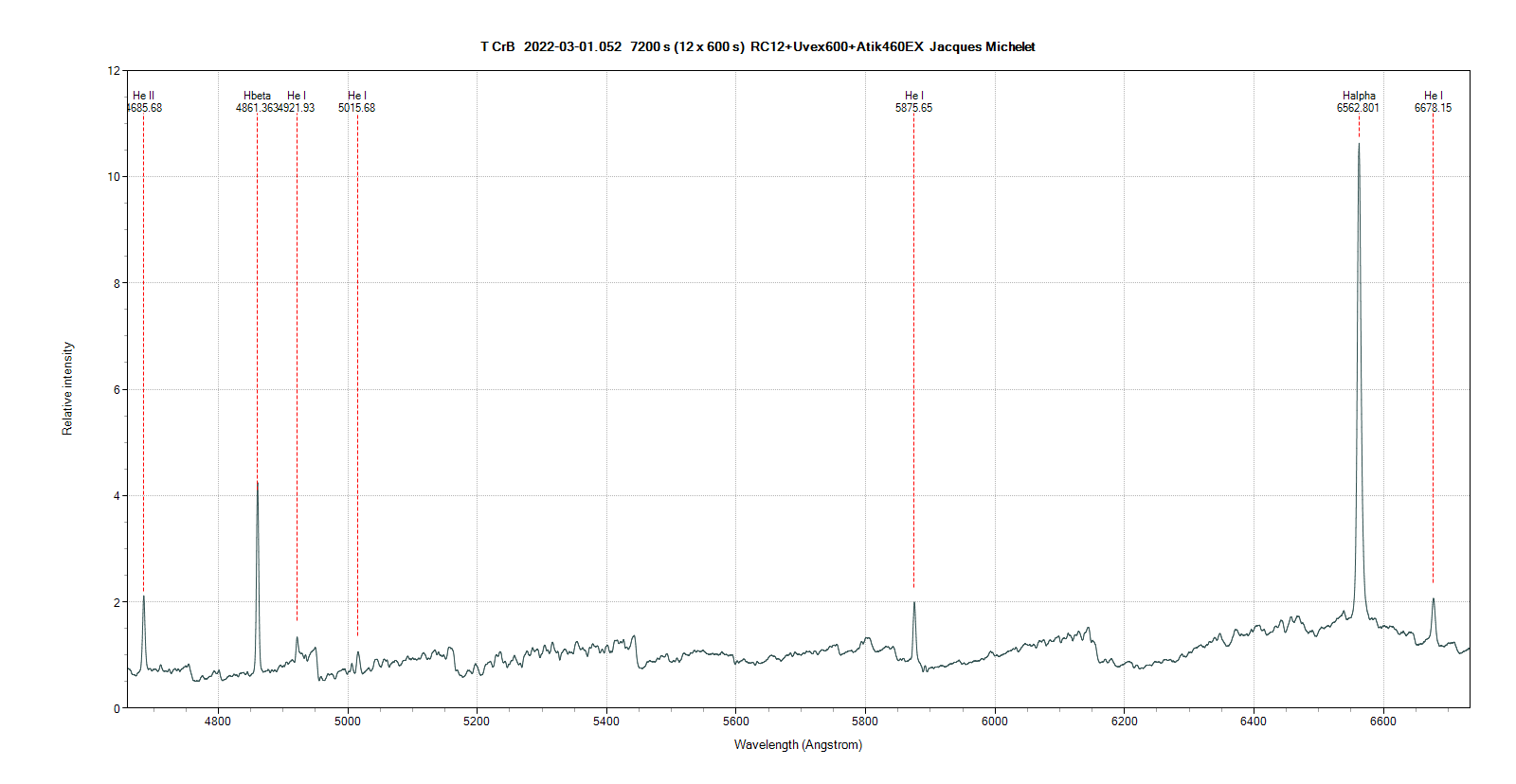

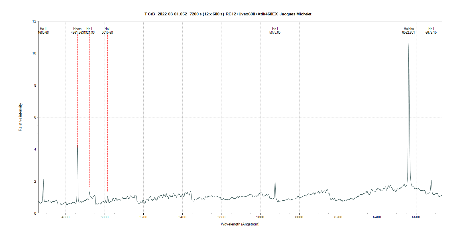

A spectrum captured on the 1st of March with an Uvex-600.
T CrB
T CrB
Clear skies,
Jacques
