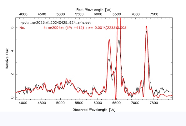

How bright did it get at maximum? I am still able to follow SN 2023ixf into the nebular phase almost a year old now with the ALPY200 currently at mag 17.5
Here is the latest fit using SNID

I think just a little brighter than 12th magnitude at peak in V.
Fantastic to be able to follow ixf all the way to the nebular phase. We'll have to see how far we can get with this one.
