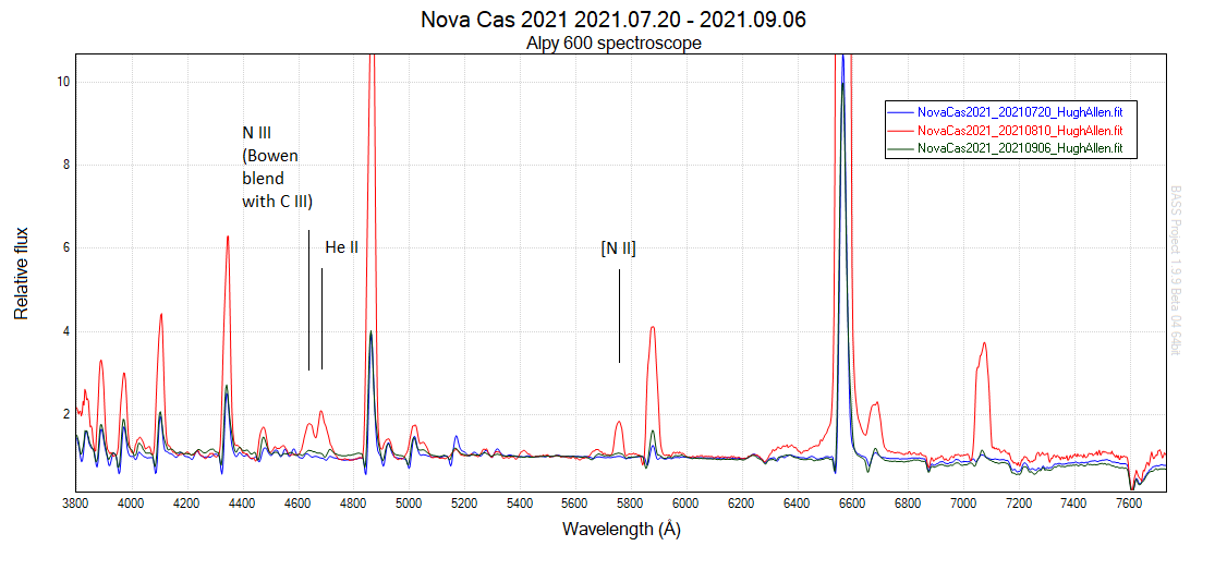

Thanks Etienne for a very interesting link to ATel 15093. From the series of spectra that I have been capturing with my Alpy spectroscope I could see that the pair of emission lines, NIII 4638Å (Bowen blend with CIII) and He II 4686Å, made a first appearance in early August coincident with the nova fading to around mag 8.5, before disappearing as the nova re-brightened. The nebula line [N II] 5755Å also made a brief appearance:
The spectrum of this beautiful nova has been oscillating as much as its brightness!
Hugh

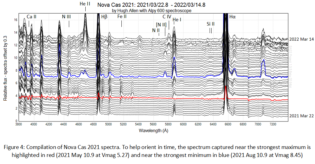

Posted: Sat Jun 04, 2022 9:08 am
by HughAllen
I recently brought together the 46 spectra that I captured 2021 March 22 - 2022 March 22 to paint a spectroscopic portrait of Nova Cas 2021. The results are described in a short paper in the Variable Star Section Circular no.192 just published by the British Astronomical Association, which can be downloaded as a pdf at https://britastro.org/vss/VSSC192.pdf
Here is a superposition of the spectra that is one of the figures from the paper:
Figure 4 Compilation of Nova Cas 2021 spectra.png (337.68 KiB) Viewed 22543 times
This nova has been a hugely enjoyable spectroscopic project
Hugh

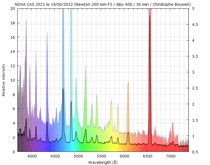

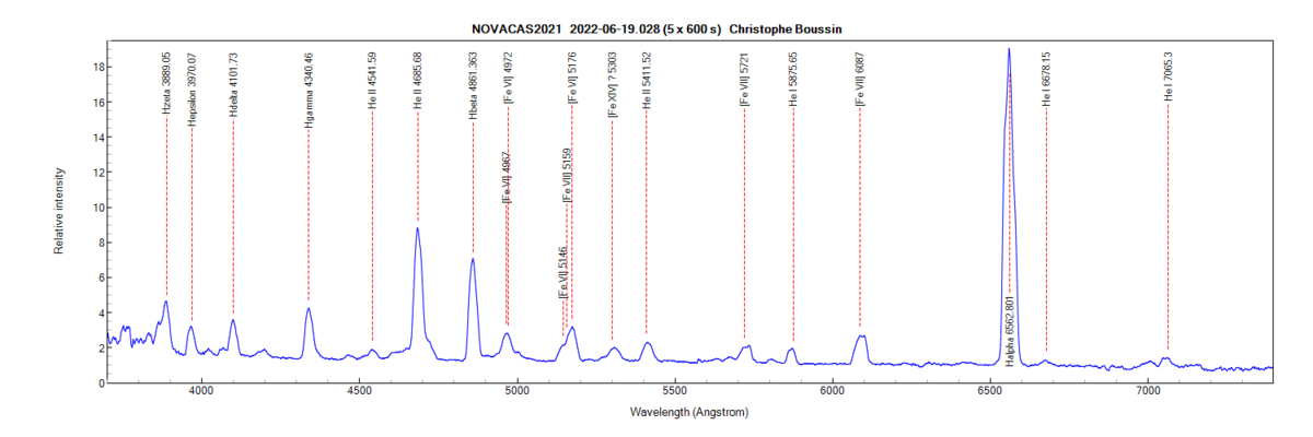

I'm back with a new spectrum of the Nova Cas 2021 obtained the 19th of June at 0 h 40 TU (resolution of 542, JJ = 2459749.528) with my Alpy 600 and an acquisition time of 50 min (5 x 600s) :
Nova Cas 2021 on June 19th, 2022
_novacas2021_20220619_028_Christophe Boussin_3700_7396.png (95.42 KiB) Viewed 22243 times
Nova Cas 2021 on June 19th, 2022 (probable identification of some lines from PlotSpectra)
As you indicate in your paper, I also wonder if the line at 5303 A is indeed that of [Fe XIV] ?

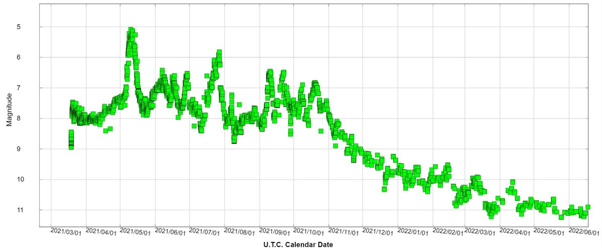

(Johnson V : green squares)
Light curve of the Nova CAS 2021 (AAVSO)
According to the AAVSO website, the magnitude of the Nova is now close to 11 !!
Clear skies to all !!

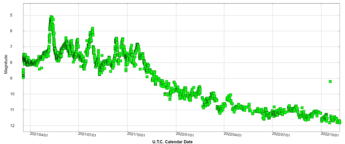

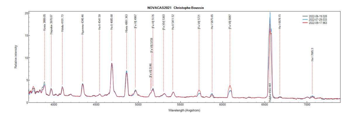

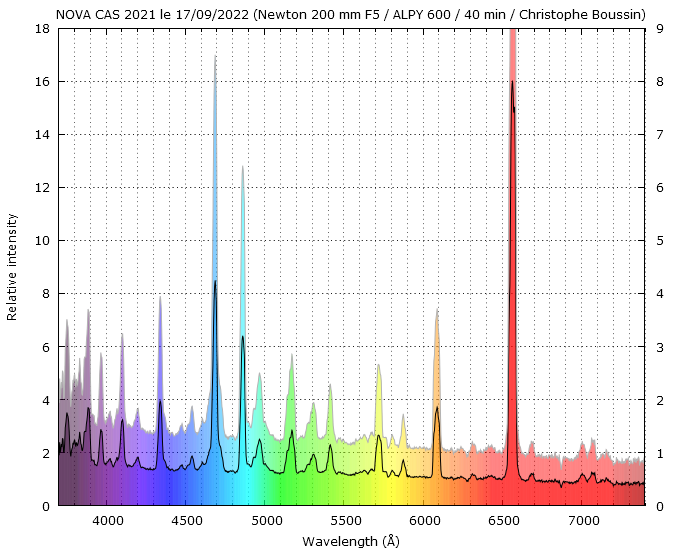

With delay, here is a new spectrum of the Nova Cas 2021 obtained the 17th of September at 23 h 07 TU (resolution of 529, JJ = 2459840.4633) with my Alpy 600 and an acquisition time of 40 min (4 x 600s) :
Nova Cas 2021 on September 17th, 2022
_novacas2021_20220917_963_Christophe Boussin_3700_7396.png (74.91 KiB) Viewed 20988 times
Nova Cas 2021 on September 17th, July 29th and June 19th, 2022 (identification of some lines from PlotSpectra)
I note a very clear evolution of the [Fe VII] lines at 5721 and 6087 A !
According to the AAVSO website, the magnitude of the Nova is still below 12 : it's still an easy target but unfortunately for me, the weather looks like a parade of clouds !!
Will anyone have better luck?
